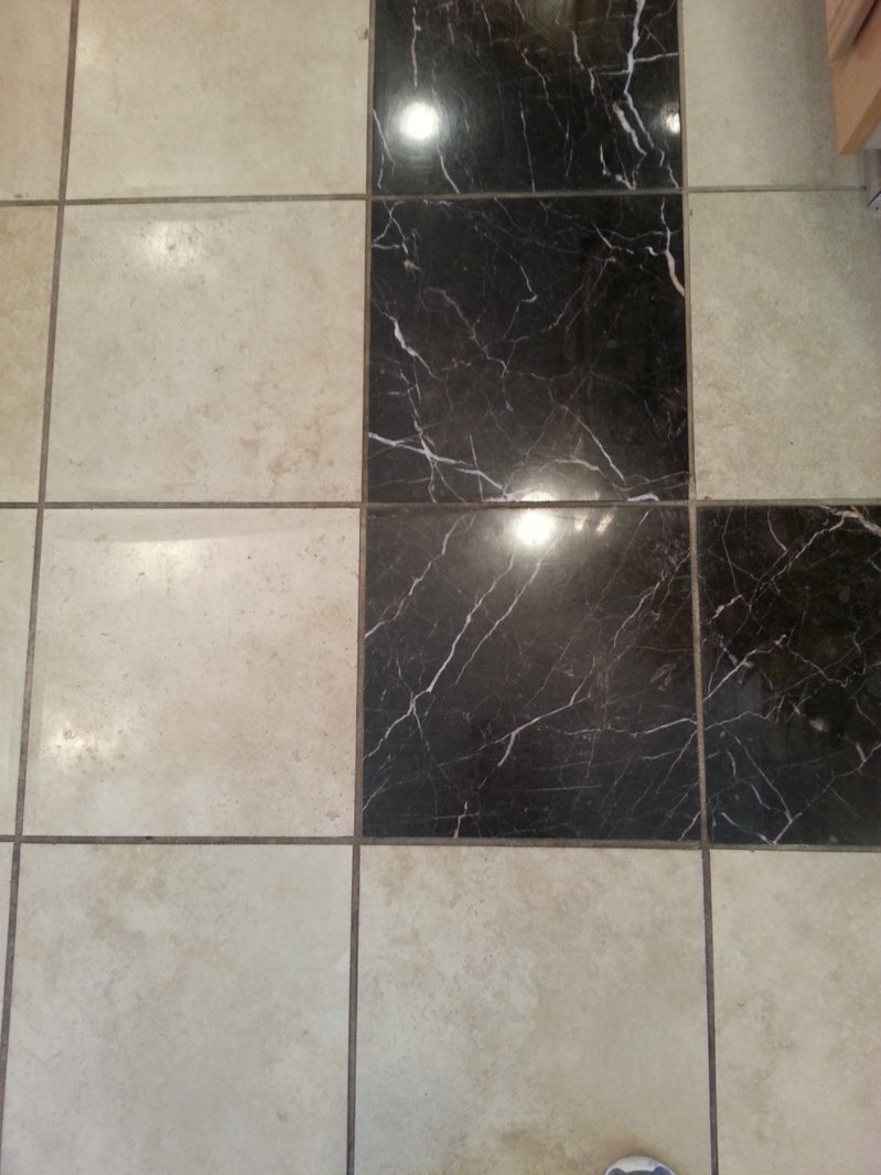

Todd Millar
Hey Mikey would you use regular tile cleaner and a spinner on this marble tile?
50,005
Procyon, Power Max, Flex w/citrus, whatever is mixed up already.
Don't stress over it.

T
Todd Millar
Thanks, I have Procyon, I will use that and take an after pic and post it here so you guys can see how it cleaned up!!
