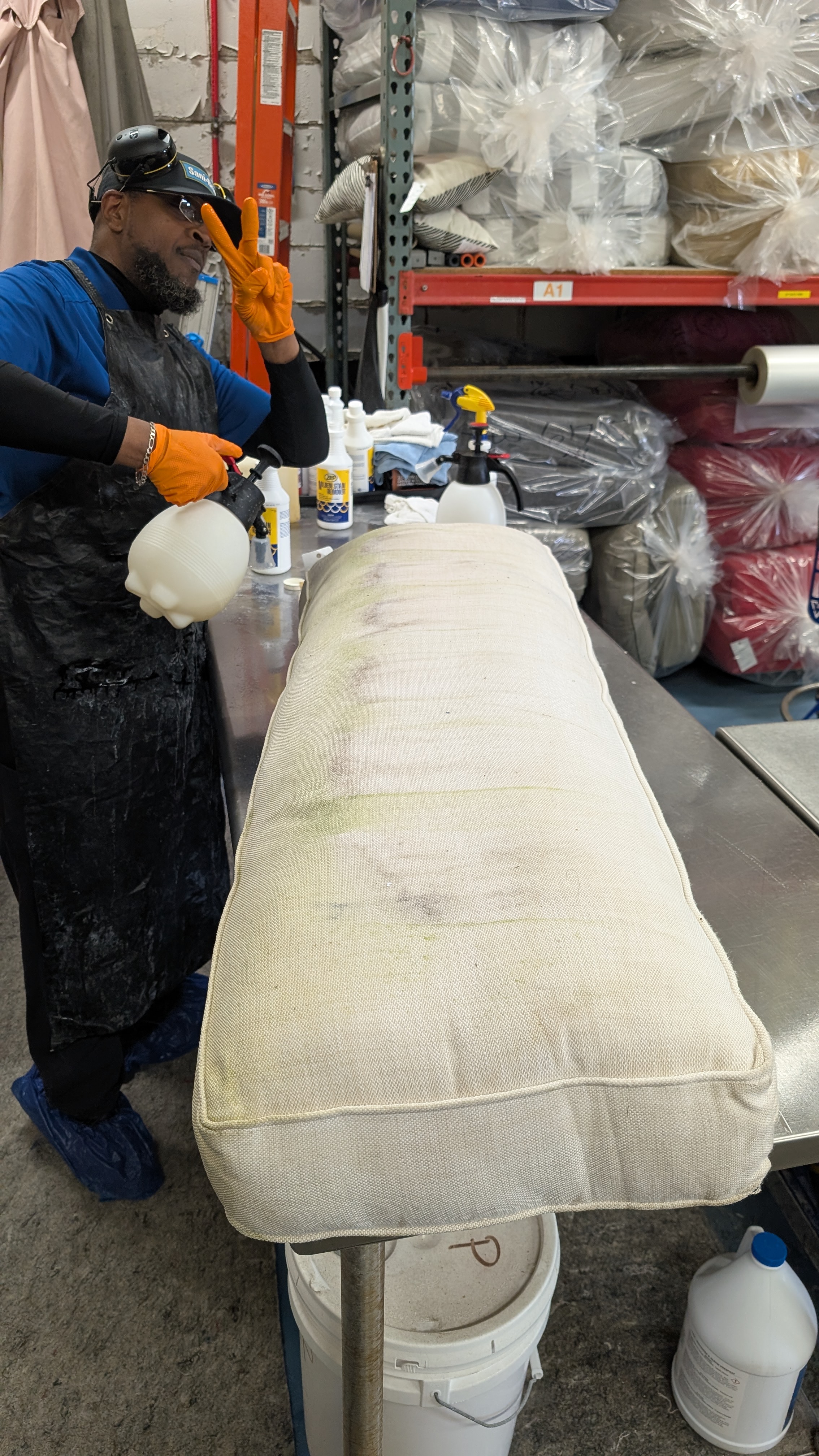

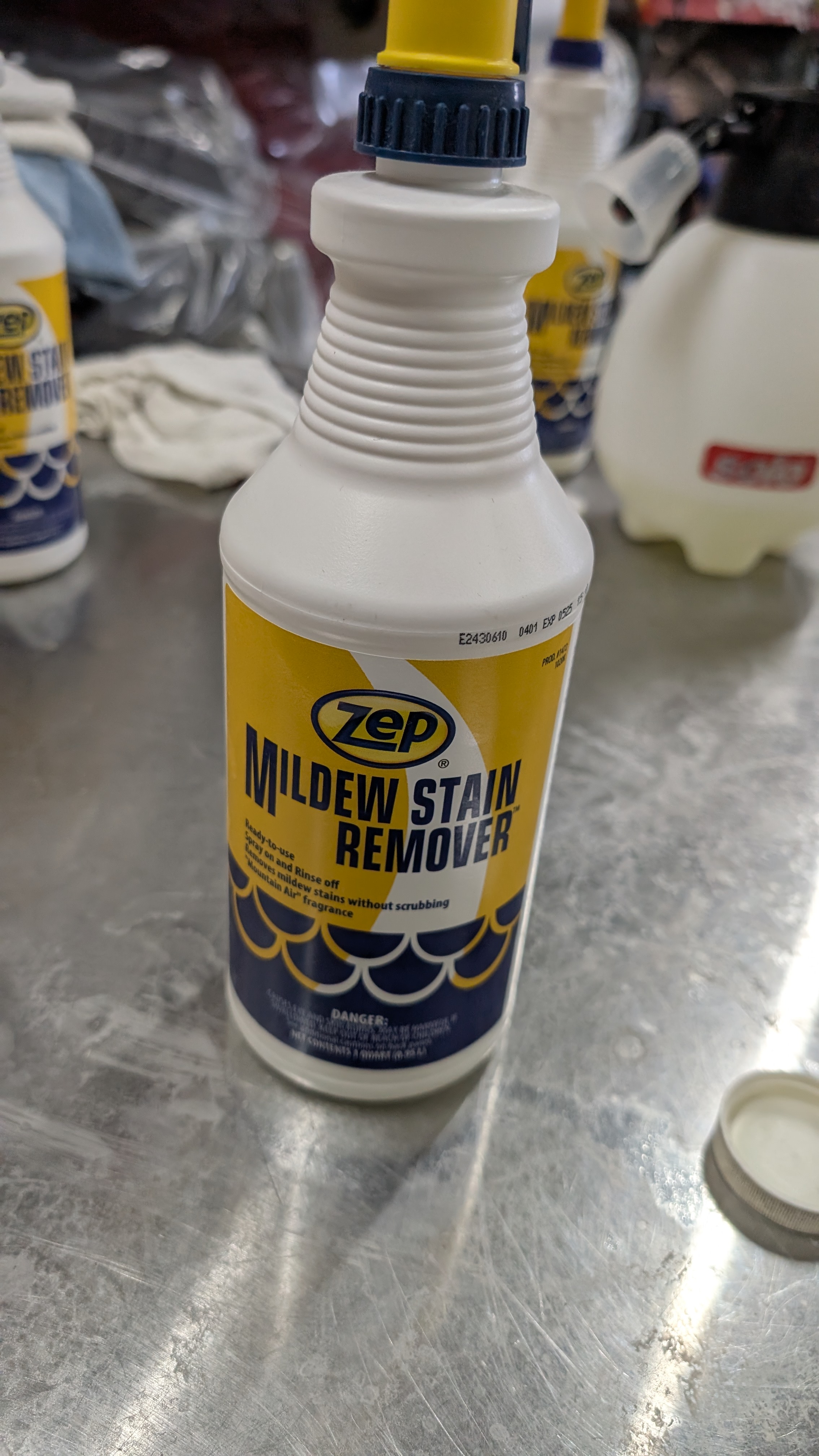

Zep mildew stain remover. Miracle in a can
116,994
Pre vacuum
Pre rinse
Apply enzyme cleaner
Rinse
Apply Zep
scrub
Dwell
Rinse
Repeat Zep if needed
Rinse
Dry

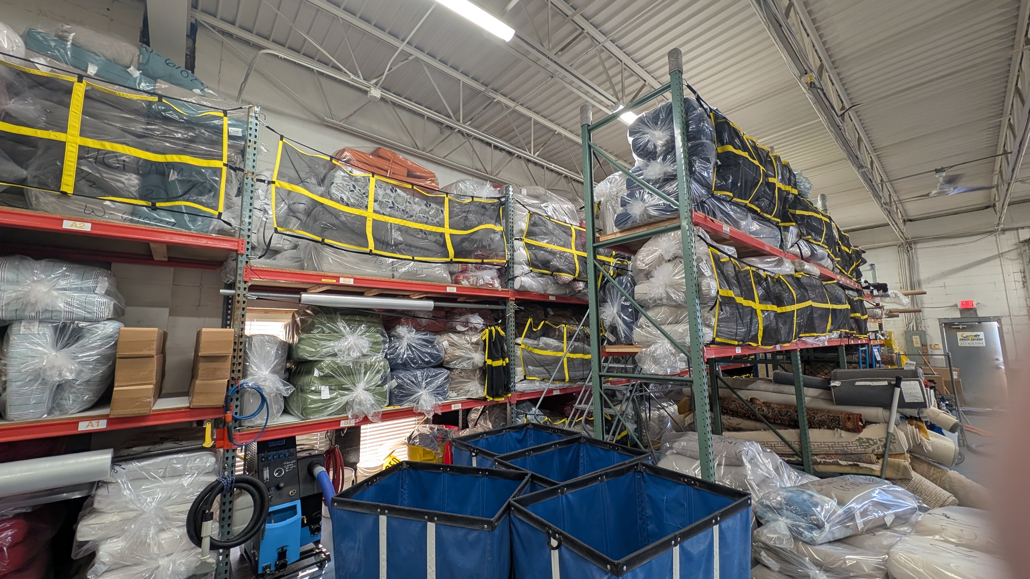

Joe’s shop was FULL of patio cushions (stuffed to the rafters, in every corner), he was doing a clean n winter storage system???

And is that Zep a chlorine or peroxide based mildew chemical?
