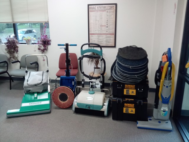

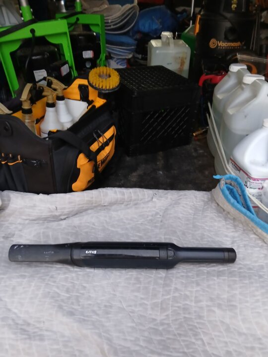

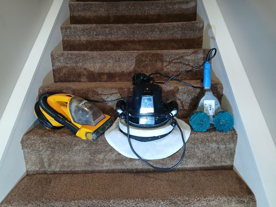

I always have 3 vacuums on my Van for Residential and a Handheld for stairs and a Handheld for crevices when using Kirby. Shark Kirby 12'' Pro Team Eureka Handheld Shark Handheld. Last week my Kirby belt broke. No problem I have 2 backups. That Shark Handheld is a handy tool to have. Fits in my spotter bag and has good suction for a little vacuum
Usually 2 for Commercial a 20'' Linhaus and 15'' Pro Team
And when needed I bring Big Green. A 28'' Bissell Big Area Vacuum. I love Big Green for long Hallways Conference Rooms big Offices

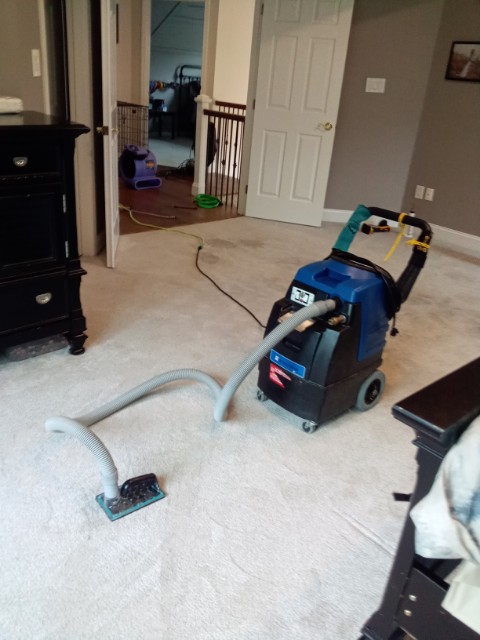

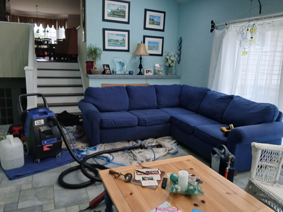

I should mention I do have a portable for flushing out urine stains/spots with a Water Claw. I charge extra that and some furniture with loose fitting fabrics are very hard to clean using the VLM Method

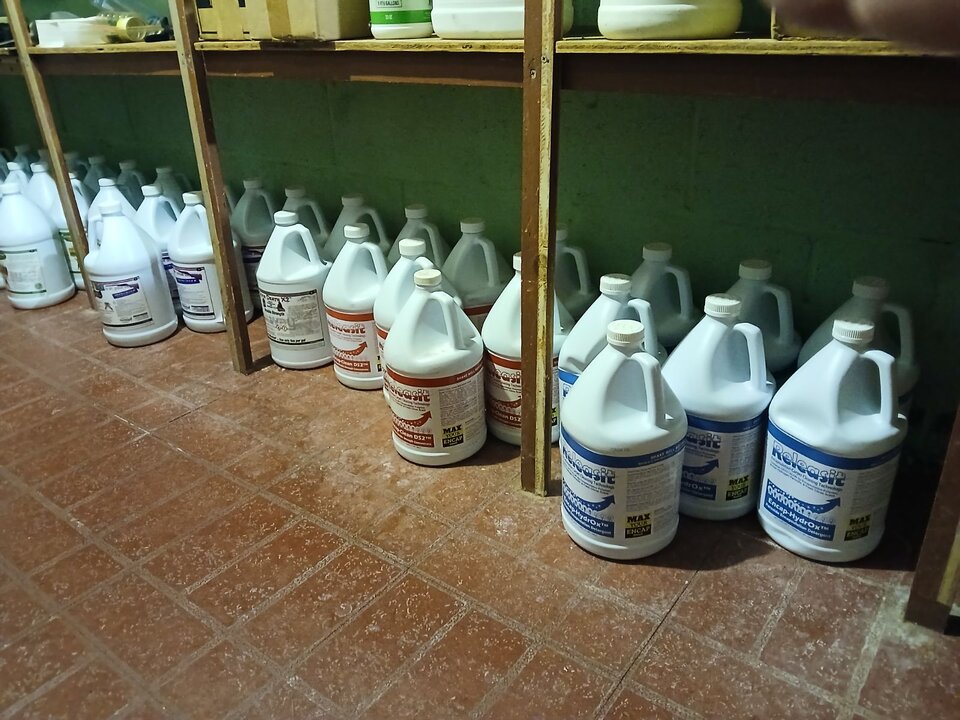

VacAway Commercial Magic, Double Trouble, Formula 357, are outstanding encaps with 9.5-12.0 ph and adding boosters like Detonator (Peroxide) or Odor Death x2 (clo2) makes them even better. Steve Smith found the secret to cleaning cheap polyester carpet usually found in rentals. Nothing out cleans VacAway when it comes to Polyester. NOTHING !!!
Thank You VacAway !!!
Yes I agree it's best to have VLM and HWE. I had that for 7 years. And yes it does feel good seeing that steam come from the sides of your wand and that big machine blasting away outside but I had that for 25 years and now I like and prefer a simpler quieter method called VLM. I like seeing the dirty cotton bonnets in my washing machine and all that dirty water
That's Beautiful !!!
