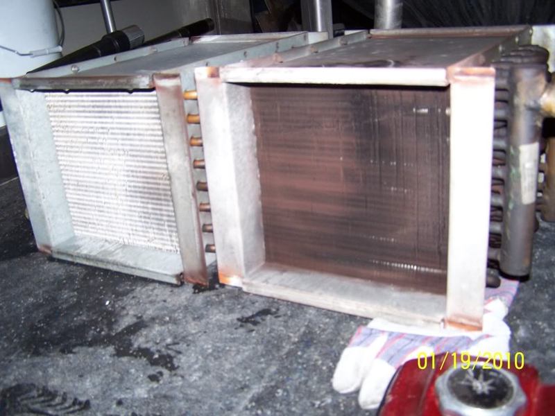

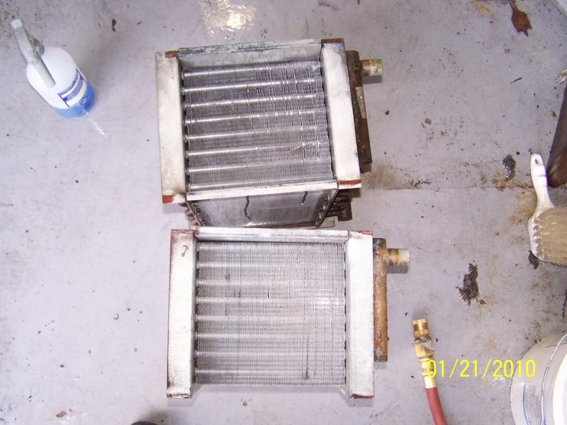

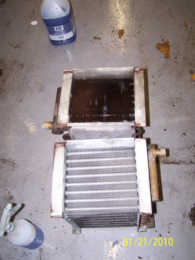

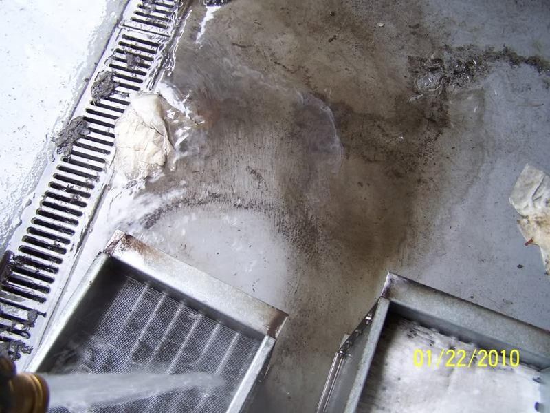

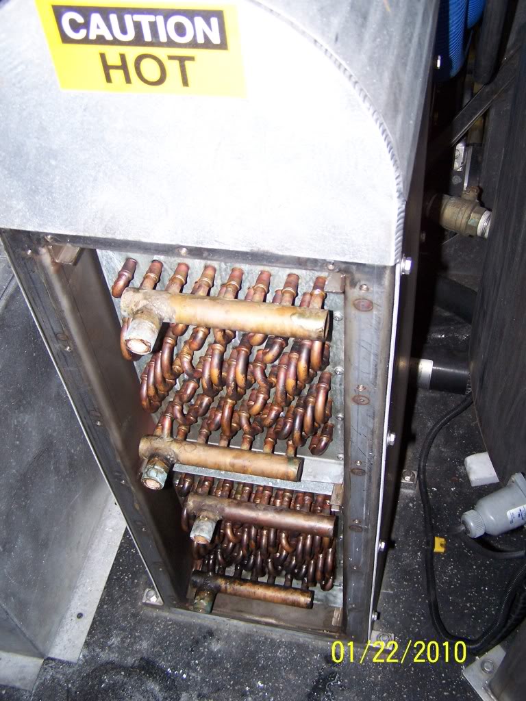

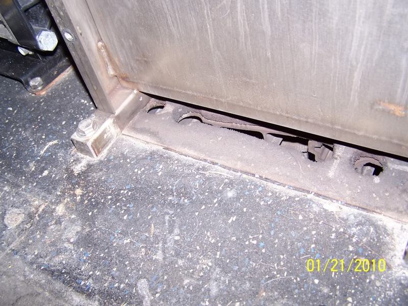

I have been trying to figure out why I was having problems with the Vortex's not creating the heat they should in cold weather, while also creating a situation where I was having problems with the blower bearings from excess heat. Well I found it!!!!! The blower heat exchangers where clogged!!!!!!!!!. There is nothing in the manual about any maintenance that should be performed. I would suggest that anyone who has this type of unit go to your local HVAC store and buy coil cleaner. Take the exchanger apart give it a good cleaning and then do it on a 6 month schedule. On the 7000H, check the outlets on the blower heat exchange and open them up so it can relieve the back pressure on the blower. A rebuild on these blowers start at $2500.00 and if you have to replace it will cost you about $11,000.00. This is a serious screw up that has cost a lot of time and money to find.

Most blower heat exchanger equipped truckmounts have a checkout interval on the blower HX units.
We recommend our customers have them checked out once per year. Since then, none of our owners have experienced a problem who have them inspected and follow the regimen. Unless you plug them up by letting them go too long, they are relatively easy to clean up.
We also tell customers to take it easy on the use of a spray blower lubricant, as it tends to attract a lot of dust and accelerate the process of a potential blocked exchanger. 5 seconds of spray is all it takes, and all you should use.

Still there should be a slide out filter. Removing 18 screws and related hose clamps to get into the monstrosity "to inspect it" is goofy. We made a few other simple changes and eliminated the blower exchangers on all three 405's and still have better heat.

Scaling to the bottles in the picture it looks like a 10 x 12" filter would do the trick. I could do it in an hour. It would take another hour for everyone to explain why it couldn't be done.

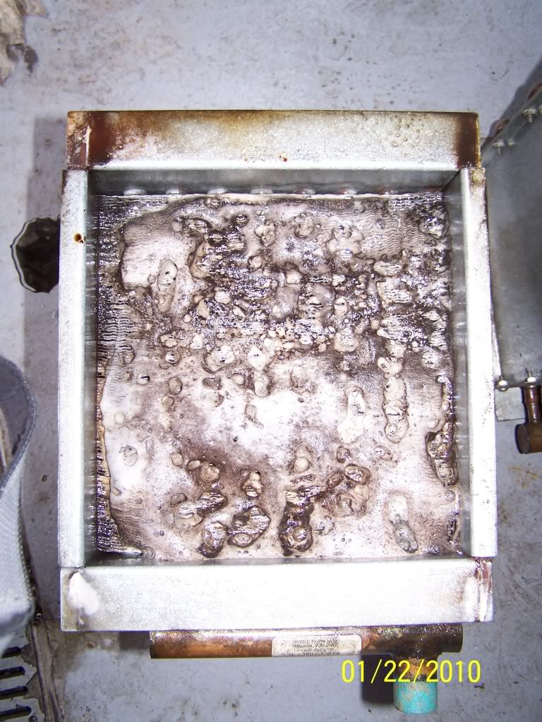

Jim, I think that there is enough airflow through the blower that the fine dirt that gets past the filter box gets pulled threw the filters in the top of the tank. The dirt goes threw the blower and silencer and gets trapped on the fins on the heat exchange. You have to remember that the airstream is very humid because of the temperature and amount of water we are reclaiming.

how tight is the box sealed that goes around the HX..........??
