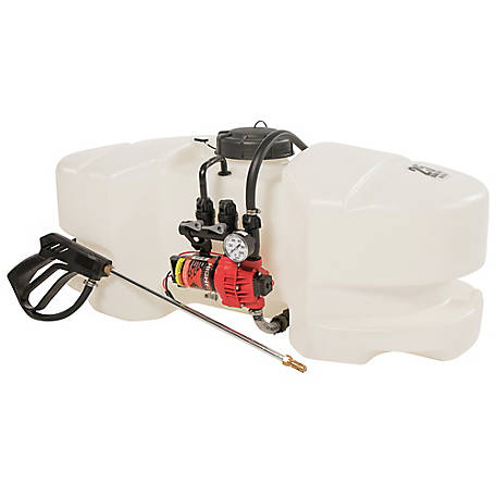

I’m liking the Field King electric sprayer I just picked up. Time will tell how it holds up, but one for pre spray, one for Odorcide, and one for protector would probably be the easiest way to go.
I’d hate to deal with an extra line. Vac, solution, and water is enough for me.

Seems like a lot of hassle just to end up with cold pre-spray.
Trying to improve my service and quit wasting chemicals and spraying too much water trying to make up for the inaccurate dilution that the hydroforce is doing
if you want consistency 100% of the time, with 100% of chems at the temp range the juice is formulated for (and who wouldn't?) forget about syphon feed systems hooked to TMs and go electric sprayer.
it's just that simple Woody
