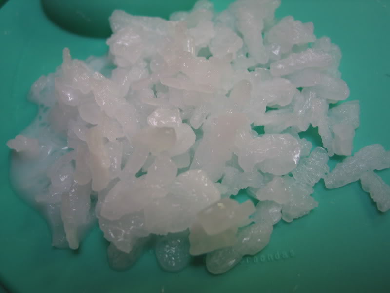

We have been using the O2 system for a while now and are quite happy with it.
However, I have noticed lately that once we have used the last of a gallon of O2, we set the jug aside and have been finding a handful of crystals at the bottom of the jug.
I do not think that any of this last batch got frozen while being shipped here but cannot be sure.
What is this stuff and should we be trying to dissolve it in some hot water or what ?
Here is a picture.

Shake the bottle before use. I'd guess its the sodium borate in the O2.

Shake the jug with enthusiasm every time before you mix. When I empty the jug I refill it halfway with hot water and shake again to get every last precious drop of the juice dissolved.

Tony,
The crystallization in the bottom of the O2 jugs is salt crystals forming. This does not take away from the cleaning ability of the O2 System. I can cut the formula about 15% to stop this, but I am unwilling to do this, so to keep my formula at maximum strength, this is a byproduct. Having crystals formed in the bottom of a chemical jug is a good indication that you are receiving a maximum strength chemical. There is no need to try and dissolve the crystals. The excess salt crystals in the O2 System is from the high concentration of sodium borate. I just went back and looked at one of my previous posts with some information about sodium borate, and I am going to repost it here.
