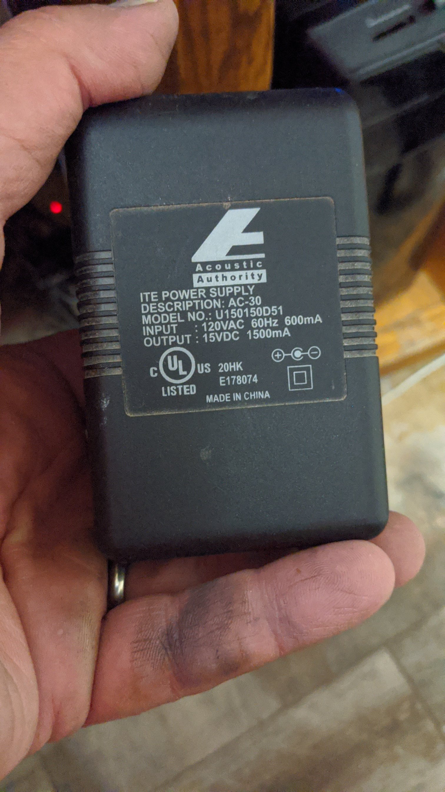

You got me feeling ALL my gadget's plugs..
This one to my PC's sound system is warmer than I'd expect..

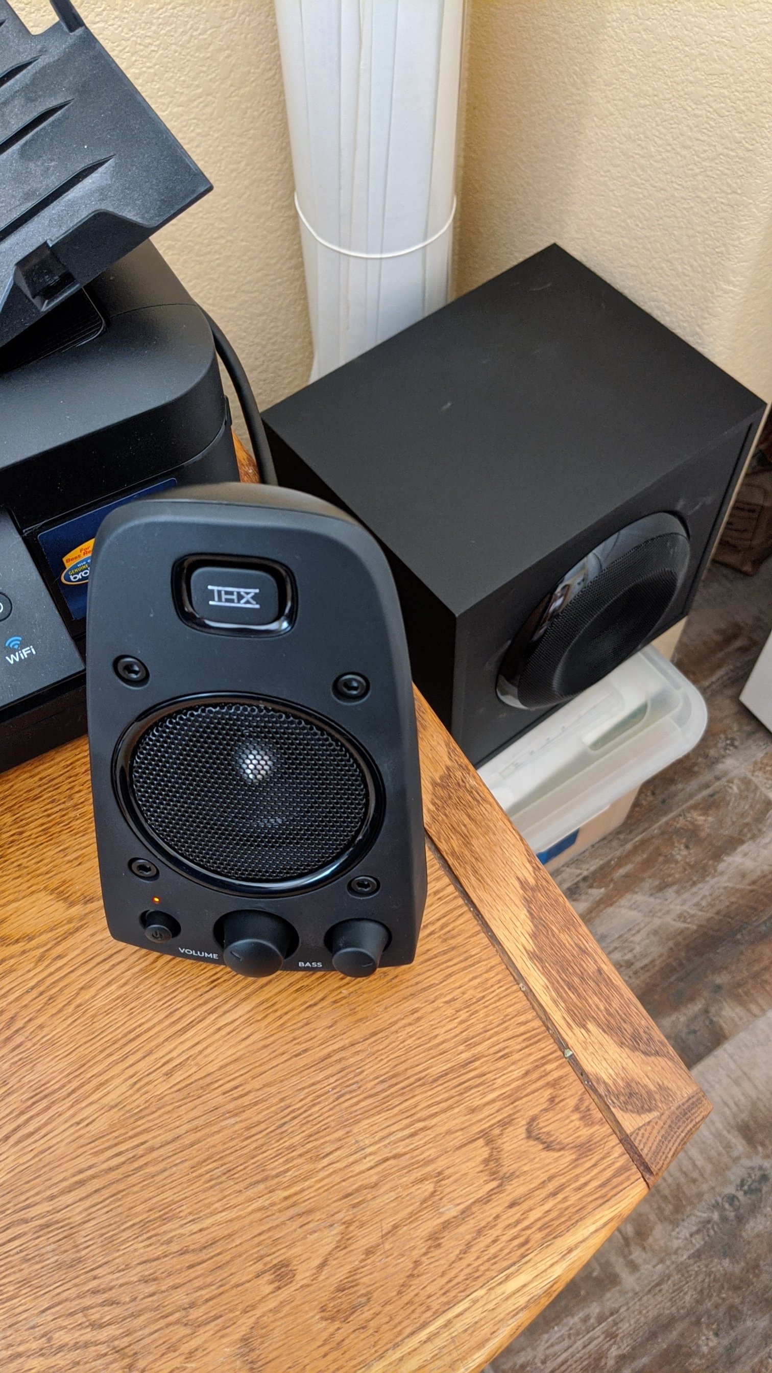

117,006
Damon I want to thank you for instigating me into replacing my desktop sound system..
Control of and quality of the sound is much better and nothing is burning hot anymore..
Reactions: Brian H and Nomad74
117,006
Think I'll have a delicious IPA and enjoy the evening's fireworks to celebrate our harmonious relationshipIMG_20200615_175204.jpg..
