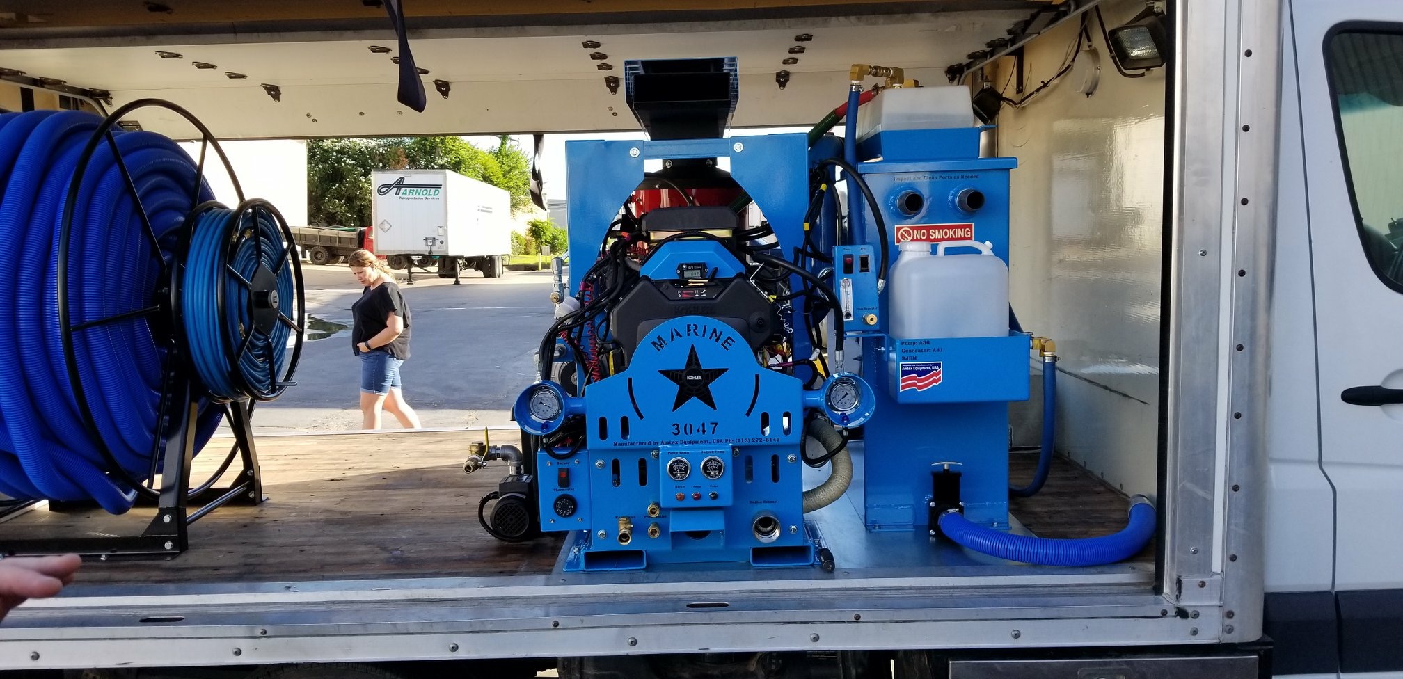

Looks like Ben at Amtex beat some of the big guys to the punch. He now has Ca CARB compliant Truckmounts.
28,284
I don't like the Kero burner but his inferno 500 is a pretty sharp machine

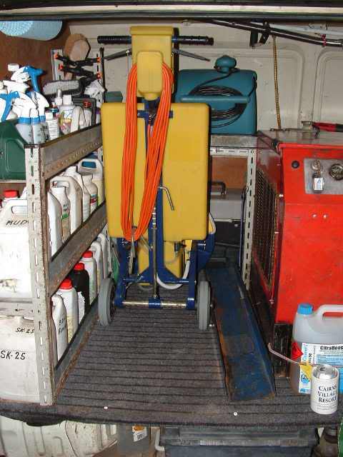

I believe Gary Bethel had the first CDS mounted in a diesel Toyota Hi Ace van.
They are now very common down under.
My tm was an Australian made HydraVac with a liquid ring vacuum & three cyclinder Kubota motor, which I bought 2nd hand from Gary in '98.
Pic below was back in 2003 prior to refurb; & installing Big Wheels on the Cimex.
Both tm & Hi Ace ran on gasoline\ from the vans tank.
All of my Hi Aces have been the smaller ones, about 10' load area, nearly 6' wide and the main reason, because I can get into garages under 6'6 high.
My tm was mounted across the van with 1/3 of the weight past the rear axle.
All controls were easily accessed via the side door.
Most of the other guys prefer to use the longer wheelbase & higher roof-line.

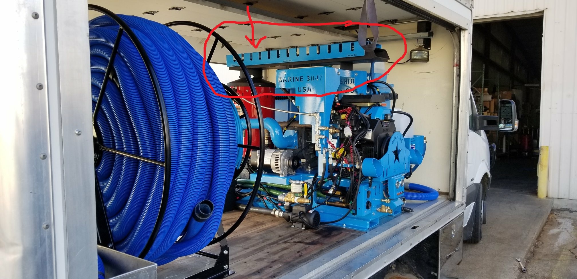

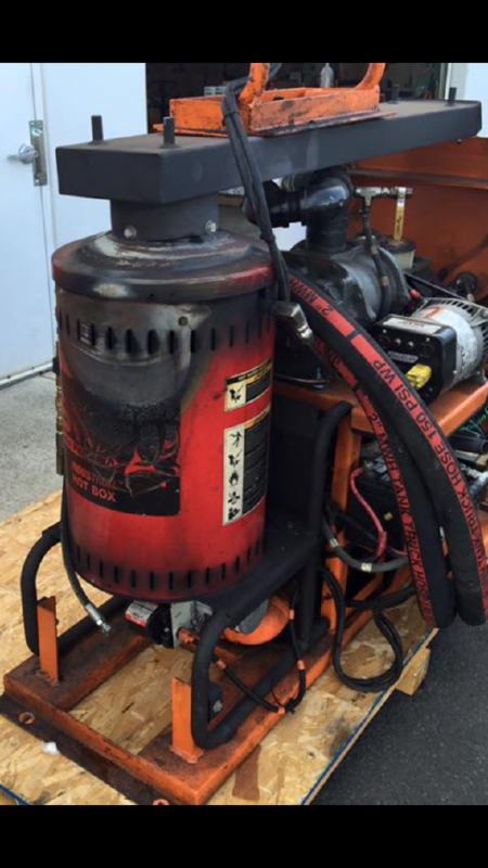

Anyone who has ever ran a 280,000 btu fuel fired like that should be very familiar with the scorching exhaust those things put out.
Why Ben continues to use such a utterly ridiculous, completely restrictive exhaust for such a burner continues to boggle my mind.
Fooking jet engine exhaust met with an immediate 90 degree angle and the scorching exhaust running right across the top of the unit.
So much radiant heat only degrades every component on the machine faster, and is a death sentence on such a complicated design.
Betcha the hot exhaust will also degrade that weatherstrip on the bottom of the rolling door above.
Not to mention it's completely over-kill for cleaning carpets.......pressure washing is where such a unit really shines.

Yeah this nortstar heater are outdoor fitting for pressure washing. 285k but is a crapload of heat
Actually, its more like 360k btu. And thanks for posting the old pics of my unit before it was replaced :)

Totally forgot it was yours.....lol
How long did that thing last?
That picture was taken when it was pulled out at 541 hours. It has been totally rebuilt from the frame up. New everything and updated. It's a much better machine now. I keep it as a backup. The diesel makes my van smell like a WWII submarine.
Holy mackerel Andy :eekk:
How much raw fuel dumped into the firebox before it ignited?
and did you run K1 kero ?
(you should, instead of diesel)
and 360K BTU??
Holy Overkill Batman
I'm no stranger to oil burners .
and know that 230K will sustain 250 @ close to 2 GPM continuous
