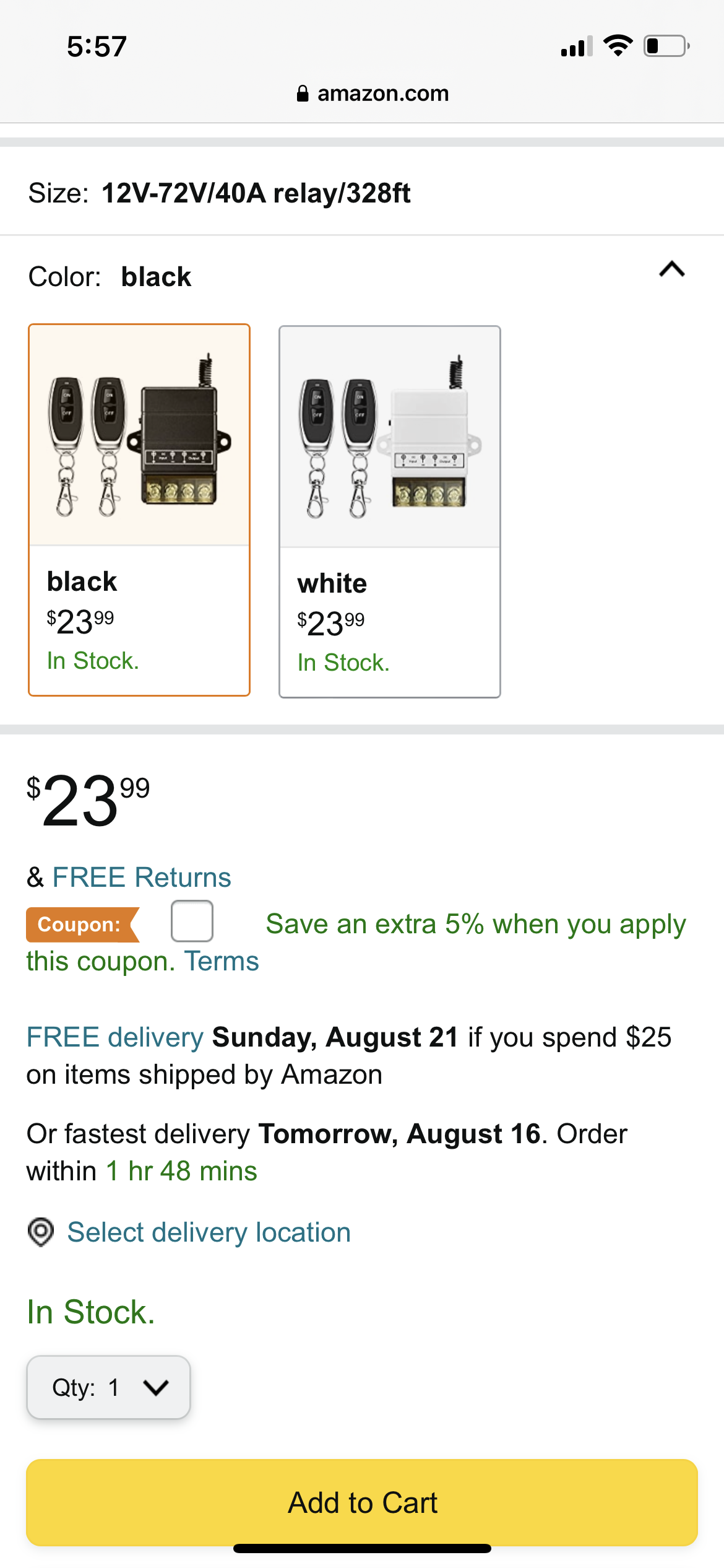

Amazon. My Dad did all the work, I will get you the link.

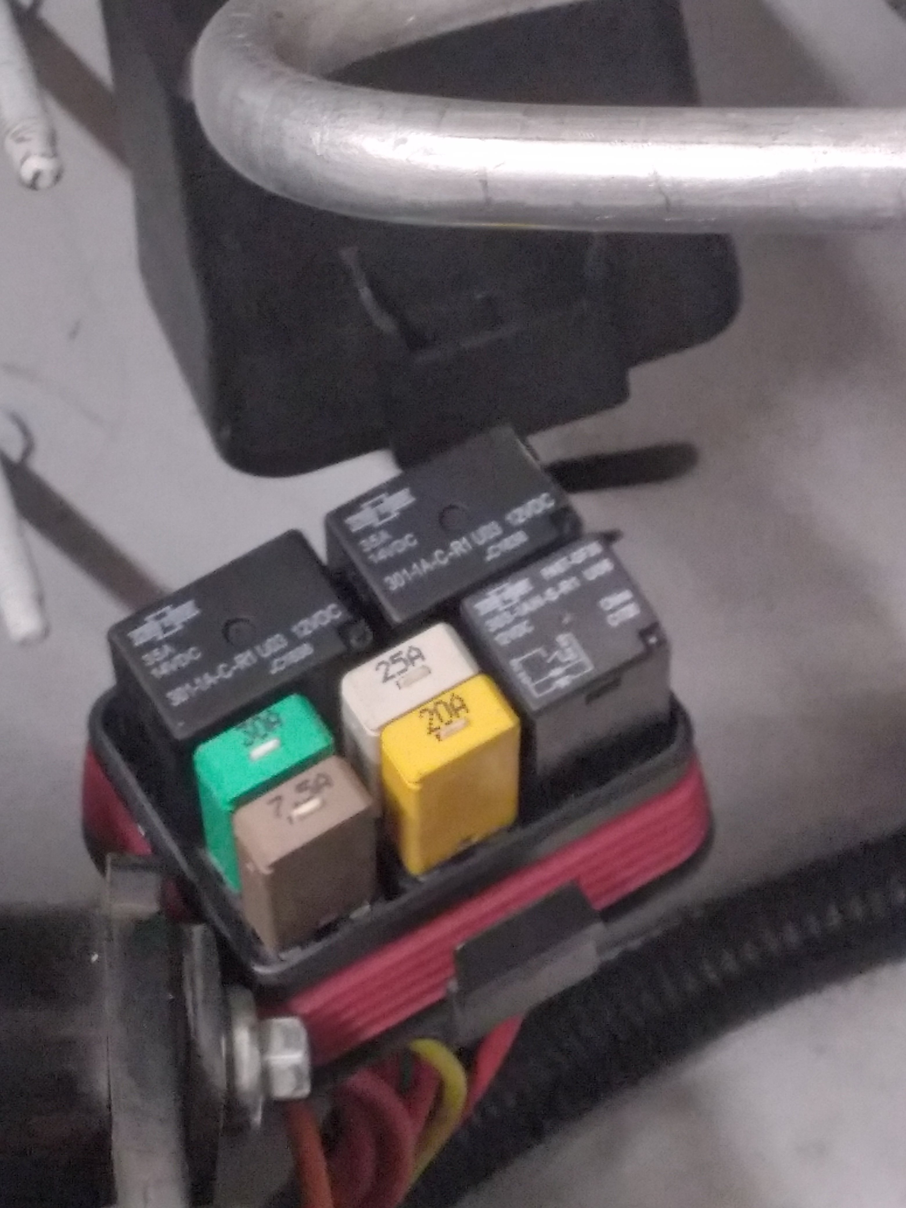

Hi, so you have a start stop option for your machine? My take on this is you operate a pto? Im really really interested in the possibility of incorporating this into my machine. My waste tank float switch shuts down the machine when full, and powers back up when i turn the waste pump ,so turning the ignition on and off should be the same, with that i have a couple questions first what are you using make modle of module ?, next range? Third and final will it work on 2020 chevy van? Thanks. D
Dwain Ray
Jul 22, 2020
1,133
It is great working solo with the remote. I dont have all the options, just on/off. I have yet to see if starting and stopping with the machine in the working position will take its toll on the clutch. Good for now. As far as accidentally hitting the on button while driving, since emergencey brake is off, im thinking it would just kick in on idle speed.
The real shocker is if I leave it with power off, leave the remote at home, go to the job and cant turn it on. I forget wiring stuff real fast when I dont see it for a while, and would be sitting there like an idiot. Calling the office to hurry up and bring the remote.

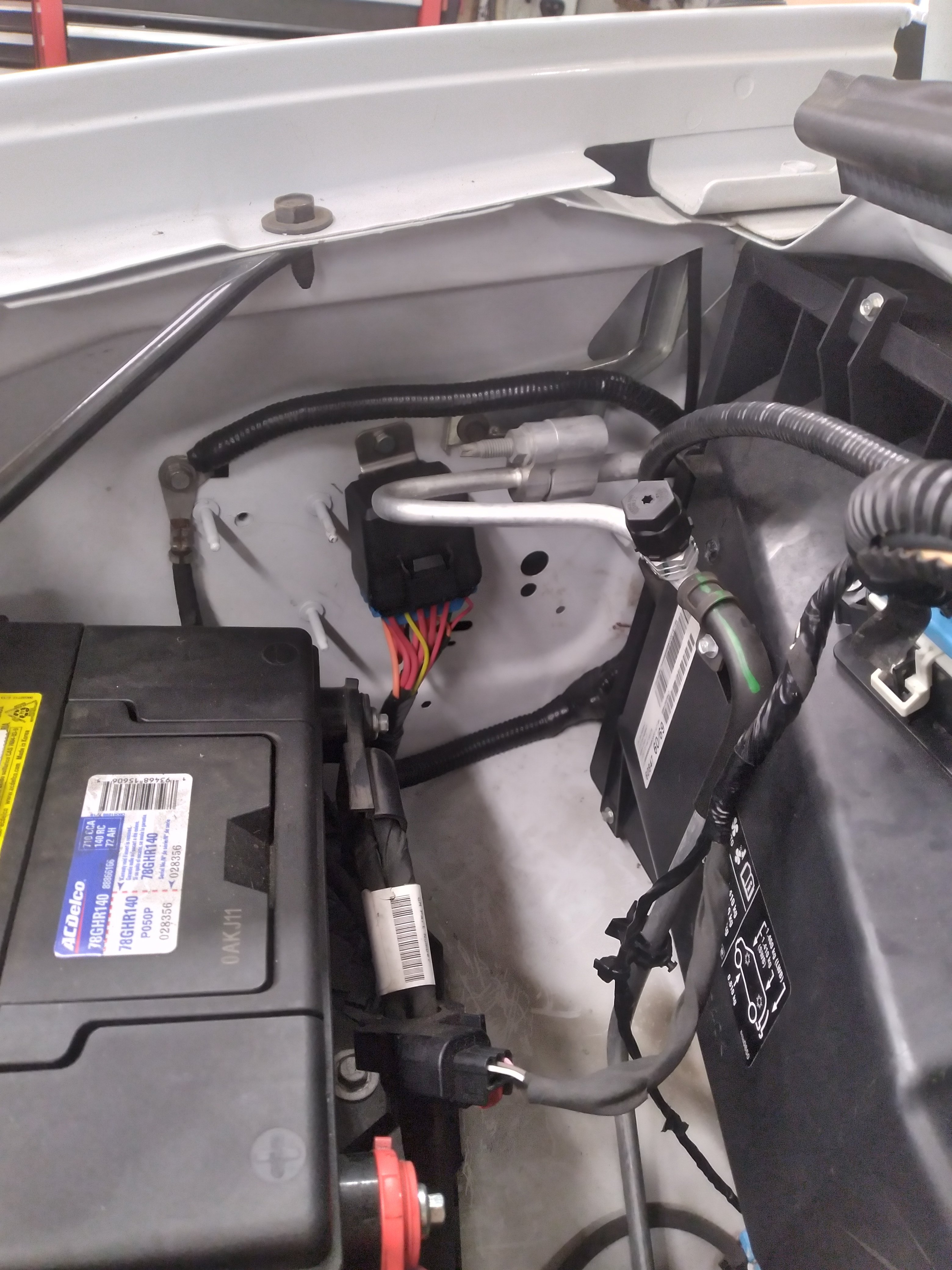

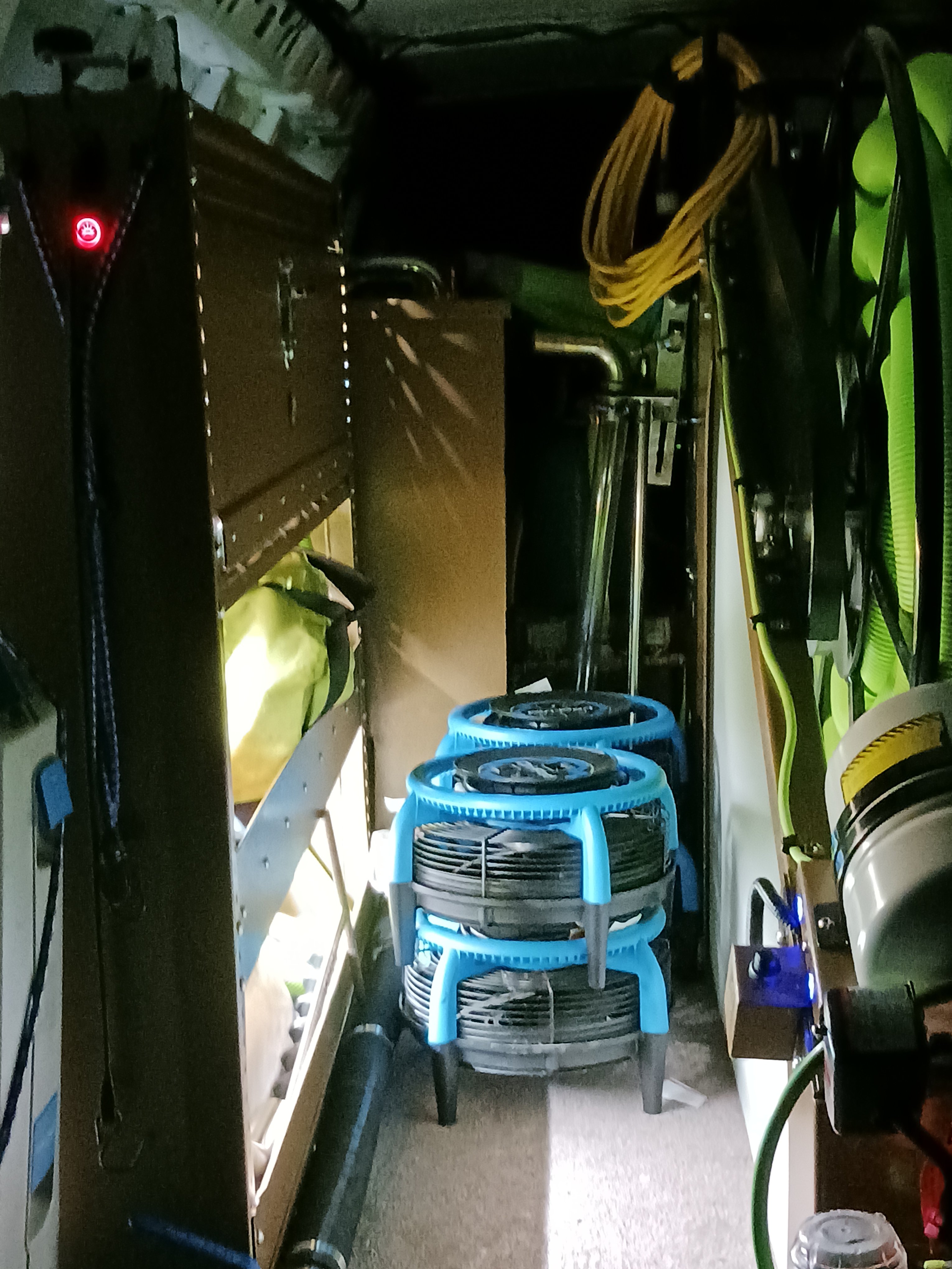

Looking thru these posts i see what youve done on my syst it will be a be breeze all my machines pwer is controlled by a single relay box and is energized with a switch on the dashboard so all ill have to do is wire the remote controller between the master switch and relay box, that way it not only cuts power to the machine but the throttle controller also so my engine will drop to idle and like the waste switch itll powerthe machine backup then throttle up also, or maybe easier tie it into the waste tank float switch which will kill the throttle controller also. ya!! my minds a goin now thanks frankinstien's gettin a remote!!!

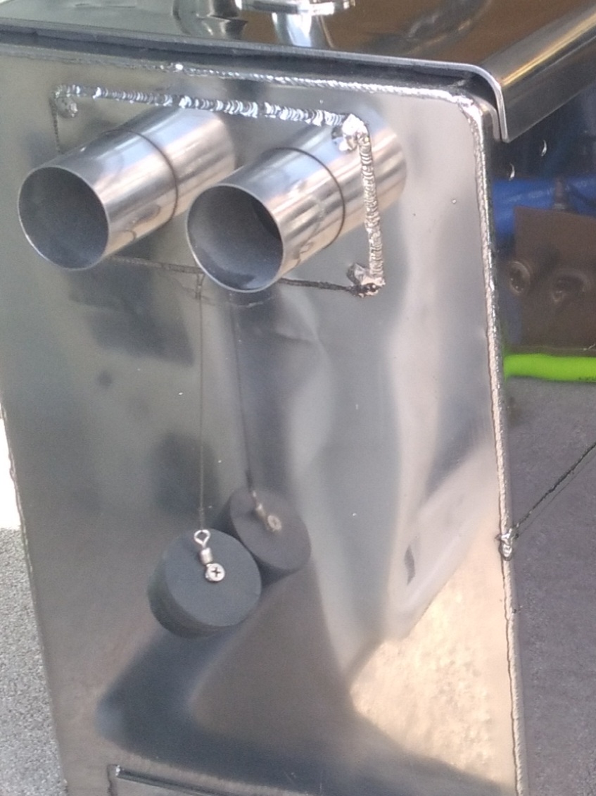

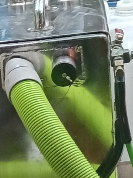

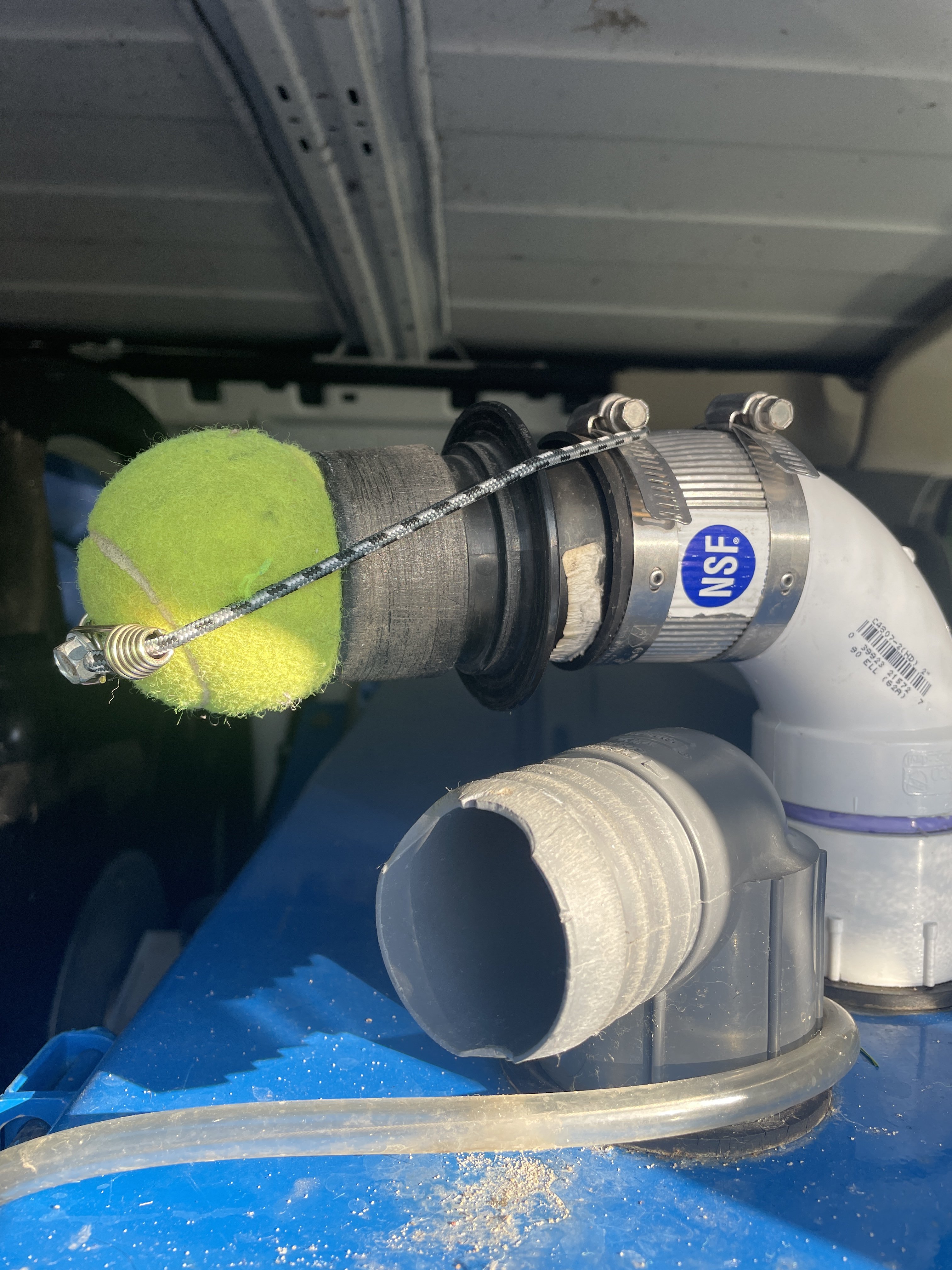

Loving this option after a couple days. First time I restarted remotely I had no suction. the tennis ball fell out of port 2 when machine off. Never liked the ports on this machine and had to customize from the start. My old Thermalwave has nice ports welded on and have rubber cap that I don't need to play around with. On this machine, not the case. I will find one soon, but for the last 6 years just been plugging with a piece of wood or a tennis ball.
Here is the quick fix. Now im set, and looks so high tech lol
I use a 2" rubber bathtub plug i got at ace hardware on a piece of stainless fish leader , holds good never falls out lasts forever

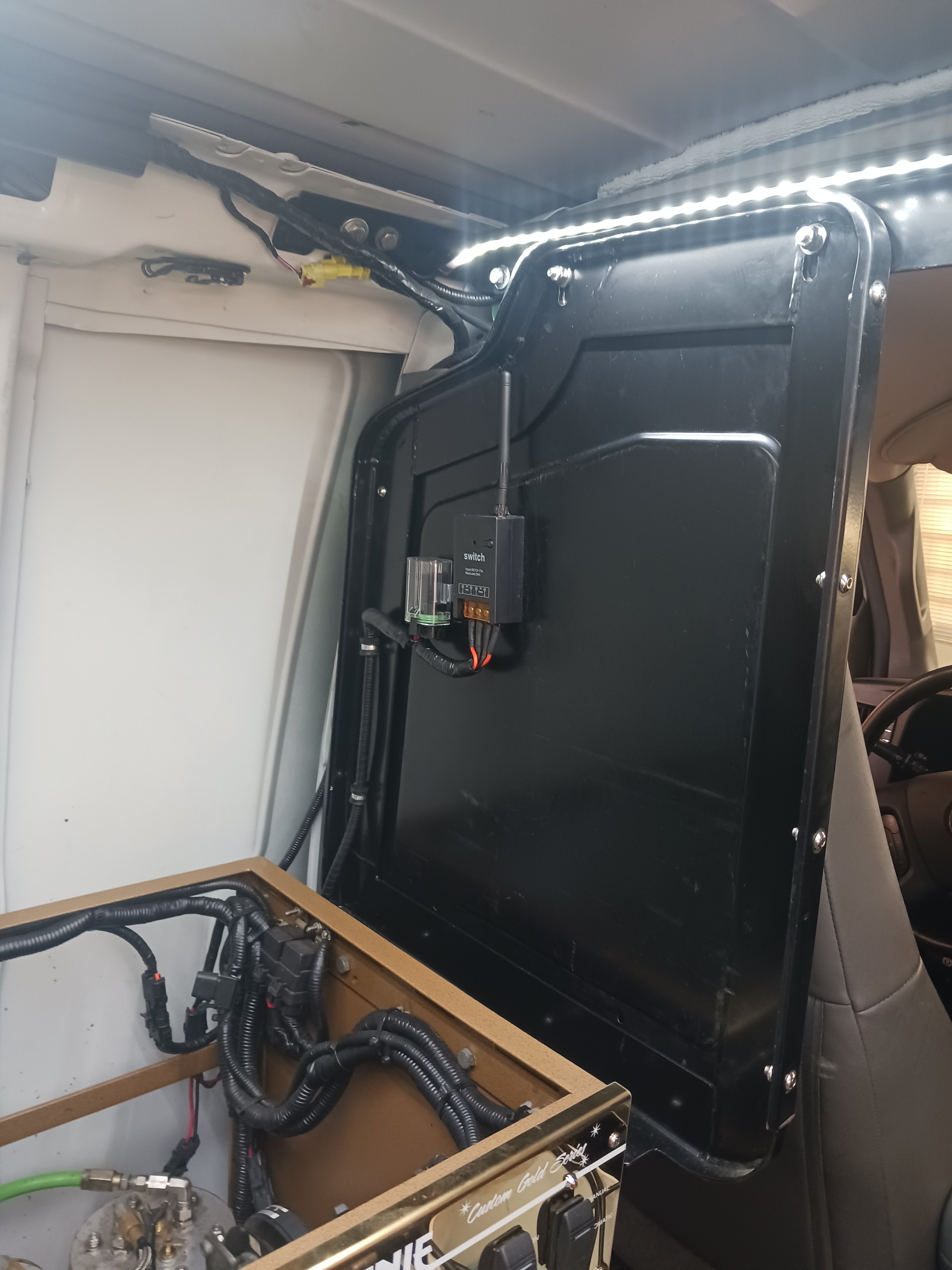

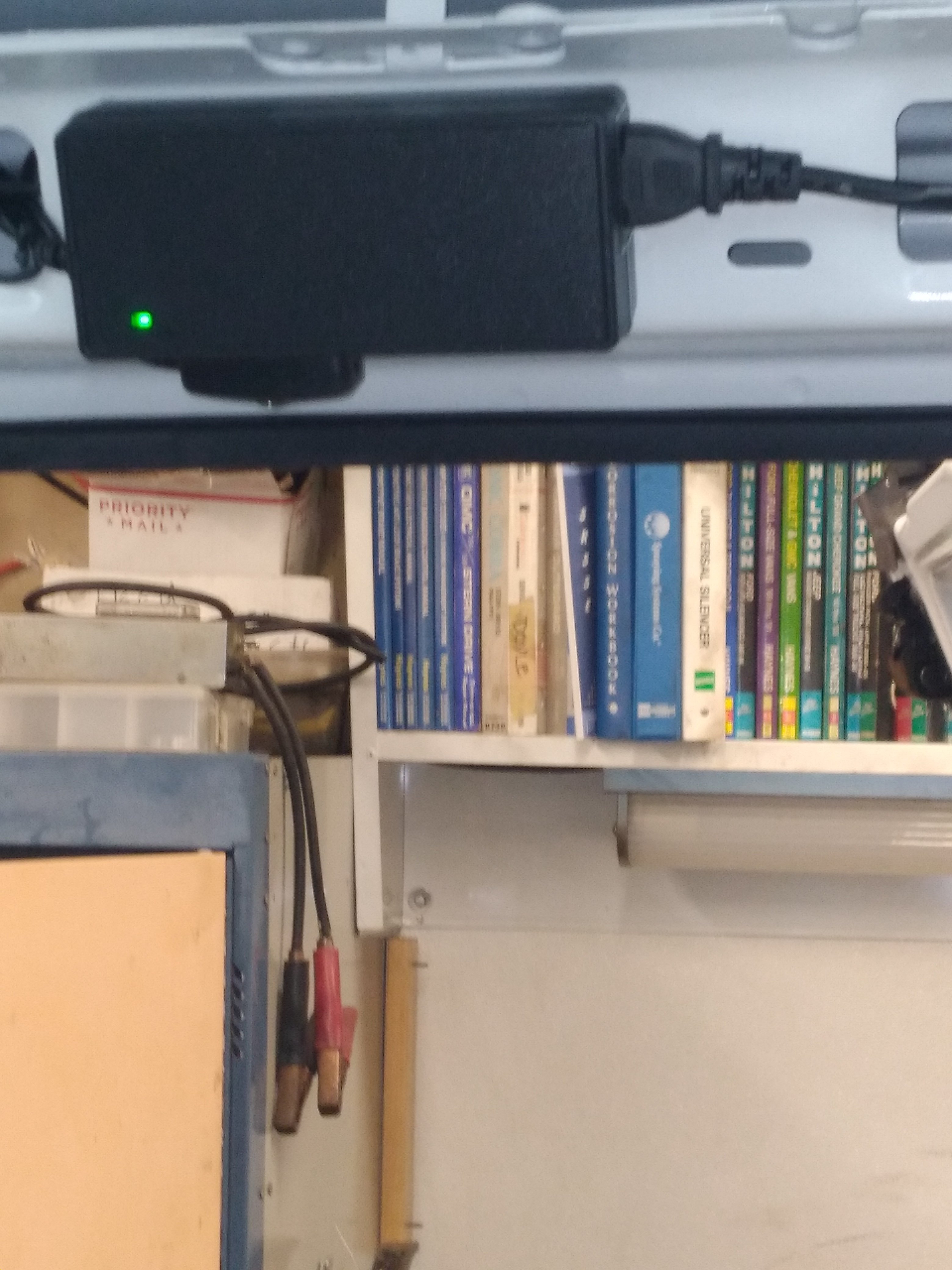

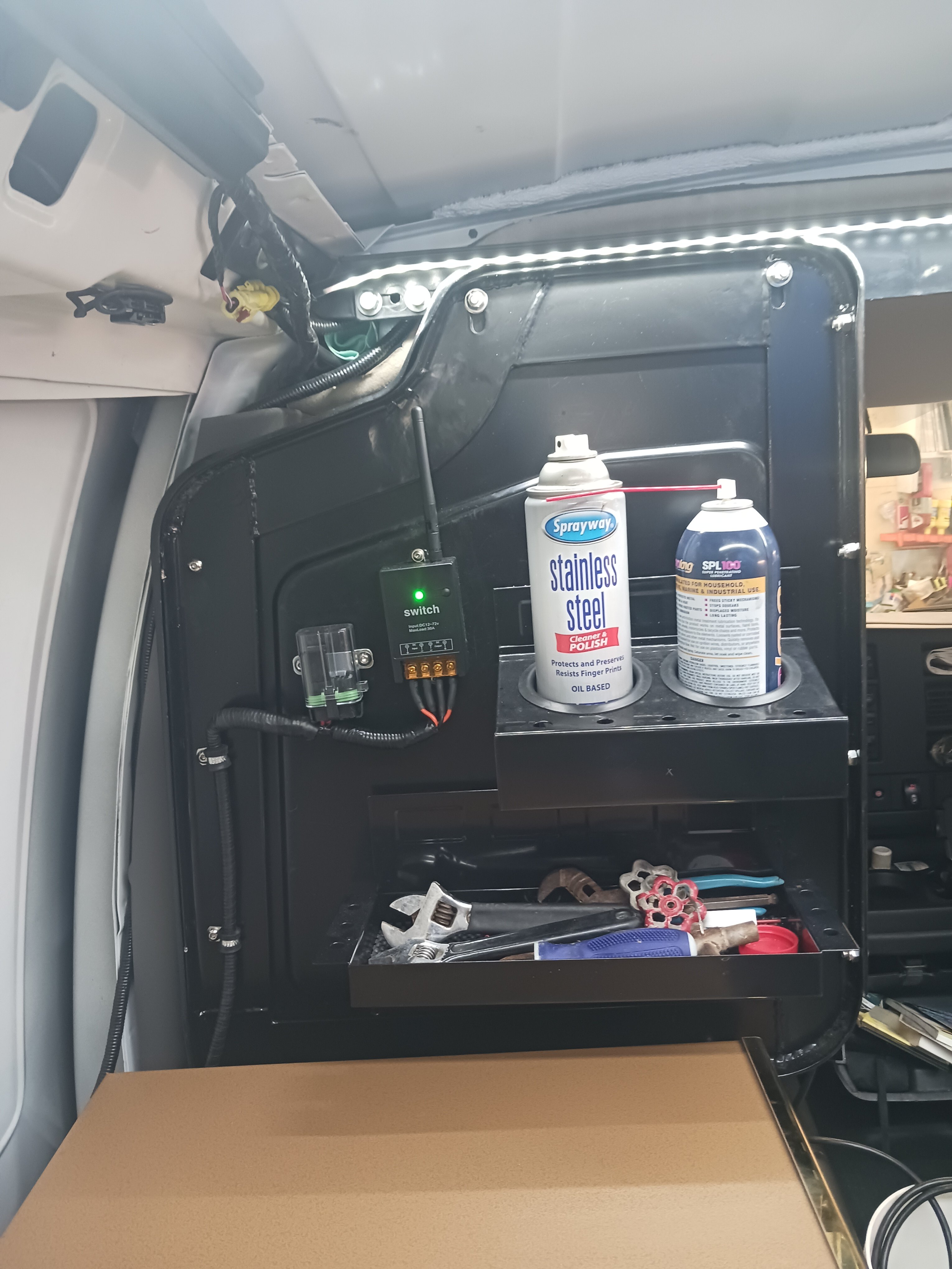

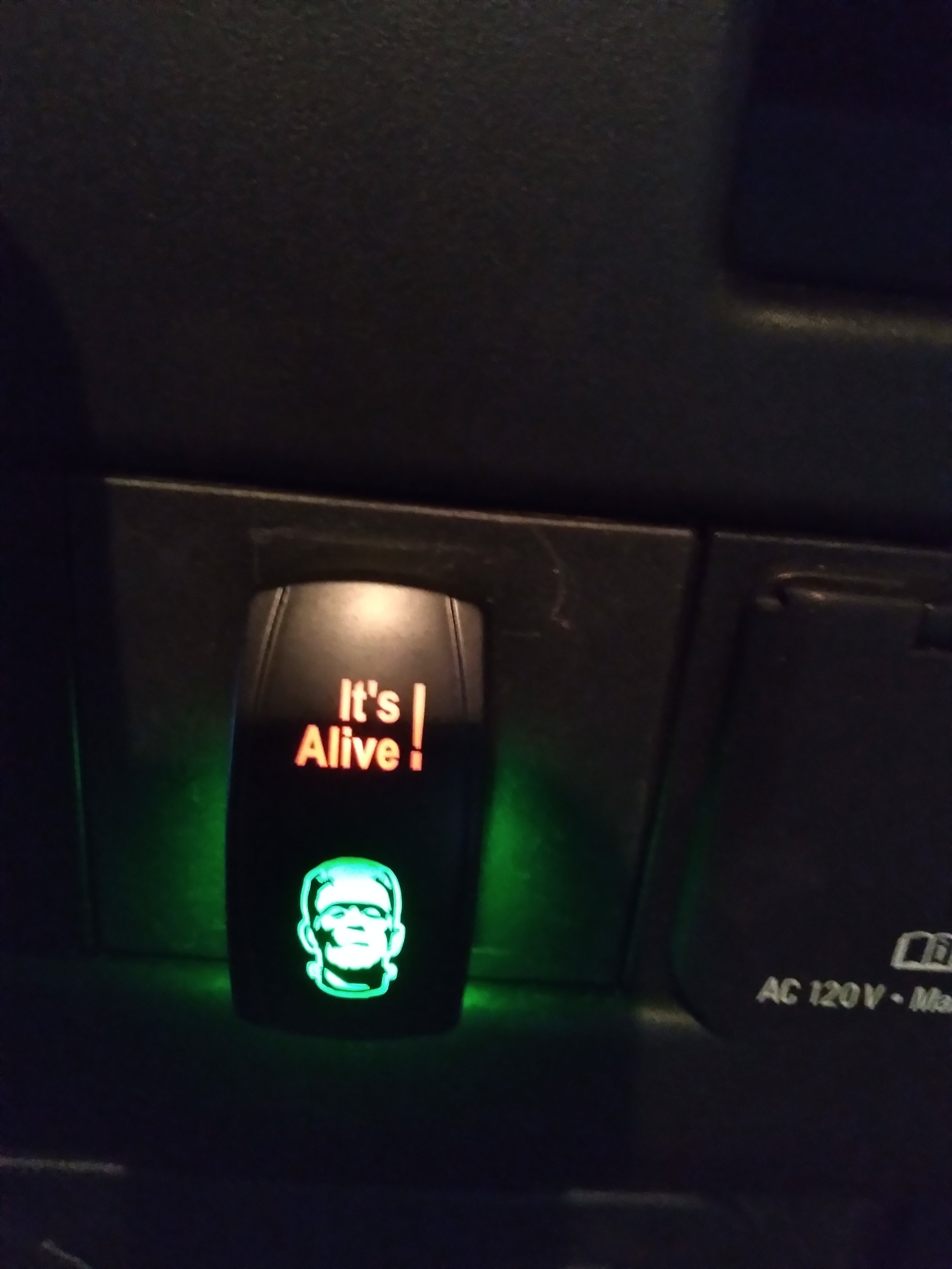

Thanks to Mikej Frankenstein's got a remote also. On my machine i chose to tie the remote controller into the wastetank high water circuit which uses the negative wire to open a relay to shut down the machine when the tank is full in order to do that the controller had to energize a micro relay to shut down the machine , i opted for a longer range remote up to 980 foot. Advantage to using this circuit vs ignition switch is if i forget and leave the remote home the machine will still run just no remote control (last picture is a video just tap it) thanks again mr mikej. Dwaino

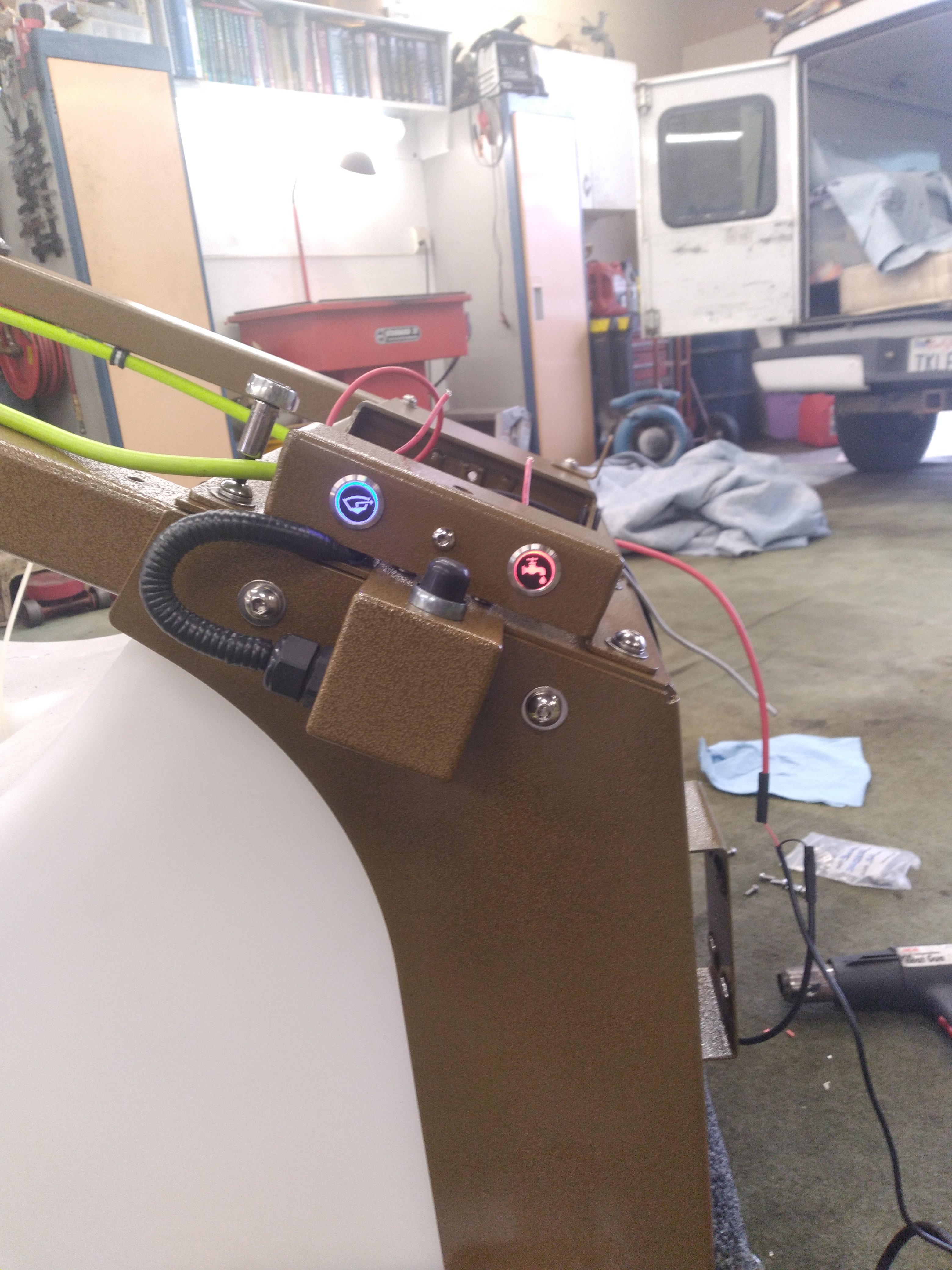

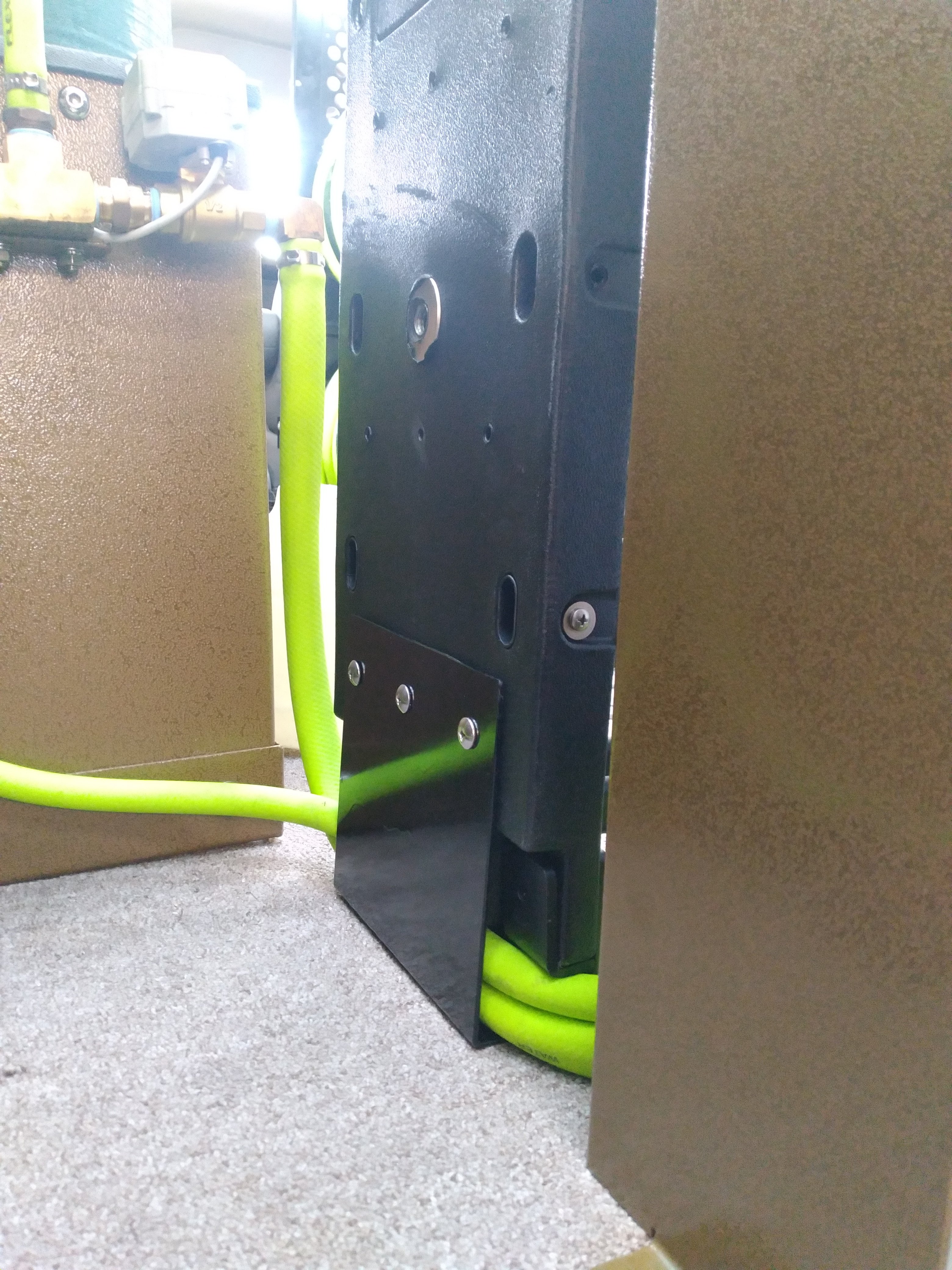

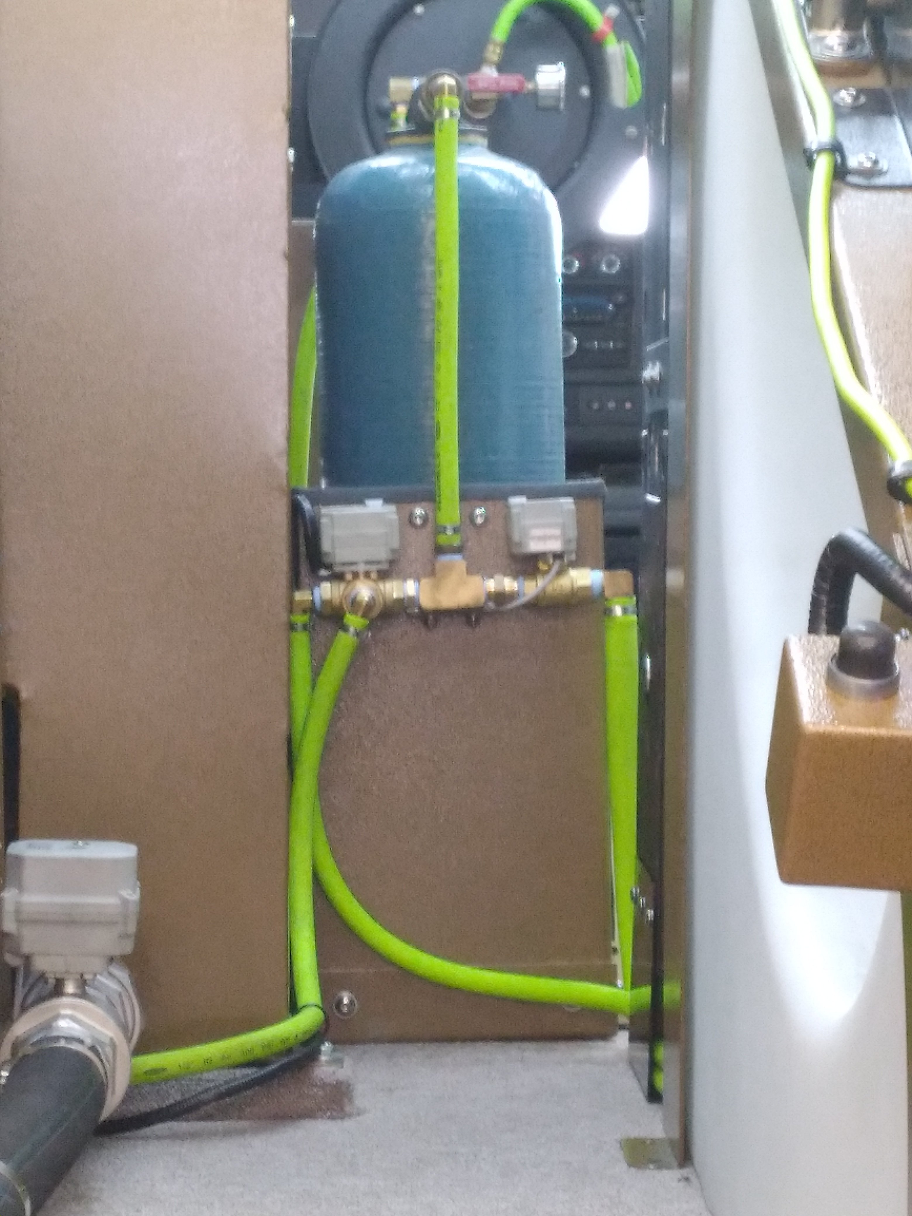

My machine doesn't really have that many special features. outside of the remote start/stop it has a motorized ball valve on the wastetank so as the 4' dump hose doesn't plug with sand between uses, and when i turn on the supply pump on the waterpond 2 motorized ball valves automatically re configures the supply hose to switch from filling the machine to automatically filling the waterpond both are controlled by push buttons on the waterpond (lit blue off/red on)and of course the lighting in cabinet and overhead lighting is 12v or 110v when plugged in other than that every thing else is storage alot of custom work involed but its just storage and shelfing but as far as special technologies go thats about it
20220610_091603.jpg 20220702_165545.jpg 20220723_135953.jpg 20220723_140427.jpg 20220321_100359.jpg 20221101_190636.jpg

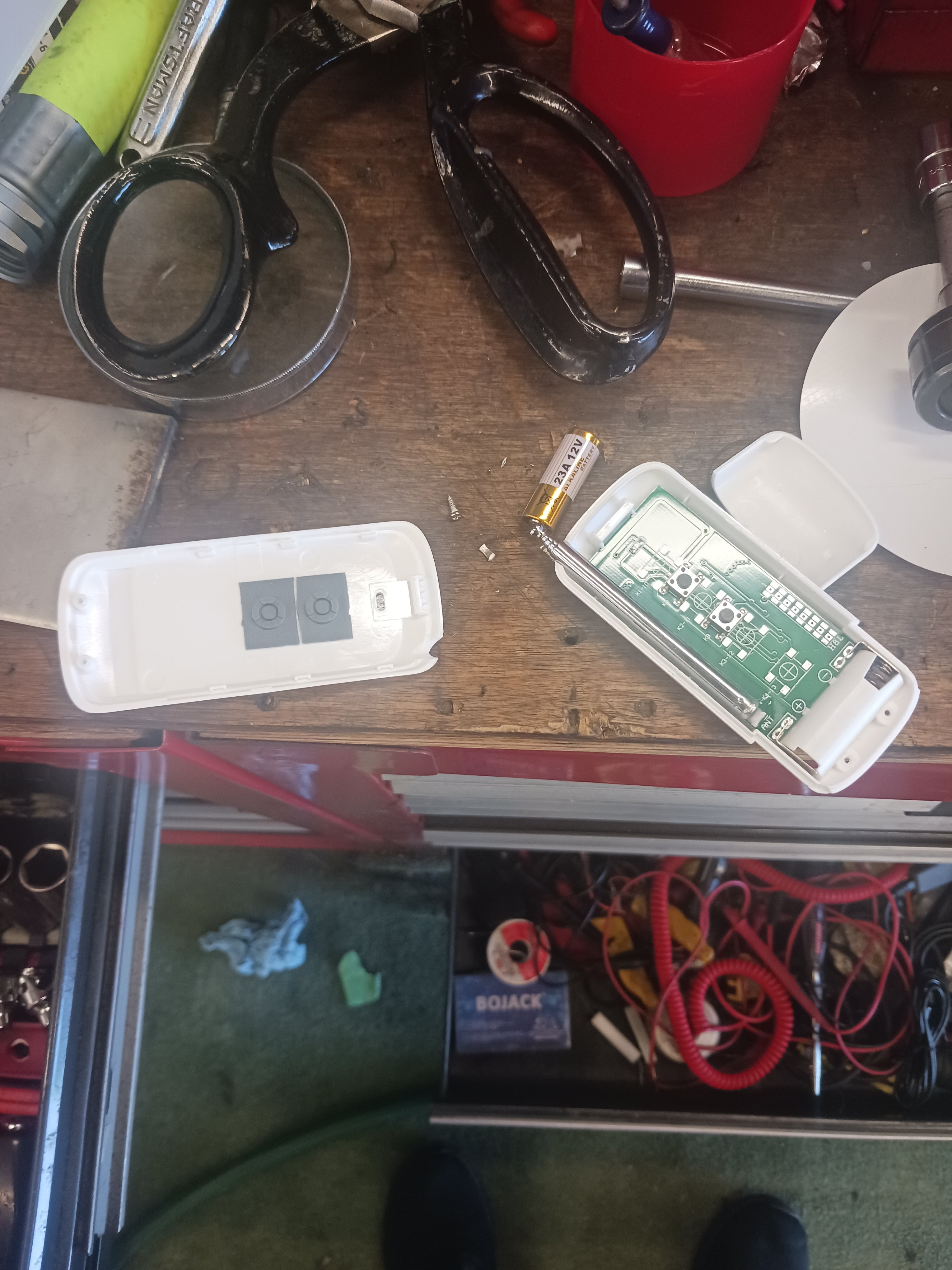

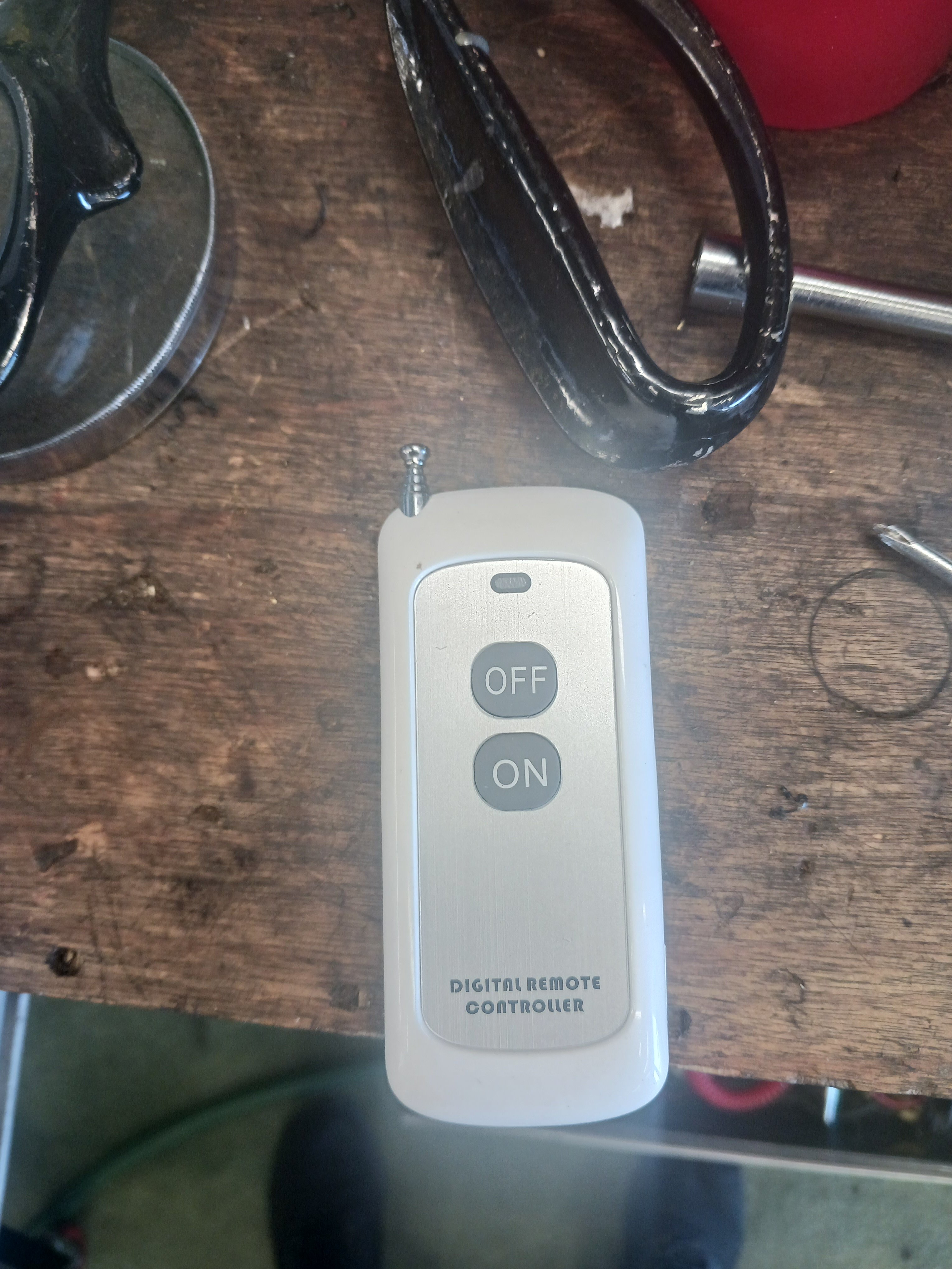

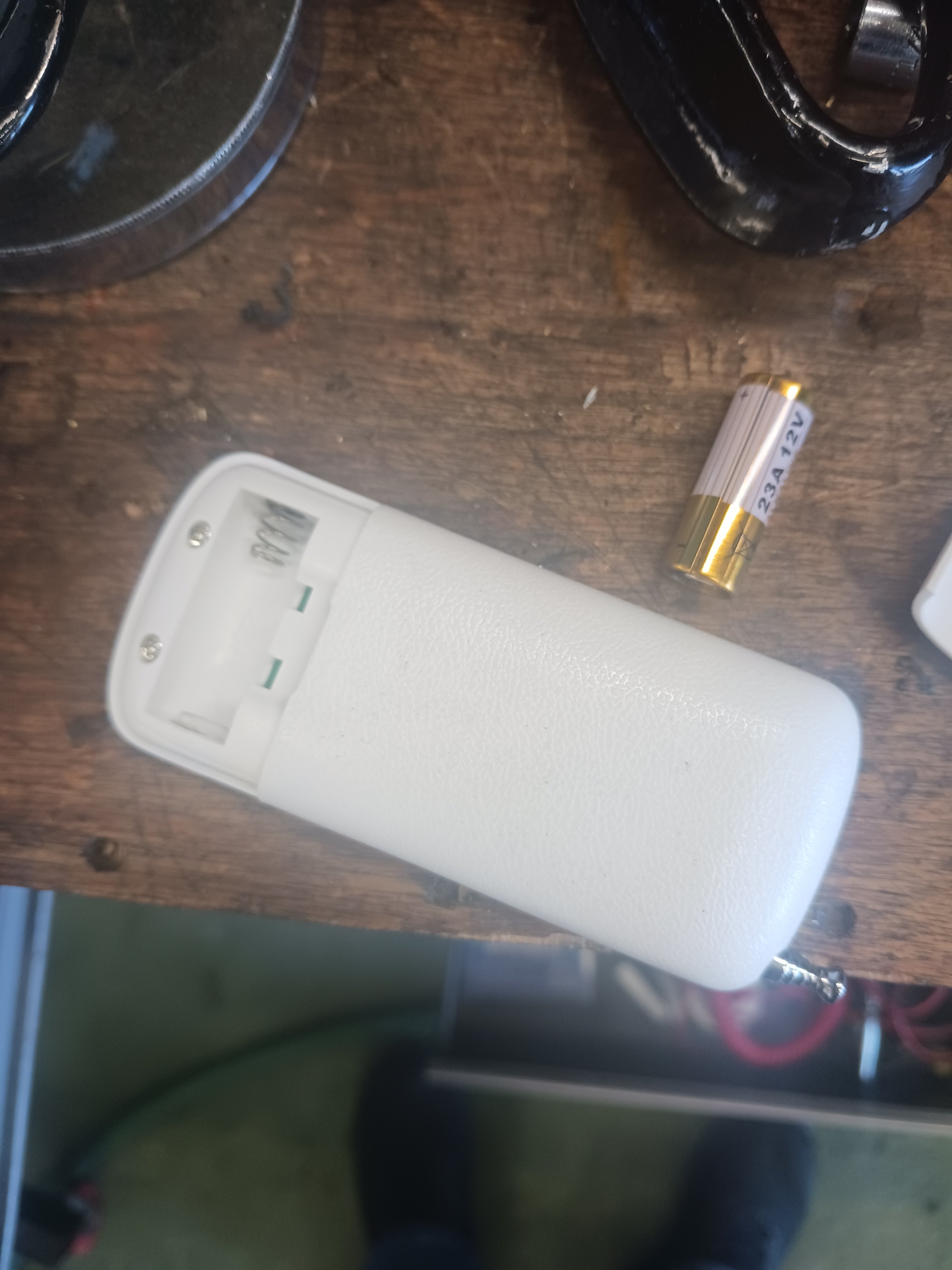

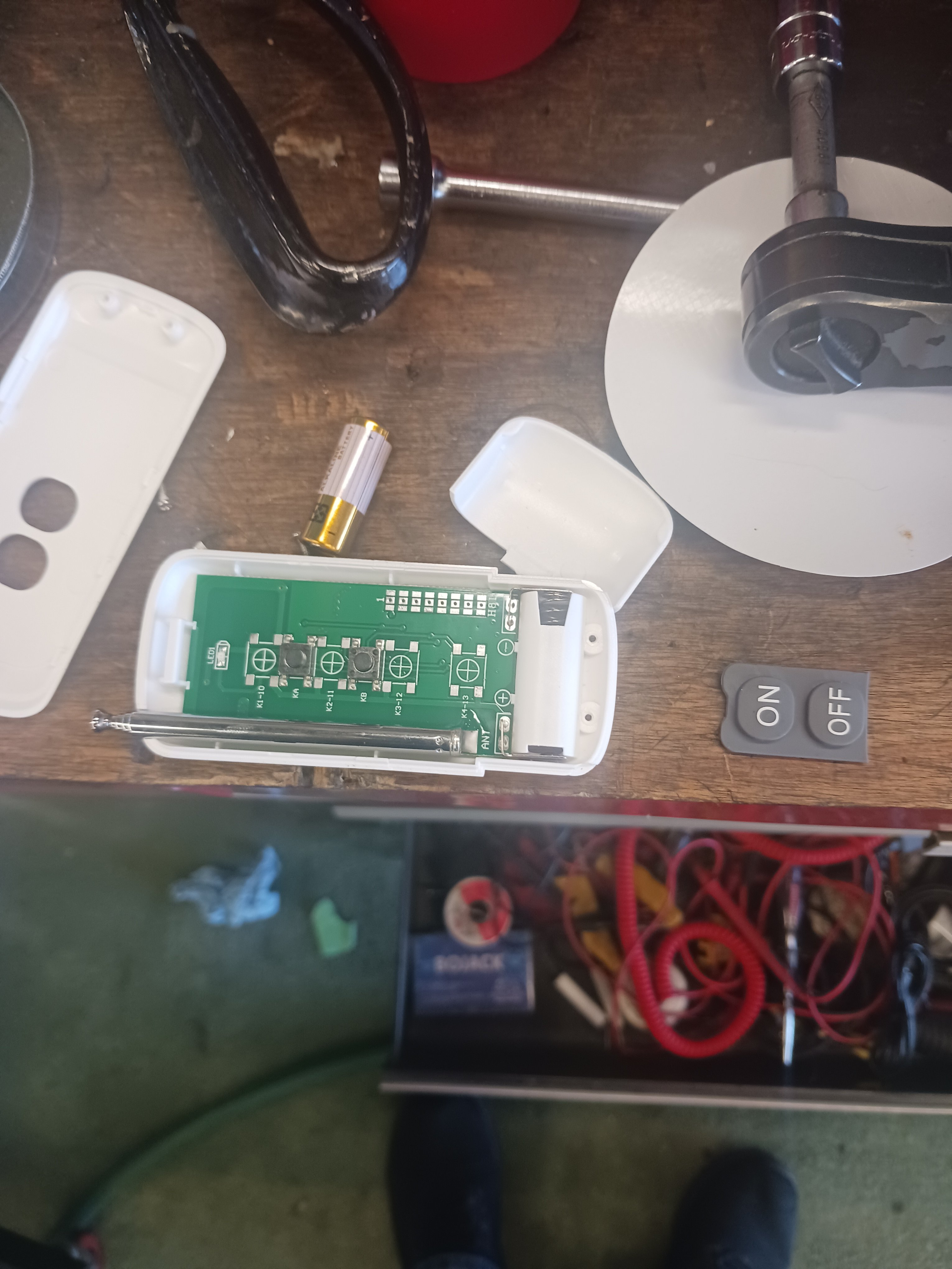

Lobe it love it! Only problem was , the A D D in me didn't like that on was off and off was on but a jewelers screwdriver ,razor blade and 5 minutes and presto! All better off is now off and on is now on!!
20230225_115920.jpg 20230225_120055.jpg 20230225_120255.jpg 20230225_120607.jpg
