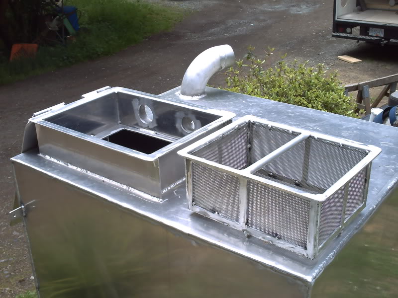

Duane Oxley at Acellerated Cleaning Systems makes a stainless steel filter that mounts in your van that can go days without being emptied and you never lose vacuum. It's priced around $550. Is your filter less than that?

That is a top notch unit,everthing Duane Oxley makes is TOP QUALITY to me I would love to have one of his TM's someday.
Thanks, Mardy. I call it the "UltraFlow".
We make it to order, so it takes about a week after the order is placed, before we can ship.
The reason it's made to order is that it's available in so many configurations, that it's difficult to stock them all:
3" to the machine (for 47 blowers, etc.) and 2.5" inlet
3" and (2) 2" inlets
3" to the machine and a 2.5" and a 2" inlet
2.5" to the machine and 2.5" inlet
2.5" to the machine and (2) 2" inlets.
2" to the machine, etc...
