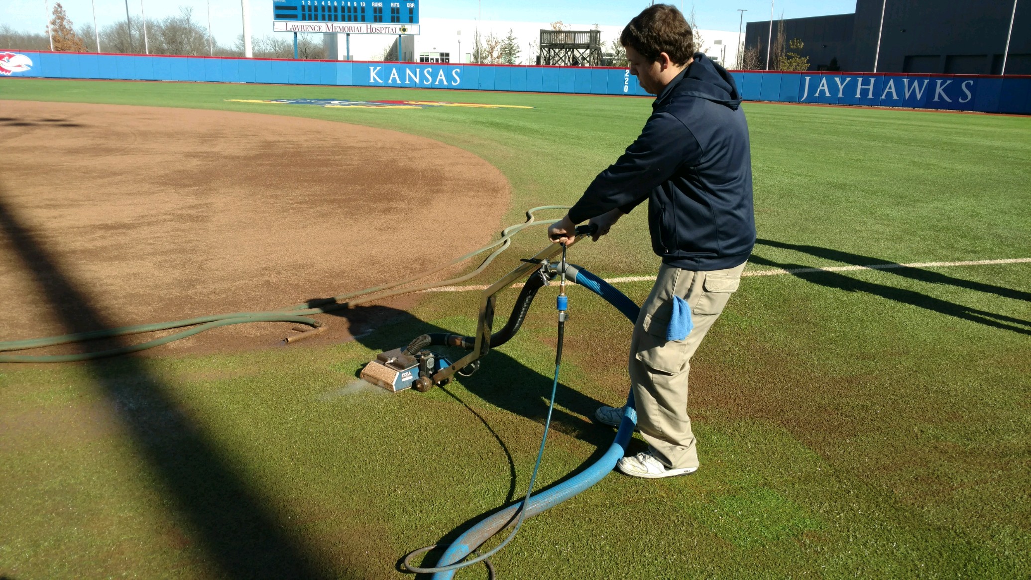

Anyone clean artificial turf?
The kind they use on sports fields? We tested cleaned some and it does an amazing job of cleaning but those rubber pellets are clogging the filter too far to be productive.

Lee how did you filter the rubber pellets? ZIPPER SPINNER did a fantastic job but we ended up with 5 lbs of rubber doing a small test area of 4x10

I think you are causing the lifting of the pellets with the as. Try an old drag wand and lower you pressure.
It is just plastic you are cleaning.
Might try it but it won't flush the clay as well as the ZIPPER.
We will have to try that. They want to schedule cleaning but we can't until we have a solution for the pellets.

It might need a detergent to release soil from the fiber.
Worth asking how well the field drains as well. Since you're in a pretty dry-unless-thunderstorm area, it may not have been laid with good drainage, which would also explain why it got mucked up in the first place.
If vacuum is required, throw down a cheap plastic door screen and clean through it.
We thought about wrapping the glides with fiberglass screen but thought it might get blocked with pellets.
I like laying down the screen. Might try that. Thanks!

It’s just dried dirt. What happens when a prevac/cimex combo is used?
Reactions: encapman
Dan wanted to try a Cimex on it. I thought he was crazy. :biggrin:
Not sure really. I wanted to try the ZIPPER first. Then they got so excited seeing it come back to green the wanted it all done.
We are guessing 2 Spinners (2) eight hour days. Not counting any messing with the pellets.

From the Field Turf site:
FIELDTURF SCRUB DETERGENT
Regular cleaning with FieldScrub alleviates the normal buildup of atmospheric residues and revitalizes the turf fibers. HOW TO USE: Dilute Fieldturf Scrub as follows in warm or cold water, and apply by brushing or spraying for spot cleaning and Industrial sprayer for entire field application. RINSE well with clean water before using the field. Suggested application rate of 1:40 will require 4 liters (1 US Gallon) to cover 10,000 square feet. • Heavy dirt, grease, equipment fluids and oil – pure to 1:4 • Light dirt, grease and oil – 1:8 • General purpose cleaning – 1:40 to 1:80 RECOMMENDED USE: Yearly for Outdoor fields. Once/Twice per year for Indoor facilities (with adequate drainage).
PS: We never had good luck with vacuuming dirt out of turf, just too easy for the air to move through the top 1/2 inch and not pull anything deeper out. Getting big paint out required a heavy ammonia pre-spray chased with fire hose rinse and recover water from the field drainage system. Really don't miss doing this. The local teams have purchased their own turf equipment.
PPS: Don't tell them that the problem might go away with the first big rain...

I have a indoor gym / field that we do. I use a host liberator on it. Mist it with d-limonene (2 oz per gal ) as a prespray and use whatever compound we have. Works great but is time consuming. You need a minimum of .55 cents a sq to use this method. Forget encaping it , regardless of the machine. Cleaning plastic with plastic is a bad idea.
