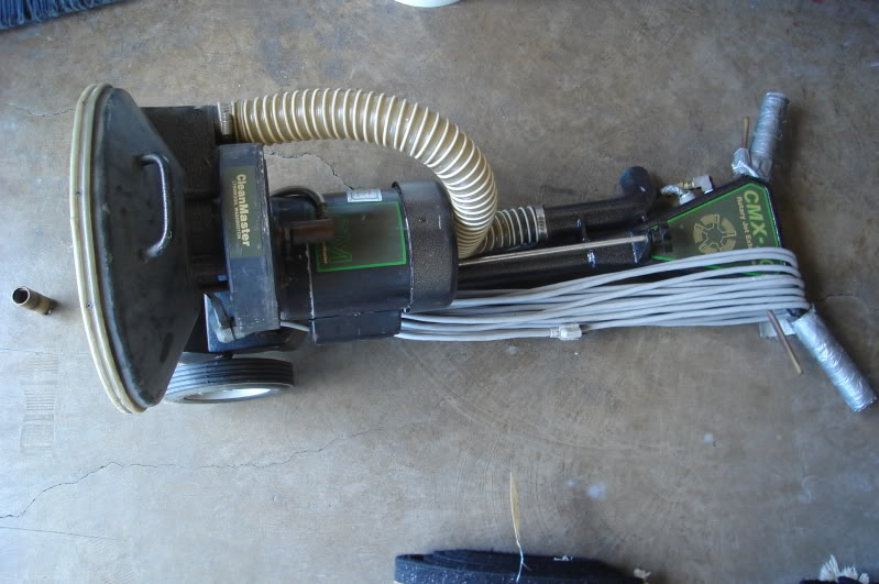

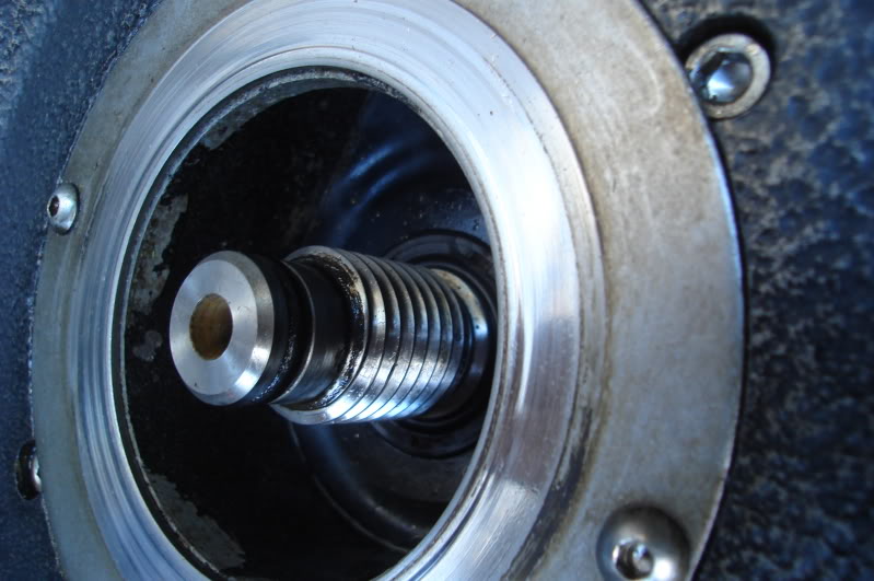

I tried taking off the head to my CMX20 aka RX20. It wouldn't budge. I wanted to change the seal since it hasn't been used in like 10+years. My pops loaned it to a fellow cleaner and he broke one of the head bracket. He did replace it, but it has always ran uneven after that. It would consistently torque making it very uncomforable to use. I did use it on a 12 floor hallway job and man did that suck!
Anyhow, I sheared off the 2 tiny bolts that held on the vac shoe to the one that got replaced. I was using a mallot and a 2x4 striking the bracket. Then, I took off the bolts holding the star onto the vacuum port (composite plastic). Then I proceeded to try and use 2 bolts and a long piece of pipe (for leverage) to crack it loose. It broke one of the seats that hold the star onto the composite plastic piece. All hell broke loose after that. :evil:
I still haven't gotten the piece off. Before anyone asks, I did use a box wrench to hold top from spinning. I did hit it counter clockwise. I read hear that someone else had problems with removing the star too, but I couldn't find it in the search field.

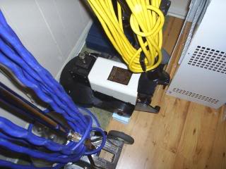

I found a local cleaner who had a rx20 posted for sale, but the whole unit looked different from mines. His one looked like a big box sitting on top of the machine. I was going to buy it just for the head, but the star didn't look the same.

You know it's reverse thread, right? Turn the star clockwise to remove.
The RX with the box is the old slow-speed model.

You know it's reverse thread, right? Rightie loosie
So counter-clockwise while looking at the bottom of the machine is the wrong way?
Counter-clockwise to tighten. Clockwise to loosen/remove. (Reverse-thread.)

I was able to get the part off. Yes, clockwise was the answer.
It looks to have double threads.

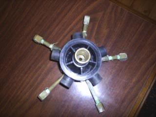

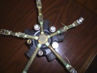

Nate is this what you NEED....this off of a OLD hydra master RX20..in photo...
The composite hub is fine shape...
If this will help you out...You can have it...! my zip is 33576...find out what shipping is..?

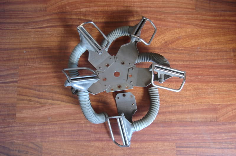

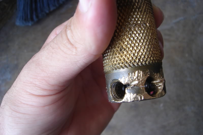

Hopefully it can work. Mines looks like it's double threaded. I have some pics of the pieces I broke. I do need a new star (the thing that holds the shoes) because of the broken one. It always torqued and didn't run smooth since the last cleaner who borrowed it tried fixing it. I can still reuse my vac shoes, 3 of the brass jet pipes and jets.

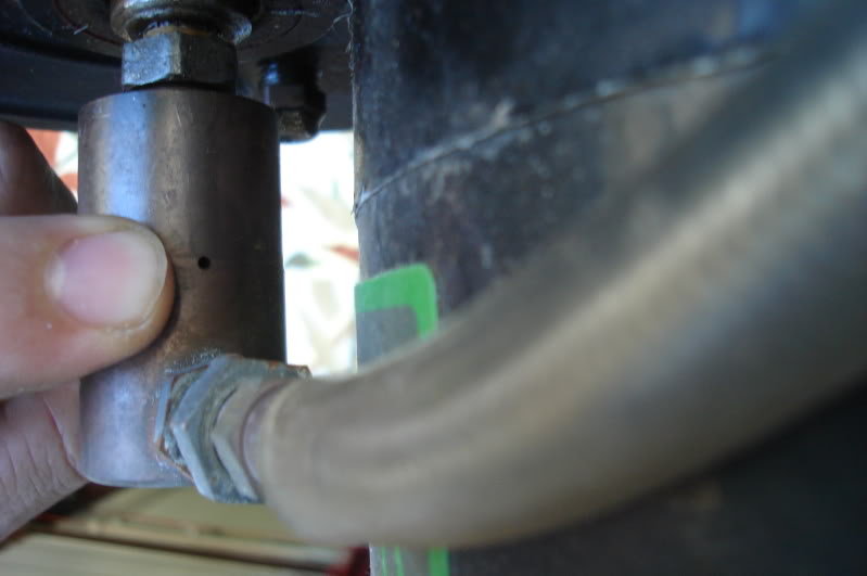

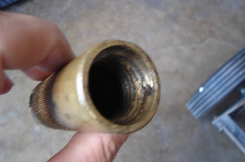

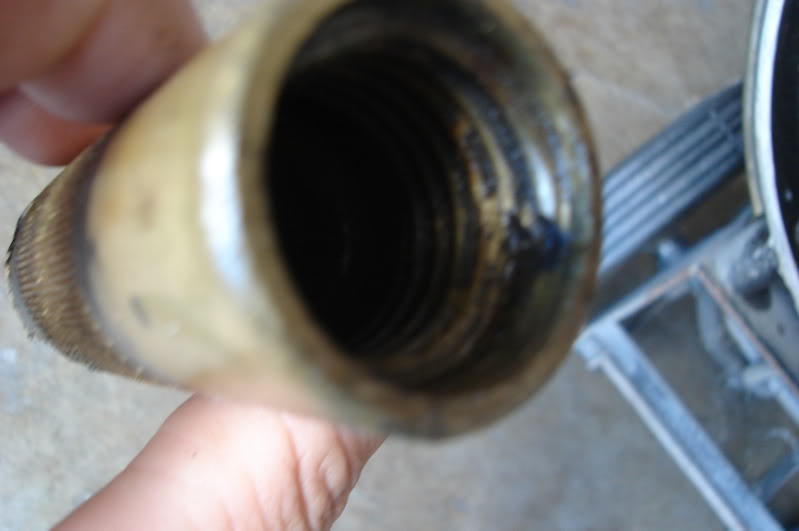

Also, what would cause water to drip out of the tiny hole on the top where the solution line meets the brass piece?
B
Bjorn
that is a rotary union and your going to need a new one the seals are shot

Nate
It is the same star...my unit is the SLOW speed...
I also have the star...it is damaged ...but you could use it to repair yours...
You could replace the damaged "wing"...Have a welder pop rivett & tack weld..???
John can sell you the "union" and 2 new hand grips...$2.50 each...
Ask John about a new flex star...? if you don't want to repair yours...
LET ME KNOW...

I'll take it as long as it has the double threads, I don't want to take something I don't need.)
The "wing" had 2 tiny nuts and bolts holding it on. The broken arm seems to be thicker then the rest, which makes me think that's the cause of the torquing.?. The other 4 arms seemed to have more flex in them when pushed on then the new one. Maybe it sat slightly uneven?
You noticed the grips huh, lmao. I'm at a loss for words on them. That's before my time. :lol:

The slow speed is a single thread hub and nate's is a double. We have all the parts on stock. You need a hub,star and rotary union. I'll email prices monday
