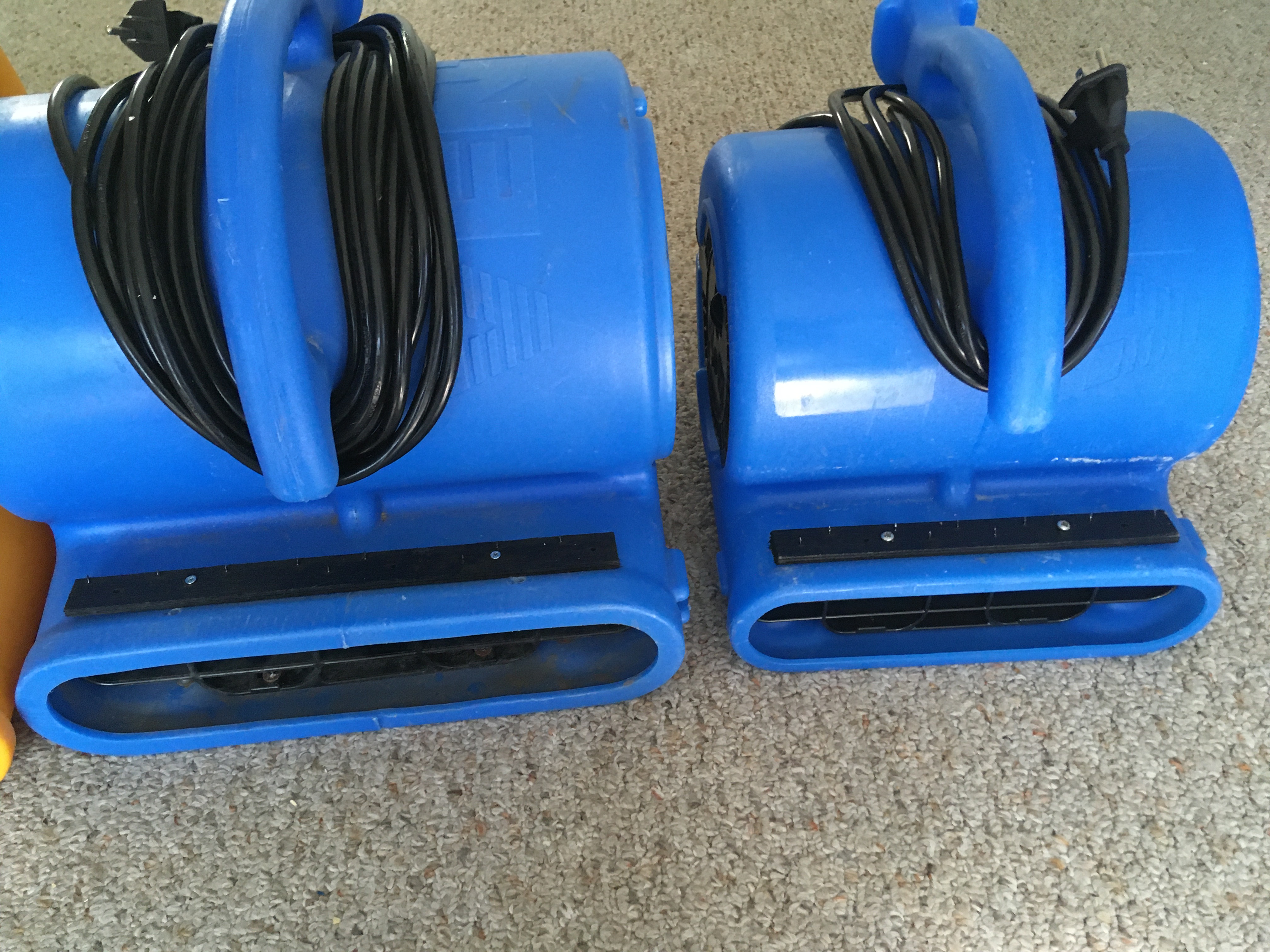

Good idea but knowing me, i might lose a bit of skin.I screwed a small strip of tackless on top of the discharge snout to hold the carpet in place on all of our carpet dryers.

No need to. Keep the dryer about 6" from the corner, flap the carpet/pad down on it, and shove the dryer back into the corner. VIOLA!Good idea but knowing me, i might lose a bit of skin.
do you run a carpet tucker across it to set the tack-strip pins?![]()

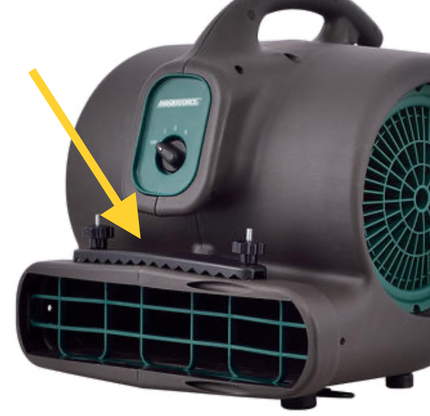

I saw them clamps. Kept going back and forth on whether to get a few. but now I know not to. Thanks for sharing.By the way the clamp in the first pic is the worst. It isn't deep enough to really grab the carpet and hold it tight. That clamp is sold by Airchaser but its the worst clamp I own. Heres a link, but hopefully you'll try the tackless. Its the best way to hold the carpet when floating. Carpet is tight no flapping and no need to set the pins just tilting the airmover is enough, you'll see
