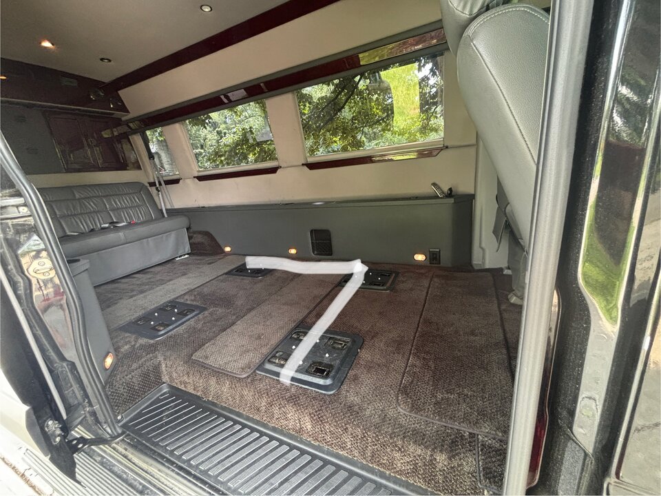

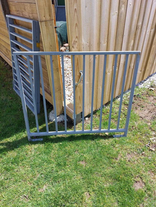

Ok everyone, I finally made some progress. Found a couple of balcony railings on Facebook Marketplace- $40 for the pair. They’re super heavy, made of solid square bar steel.
I painted them black, then attached them together to form an L shape, and mounted them to the seat mounts in the floor. This pic shows where-

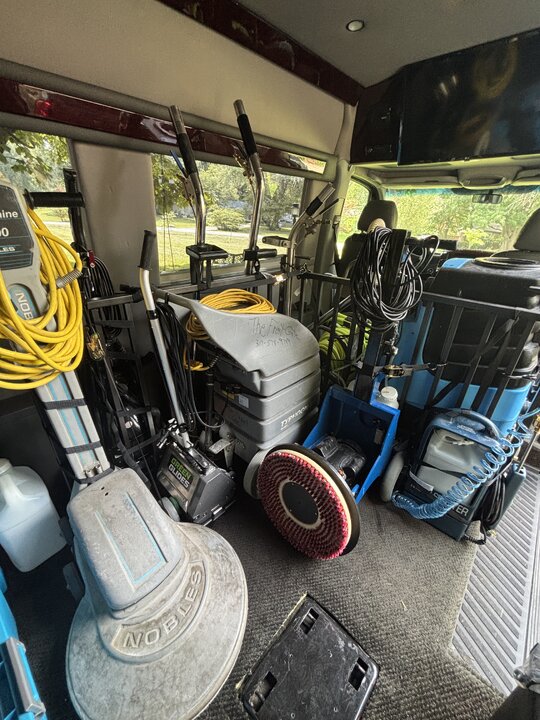

Then I moved in my big machines, and strapped them to the railings using ratchet straps.
I’ll show you more as I continue to make progress, but now I can at least drive without anything tearing up the interior, tipping over, or accidentally falling through a window…
