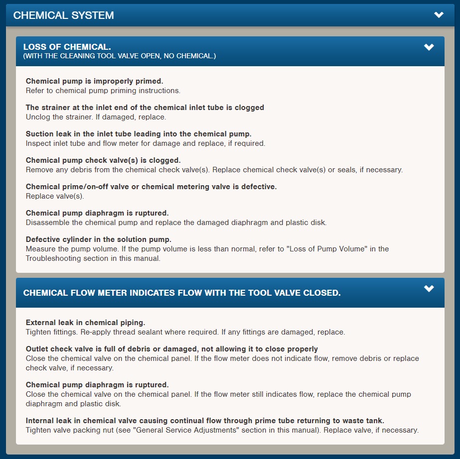

cracks in flow meter or other air leaks, bad chem pump diaphragm, clogs

Fred's advice above is exactly where I would start. My Boxxer had a hairline crack in the meter and it would not work. even after I tried to silicone it. Does it prime when you plug your vac hose?
