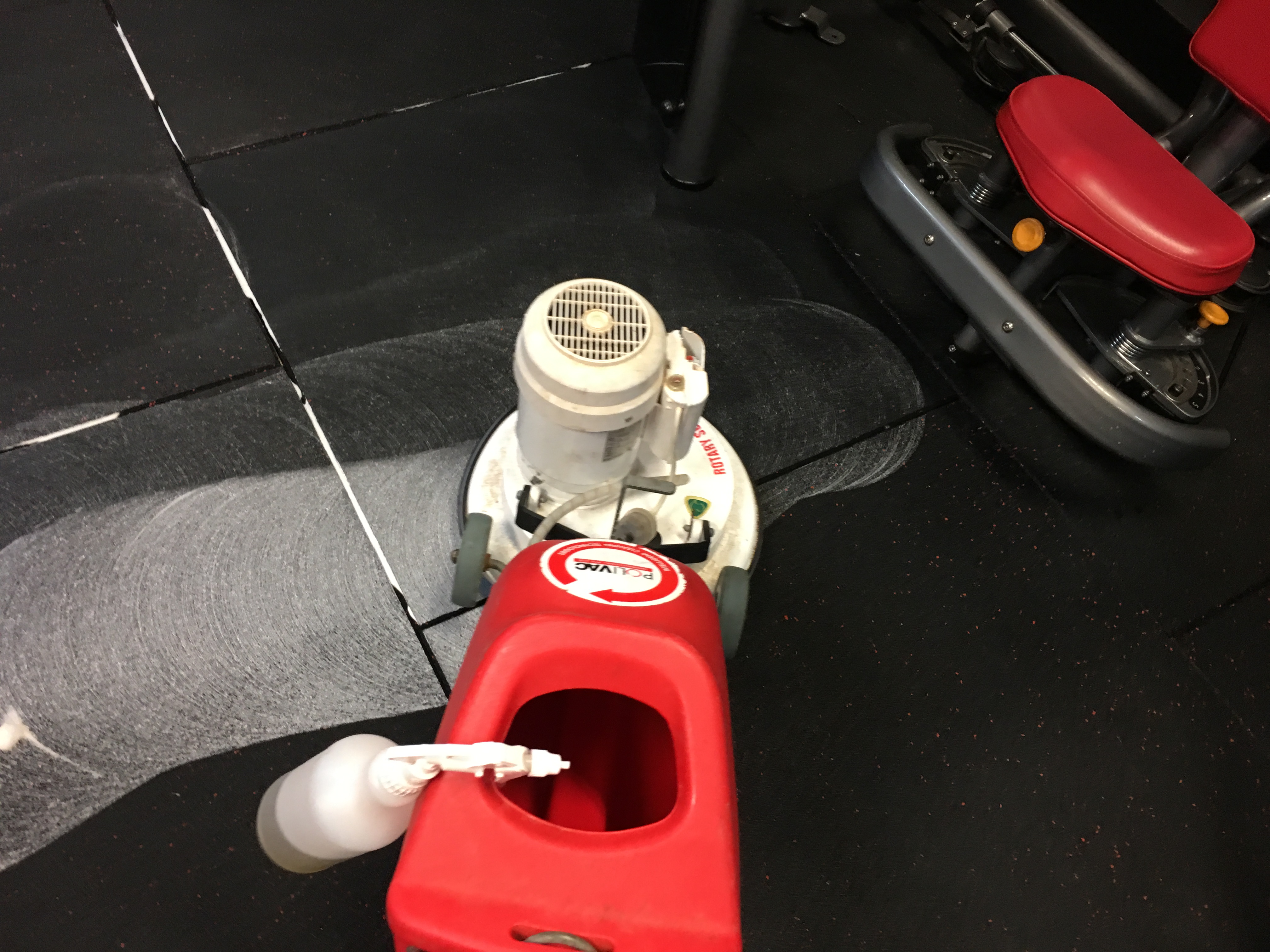

replaced trigger over the weekend and now it wont shut off completely, creating two huge f'n puddles with no way to extract them. Not that Puddles you idiot.

Poor Mikey! Sounds like the perfect storm.
  • To fix your over-wetting issue...
  1. Detach the top of the "Water Valve Operating Rod" from the solution lever.
  2. Loosen up the threaded "Water Valve Operating Rod" a couple of turns. Slightly (unthreading) backing the rod out of the blue "Solution Pinch Valve" will reduce the tension.
  3. Then reattach the rod to the solution lever.
It's a simple fix!​
