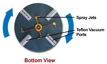

This is actually a pic of an existing Rotovac head to give you the idea. Take any rotary head with HDPE sliders, or cram HDPE sliders into the slots on any rotary tool you have, and use it for rug agitation in your flooded, soapy pit. Stop killing yourself with a third-world scraper on a stick!
This idea is actually the slumdog version of the roller head I wanted to make for rug pit agitation, but an industry patent troll has already patented any possible combination of roller and carpet cleaning, so this is the next best thing.

What is a HPDE slider?
High Density PolyEthylene. The tough but slippy plastic used to make everything from oil-free bearings to wand glides.
Got a video of this in action?
I did a video of my roller head for the patent application as a proof of concept, but not the same thing. I actually started thinking about just using rotary glides when I saw Keith Studebaker's HDPE glides for the Hoss at MF S'Cruz a few years back.
th
The thing every rug cleaner knows is that brushes work from the top and don't really do a very good job of getting impacted soil up from the base of an Oriental rug nap, compression does. A heavy rotary tool + a compression "blade" = dirt removal.
