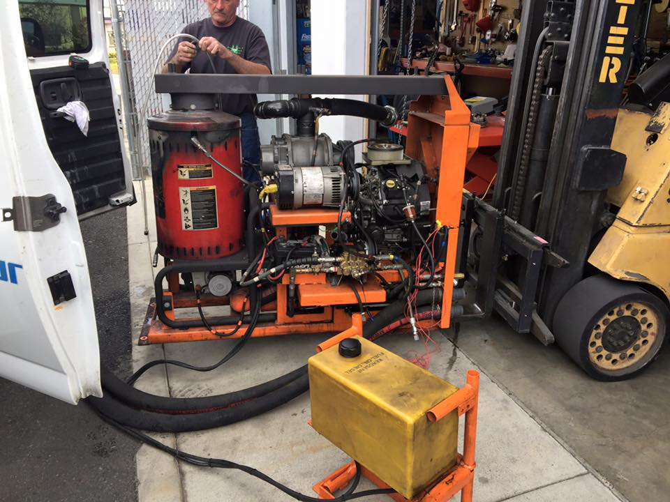

God damn it. The guy I bought it from didn’t mention a single thing about it. He knew I’m completely new to this and have never used a TM before and the dude runs an entire fleet, and when I asked him the steps to starting up and running the machine it was never mentioned. I’ve seen so many different machines on YouTube where they pull the choke out and push it back in after starting but there’s no clear indication of one on my machine, so I assumed it didn’t have one
Looking at a close up of your engine it says it is EFI. It won't have a choke or shouldn't need one. The necessary fuel/air mixture is managed by the computer. I think your back to a fuel issue or a faulty computer. Kohler has a diagnostic program for that engine. Your mechanic should be able to figure it out.

Alright I’m gonna test it out again and see if anything goes wrong. If it does I’ll bring all of this up to him and see if he can figure it out. Oh someone mentioned clogged filters too but he checked them all and said they were practically brand new

Another reason you’re hearing the boom booms could be some blockage in the engine exhaust. I don’t know how it could be blocked since it’s a newer machine, but it’s worth a try to look

That’s exactly what the dude that sold it to me said, that he doesn’t know how it could be having issues cause it’s still so new. That’s the reason we bought it too but oh well, it was still an amazing deal so we’ll just handle any issues that happen.
Thank you guys, I’ll come back to this with my mechanic if the issues keep up.

The fire breather has nothing to do with the engine trouble. Maybe you sucked in a rag like Mark? Fuel filter is where id check first, then pump, then spark plugs and wires. Don't just check the volts, check the amps too. 12 volts is meaningless without enough amperage. Make sure the pump, blower, and generator aren't bogging down the engine, which is unlikely if it ran for an hour with the mechanic. Check the air filter too. Its rarely a problem but can make it run too rich if theres not enough air for a proper air/fuel mixture on an efi.

The mechanic checked everything, that’s why I’m wondering what the hell is wrong. I guess I’ll just keep using it until the problem becomes more clear

Fuel pumps can run a while before getting hot and crapping out. It probably has a small filter screwed into it as well. Easy to check.
