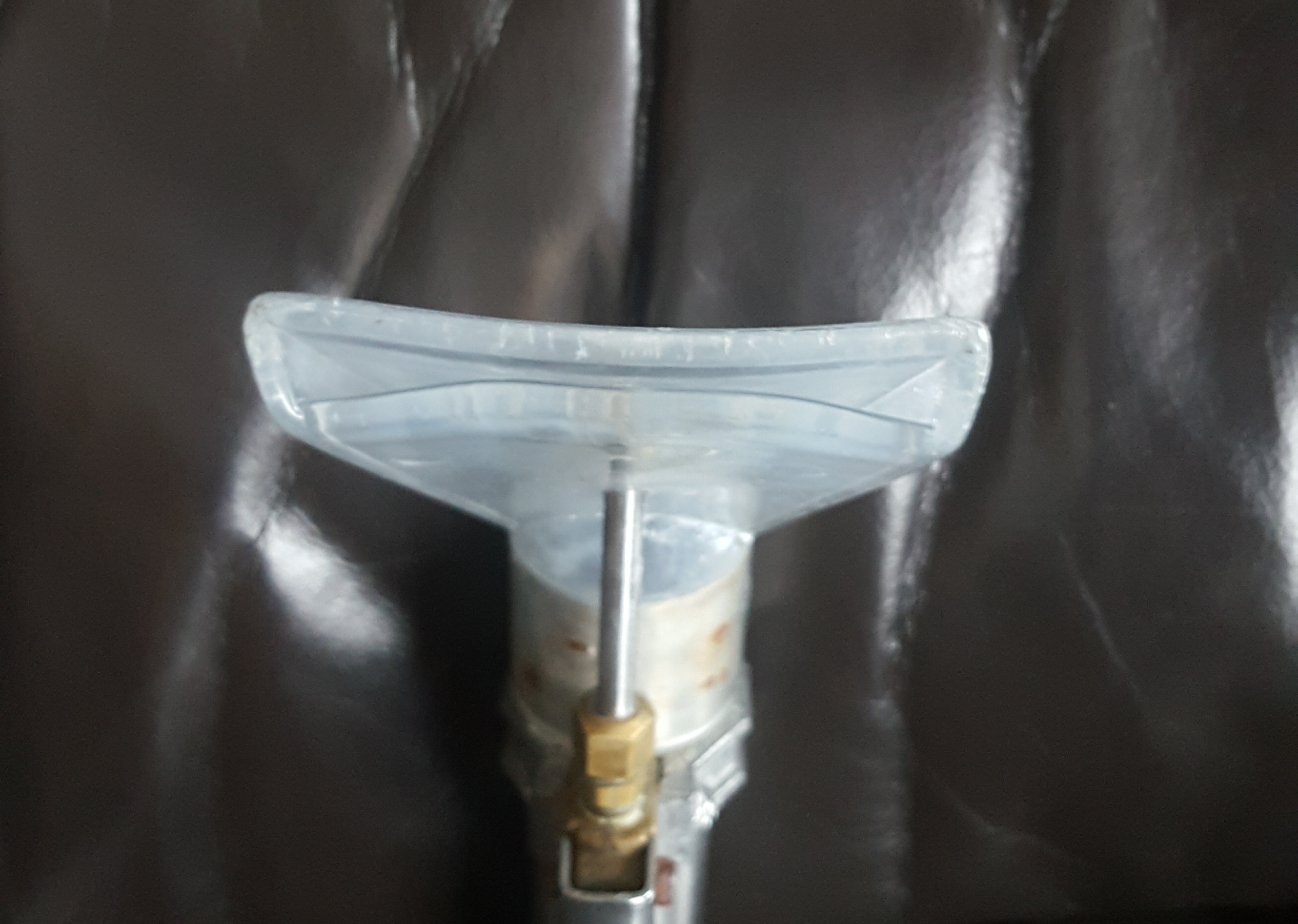

My Mastermatic would fire (growl) blue smoke, when water was flowing K1 was burning and Temperature was below setting on Thermostat. Enough water had to flow to make the ignitor ignite and heat water, that's why Steamway hand tools had a pin hole in the copper supply line encased in the vacuum hose.So water was always flowing. Cooling down the coil to a tolerance and then heating it up. Never had a problem with over heating.

You could also use a warm up/hot water hose just flowing on the ground so that you have hot water for the upholstery tool. Steamway had one real easy to make yourself I don't have one anymore maybe someone could share a picture.
Also You really need a manual and some lessons.
Steamway had "Henry" he could diagnose anything over the phone.
Henry and I had a close relationship. Usually weekly, between my Powermatic and my Mastermatic......especially the Mastermatic. Mine was one of the first MM's.
Great hot machines when running well, headaches when not.

Bob savage touched on it. There are different flow switches for different volumes to control on and off. It comes with a pressure washing high flow switch new because that is the industry the burner comes from and a carpet wand can just barely flow enough to make it go. But an upholstery tool doesn’t, so it actuates a safety and kills pressure. Get a lower flow “flow switch” in it.
this is easy to do
put a line splitter off your main water out connection
1 side feeds your main solution line
the other side is a short courtesy hose for mixing chems with hotwater, and left open a crack to discharge hotwater onto ground and keep water flowing
