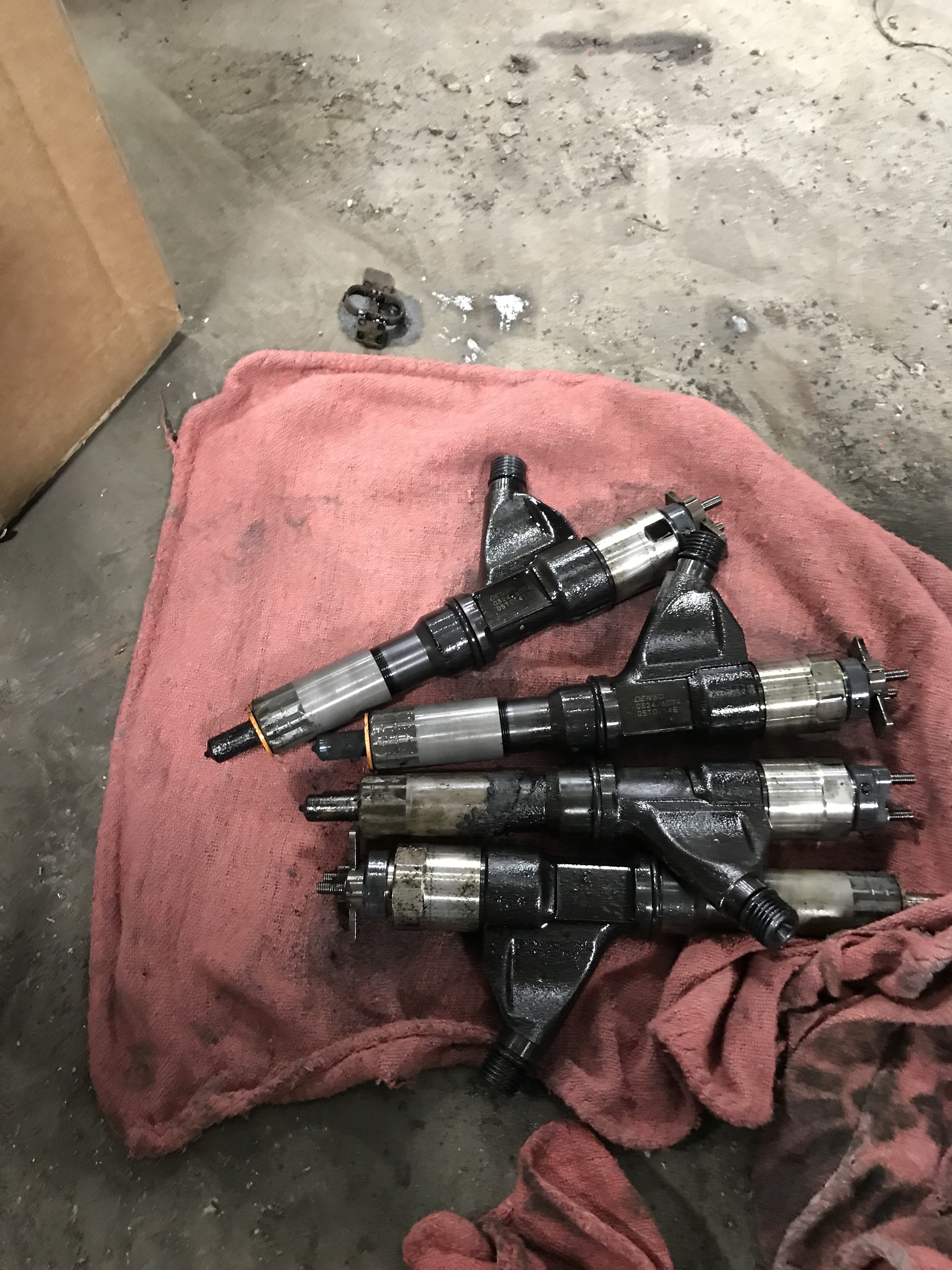

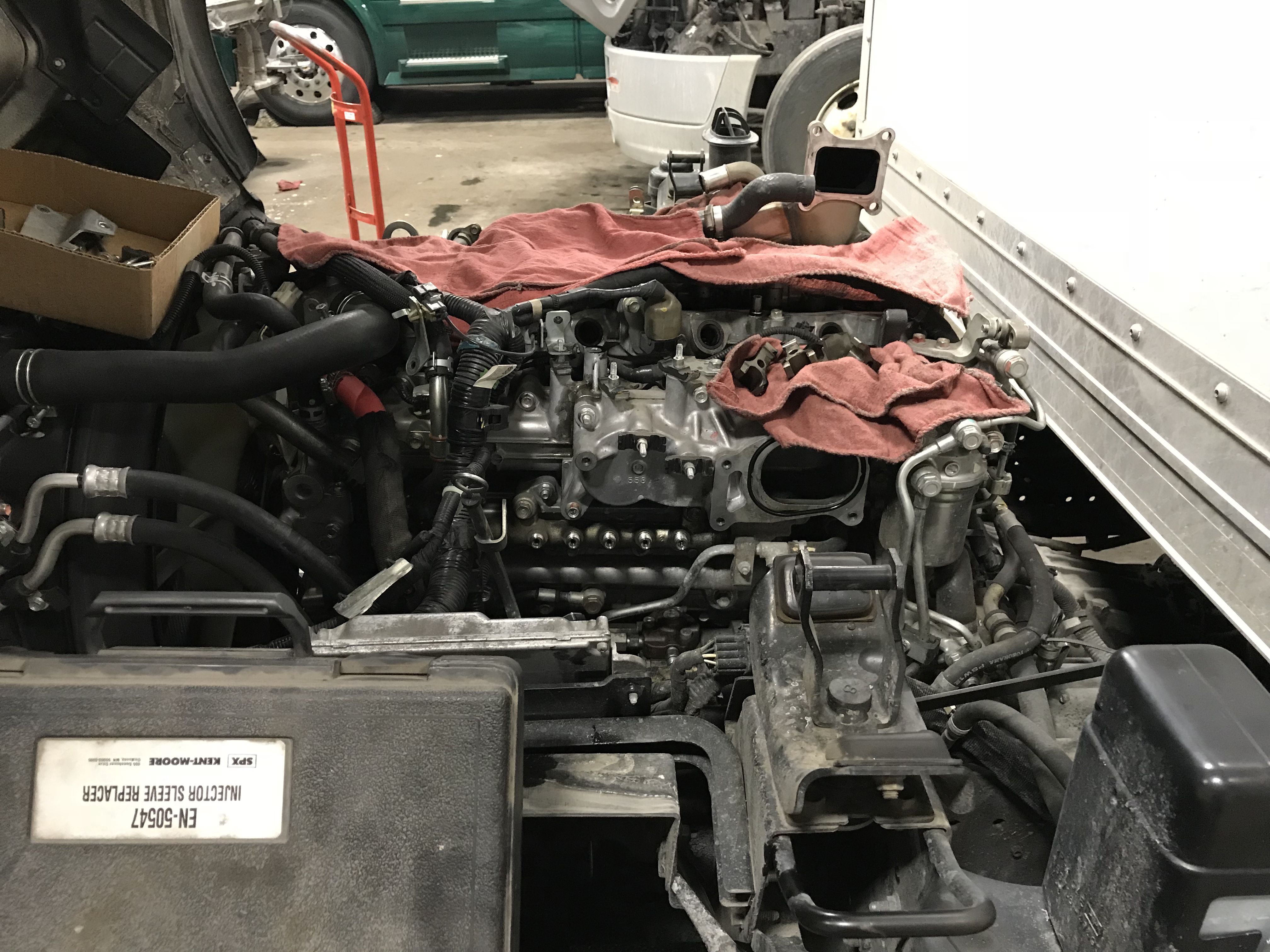

What fuel treatment product are you using if your are running V/ Aerotech. I have been hesitant to use it, but am on my third set of warranted injectors. Aerotech recommended Stanadyne, any other suggestions?
