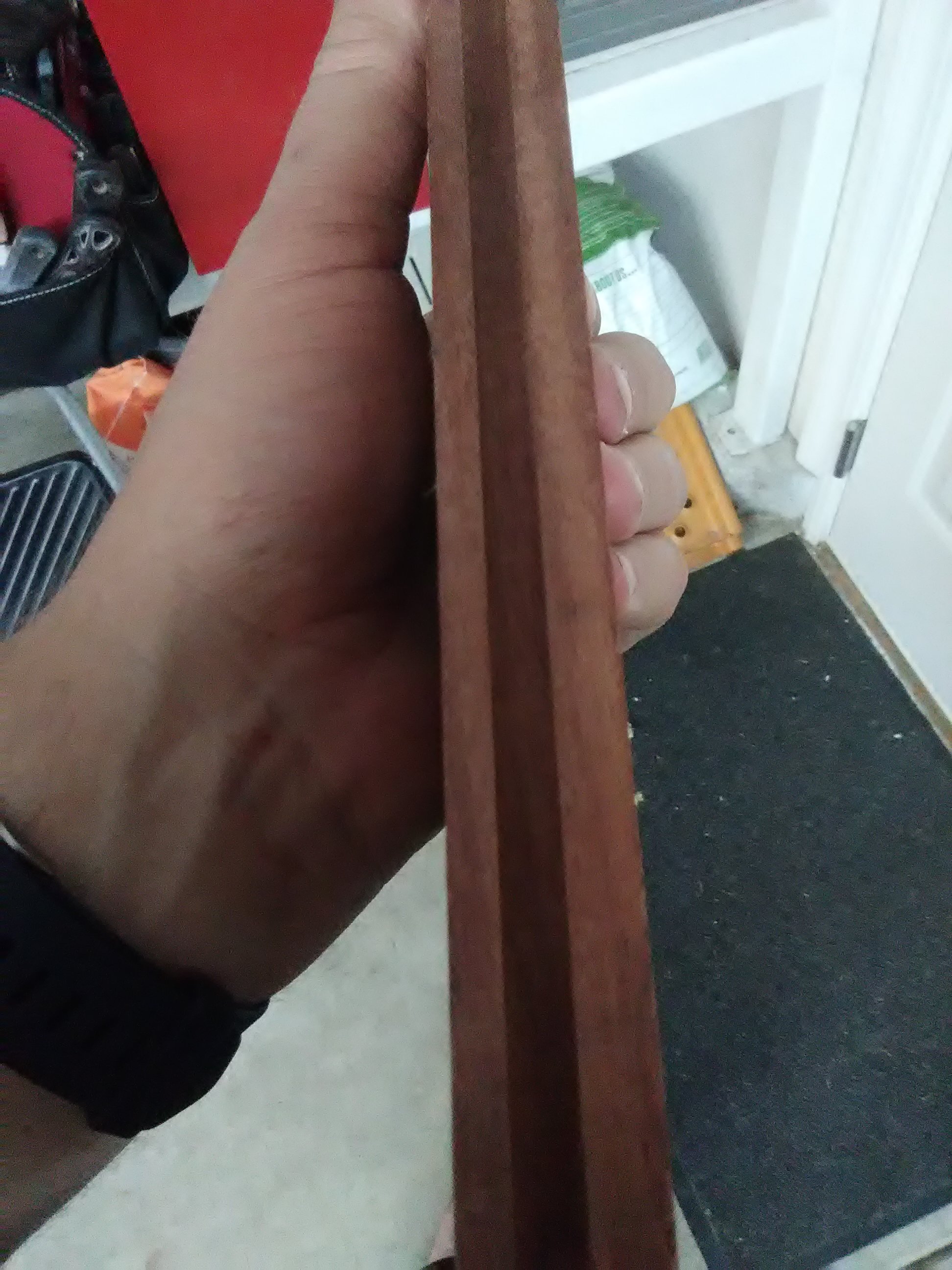

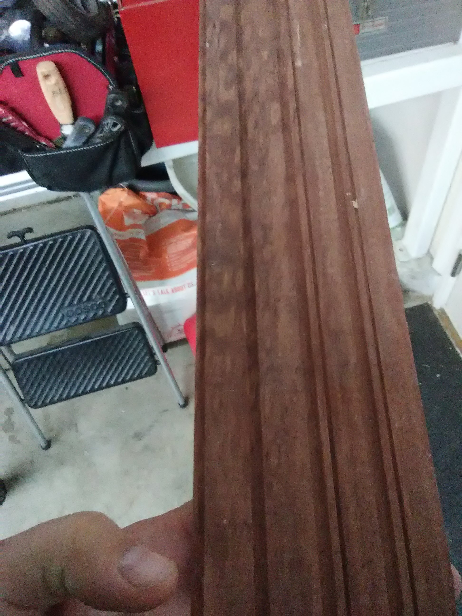

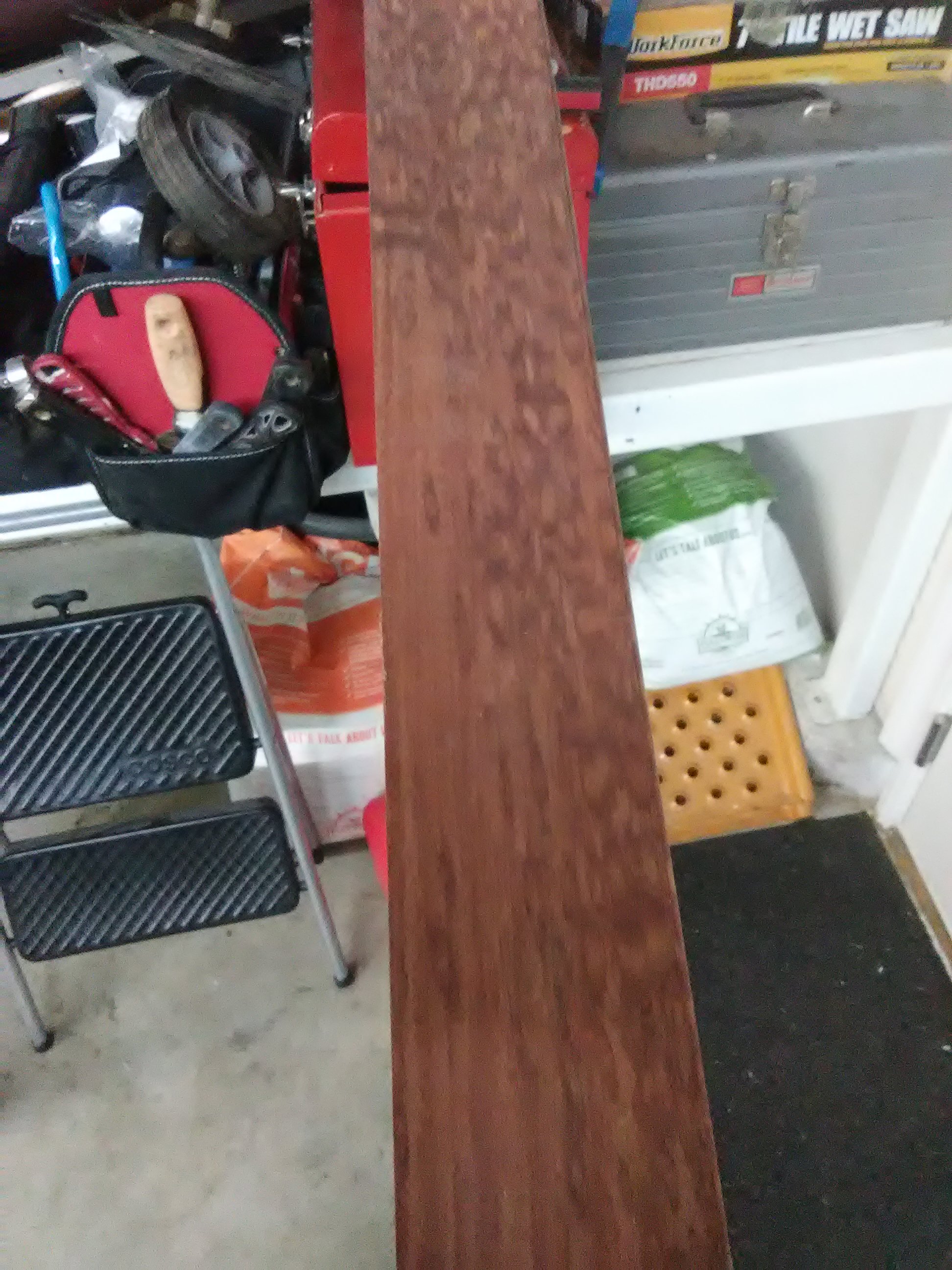

...natural color..
IMG_20200426_190017_01.jpgIMG_20200426_190019_01.jpgIMG_20200426_190024_01.jpgIMG_20200426_190026_01.jpg
natural....that's a good thing then
should take a couple hours to attempt repair.
I'd use a palm finish sander with a few different grit discs ..80 up to 220gt
you'll know in a short while of sanding whether just a light sanding will get it, or you have to sand to china to get it out .
in which case, I'd let them know when/if they look across the room from a ways, a "dip" may be noticeable

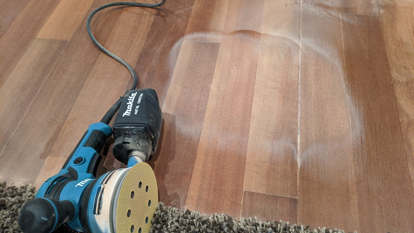

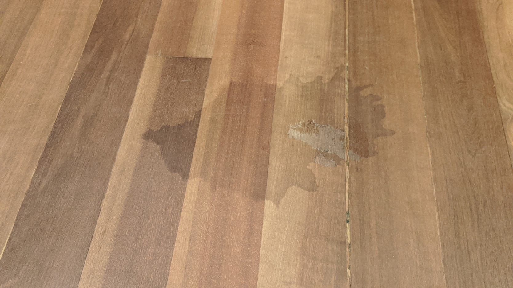

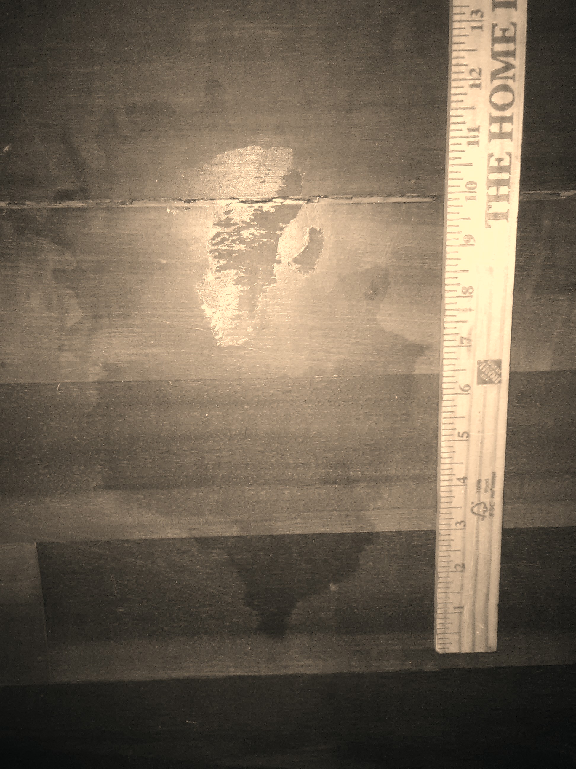

Today was the day.
My pic of the pee spot...
Full take down with 80 and 120..
I went on to a 220 patched a hold in the gap with some puddy and asked the guy to bring in the Bona finish and sure shit, all dried up..... derf....I asked him on the 1st phone call if there was enough to do the project....smh
Can't find anywhere local to buy it so now I get to go back after it comes from Amazon.
I forgot to take a pic of it all cleaned up with a nice feathur'd edge.
Damn thing was he requested an oil base be used but they send out the C team and the his knowing full with the C boys would have f'd up an Oil worse than they did this crap.
No Coastie, I didn't use your advice based on the fact that you don't watch my videos.
mEathed's advice made more sense since it was unstained wood.

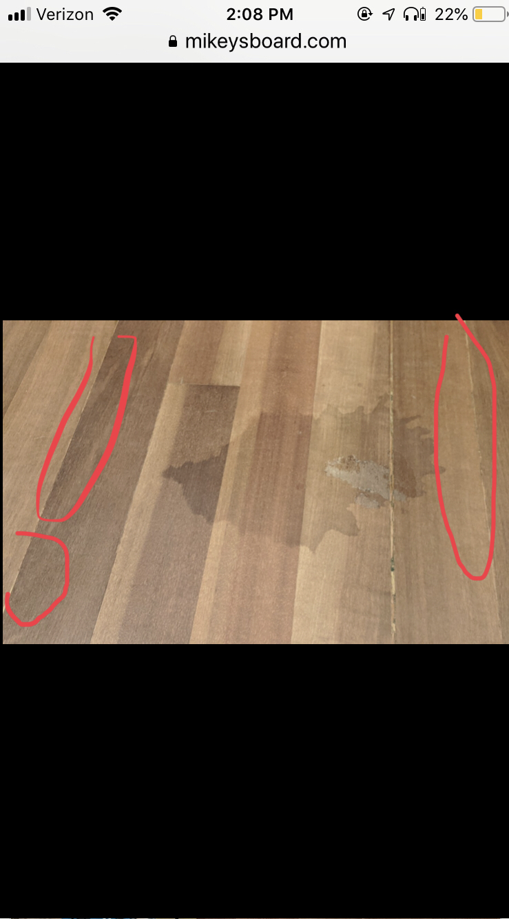

For a recent refinish that floor is trashed and looks like it’s peaked and opened in multiple areas
Fat Mike
Aug 1, 2017
2,832
Mike G
In AZ it’s a mandatory two year warranty on materials and labor. That’s jacked

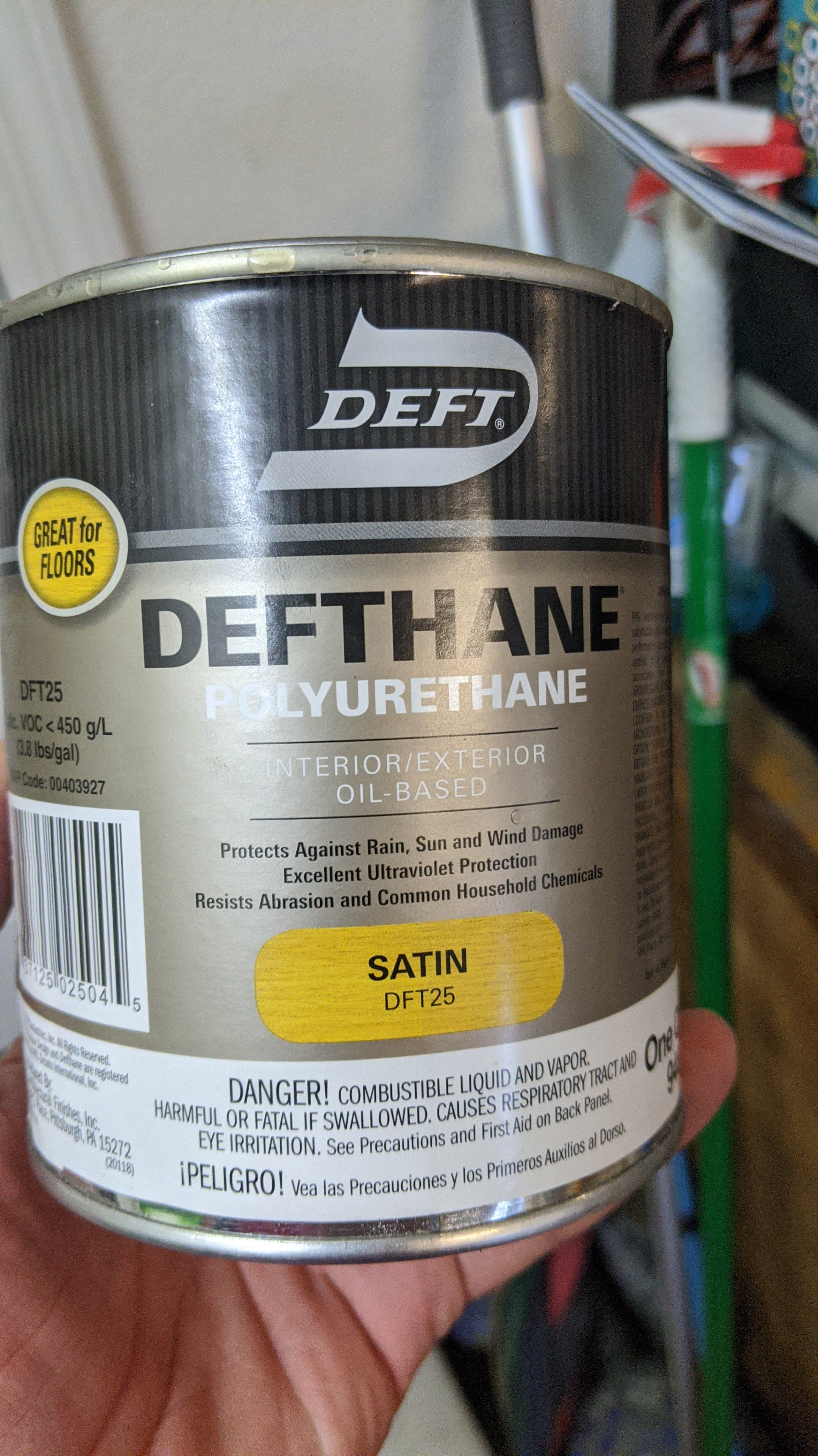

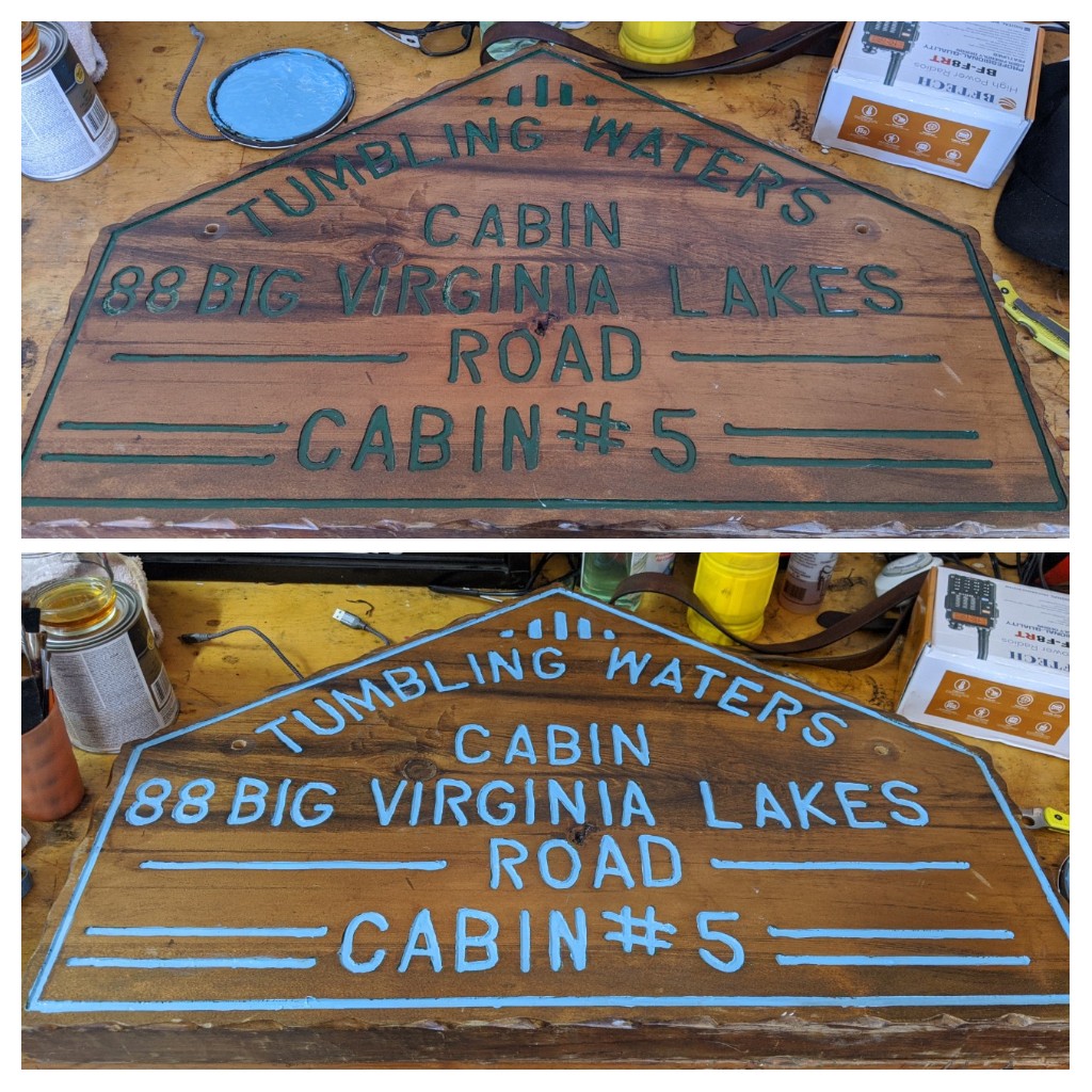

Question for an unrelated project how would you wood professionals imagine this stuff will work outside at high elevation during the spring summer and fall over painted wood...IMG_20200430_065151.jpg
steve_64
Aug 11, 2012
13,372
It will peel within a year.
I'm no expert and not familiar with that product but have never seen any polyurethane last very long.
I would stick with just the paint.
over painted wood
Deft makes top tier stuff
but why?
It may make the paint last a little longer, and can go over paint no problem, but don't think paint can go over urethane
.so when time to paint, you'll have more prep-work and need to cover urethane with bonding primer before painting again..or the paint won't stick worth a chit
is this for your cabin shutters and the other green(?) painted stuff?
what paint are you using now?
same as the $23 POS holster.....
if so, spend the dough for top quality paint like Sherwin Williams Duration or Emerald
Insist on contractor price, or wait for their 35% off "blue bucket" sales they have a few times a year.
Otherwise, you'll be paying $75+ a gallon for their best stuff instead of $40-$50 a gal
