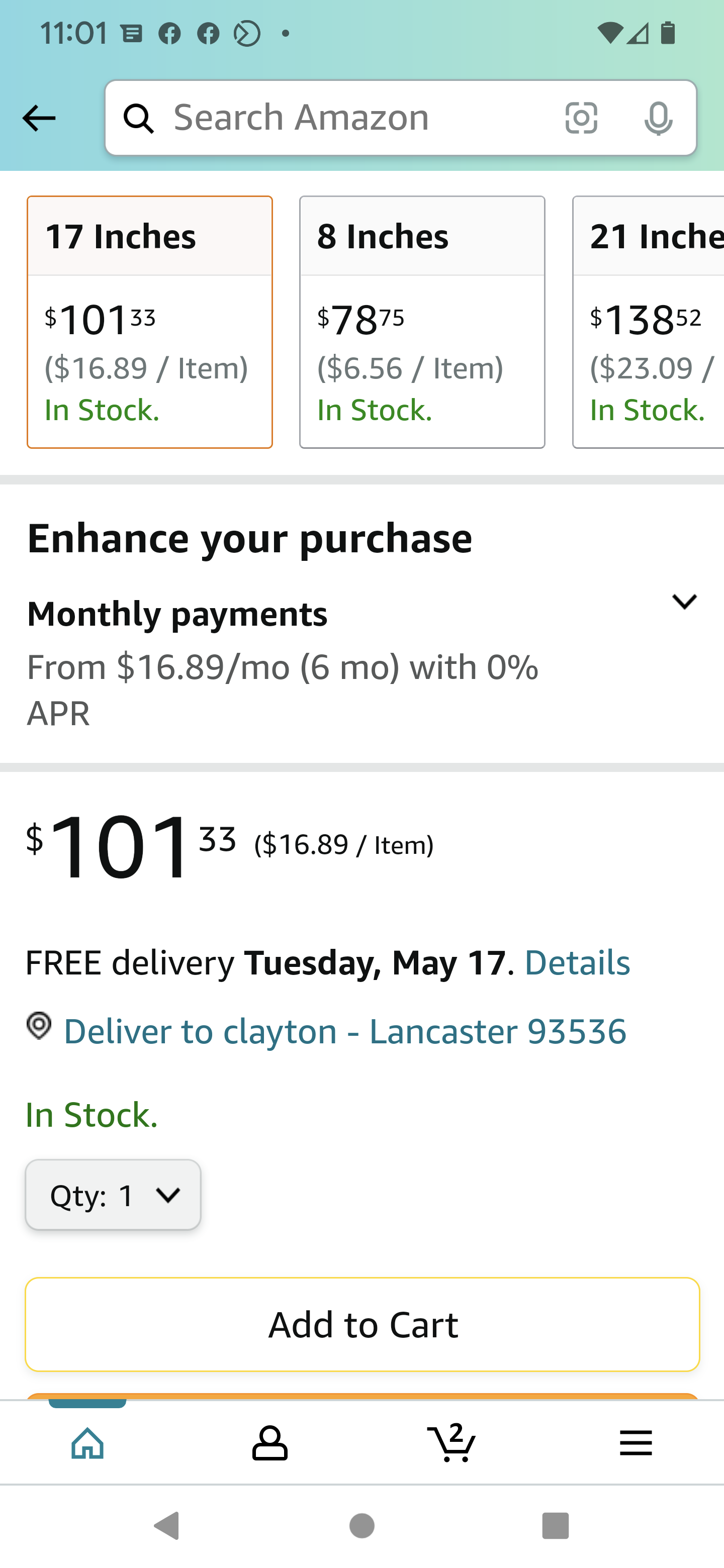

That says they are unavailable. I tried to order from Excellent Supply, but when I was at checkout, estimated shipping was àround $500.00 usd.
  • Wow
Reactions: SamIam and Nomad74

I was able to add it too cart
9,839
Naw, I just ordered a couple hundred plus. Haven’t ordered for summer yet.
Mar 29, 2008
9,738
Nate W.
Amazon ad say not available if you expand it
They seem to be back in stock.
It goes based on your address.. 48 states it'll send.. Hawaii unavailable.. If I use a friend's address in Las Vegas, it'll sell and ship..
I'm sure you being in Canada is the real issue.. When I search for things, a lot says unavailable but if it's a 48 state address, soo much more options show up.. It is what it is..
