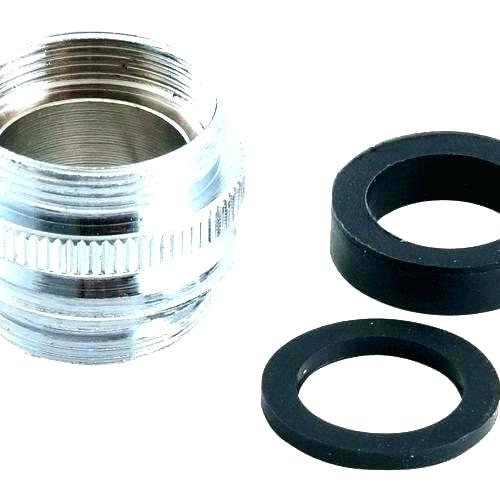

For you fresh tankless and porty goobers

Nice! buying it now. I was looking for something like that
28,280
It's not going to work on a lot of modern faucets. On those that it will, I agree with Lee.

My way is much safer. Get a supply line and connect a garden hose adapter to it. Turn off the water to the sink at the supply line...hot or cold side. Connect your supply line with hose connector and fill buckets if you are a porty hack or if you are Mark and almost out of water to your Butler...connect your Butler garden hose to your supply line. This literally takes 30 seconds to do.

I have heard of those squashing some fancy faucets.
It is true that many homes have gotten away from the older style aerator and adapters do not work for them. For those homes, it is often easiest to unscrew the shower head and use a rubber adapter with a hose clamp to secure it over the threaded part. I always then create a loop down into the tub or onto the floor to give drips somewhere safe to go.
