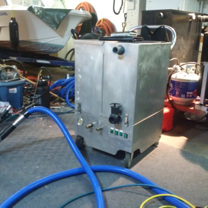

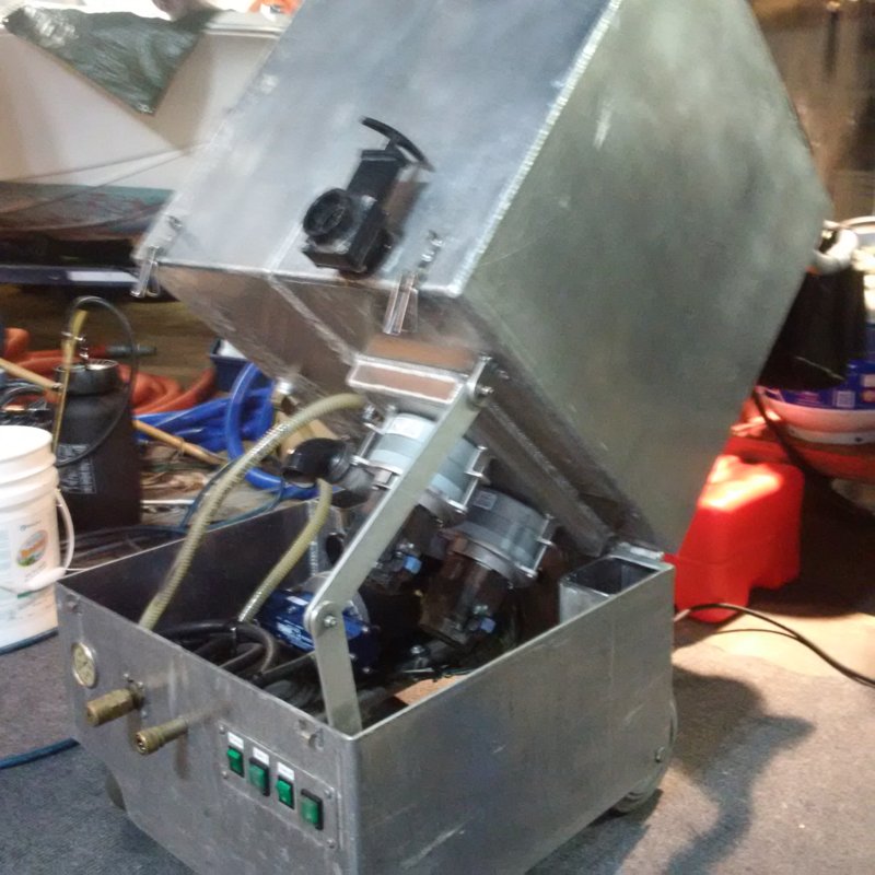

@Cleanworks Any Pictures of your 20/24 gallon machine? So in US gallons is that 25/30? Did you post pictures of it before? All aluminum?

There are other photos on mb as well some where. It's not that we're sensitive about portables, we just make our portables as powerful as possible so that we can give our customers as close to a truck mount experience as possible. It would be nice if the manufacturers would smarten up. For example, edic galaxy machines. Good machine, uses an optional external heater with it's own power cord, available in 10-17 gal units, high performance options. How about giving it 2 inch plumbing? How about adding autofill/autodump? How about when the autodump engages, it cuts out 1 vac motor so you don't blow a circuit breaker? You will feel the vac loss and wait for a minute or so until the machine pumps out then you can continue. The Mytee line up seems pretty good. They do use 2 inch plumbing but they try to combine everything on just 2 cords. Not possible and still maintain the right power. We use our 500 psi pump at 500 psi. The pressure is our agitation. I don't understand why people turn the pressure down to 300. 500 is not excessive, especially when you have heavily soiled carpets. My machine is powerful enough that I could put it in a van and with a heat source, could call it a etm but it would never be as powerful as a true truckmount, which is why I have a real truck mount. For situations where my my tm won't reach, I don't want to be using a substandard machine. after using my portable, going back to a basic ninja or edic is like spitting on the carpet and sucking it out with a straw

Ron, I think you said last time it is not as heavy as it looks. It is aluminum isn't it? What does it weigh? Great straight forward design. How is it at going up stairs?
