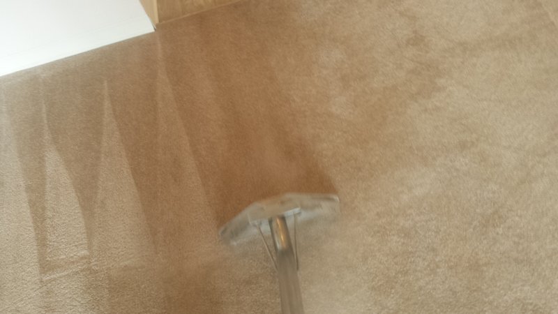

Pics from today. Did a job yesterday with no heat. Bleck!
Reactions: Mark Saiger

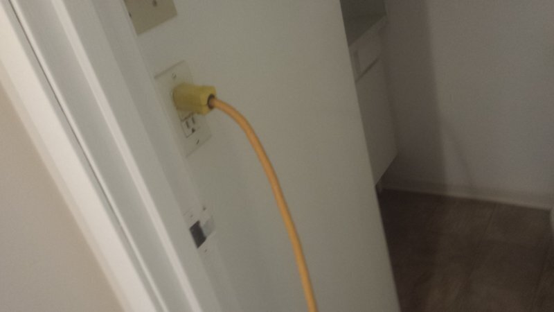

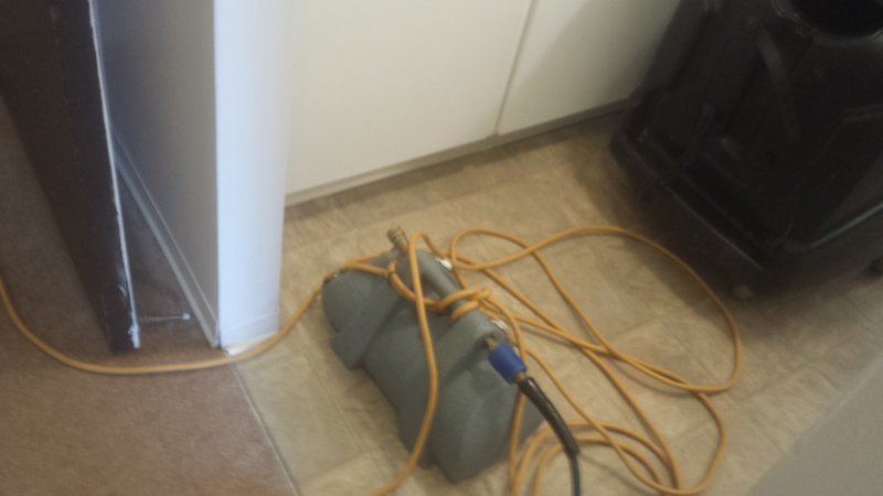

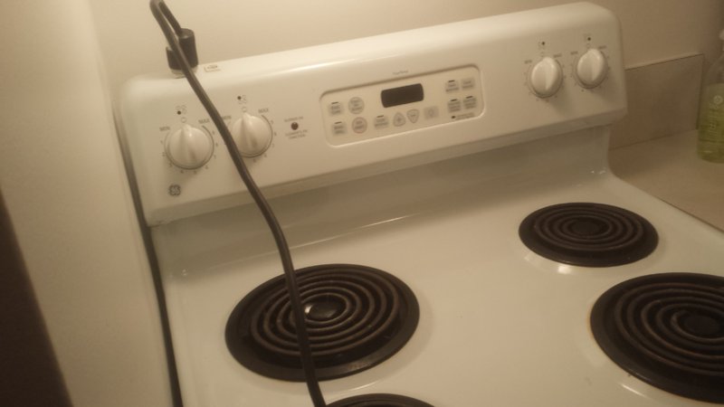

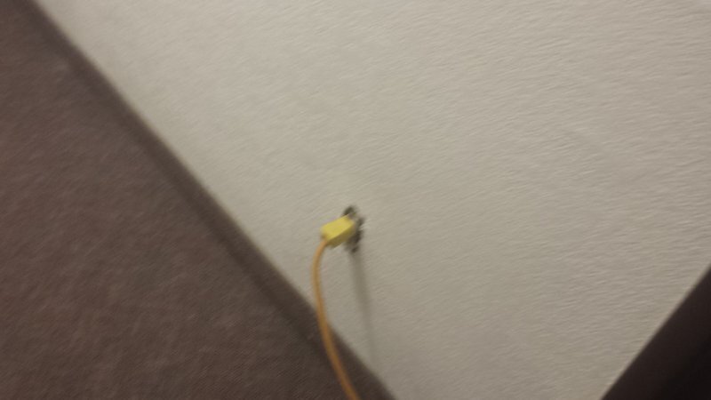

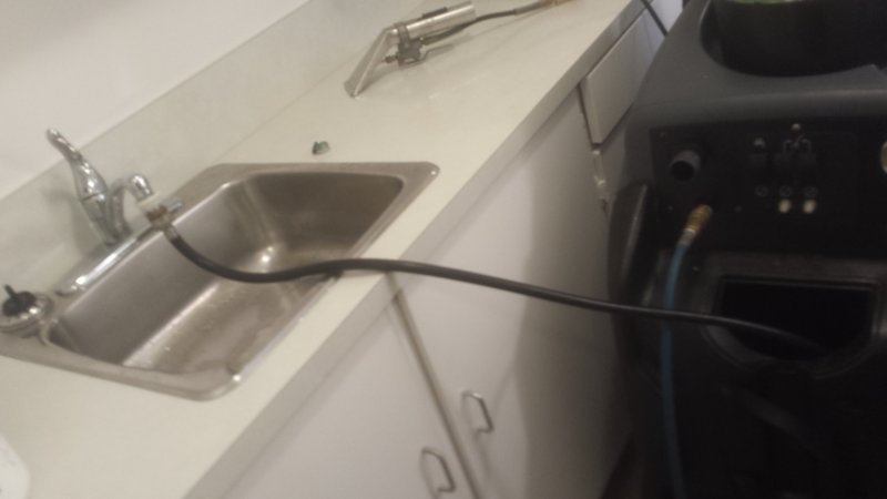

Willy P
1 - the stove outlet- dedicated 15 amp, the other cord was the counter plug.
2 - placing the heater in front of the machine clear of the work area. I pull excess cord out of the way.
3- heater plugged in the bathroom outlet and the other to the hall.
4 - filler hose. Still gotta hump the waste buckets. My glass is half full.
