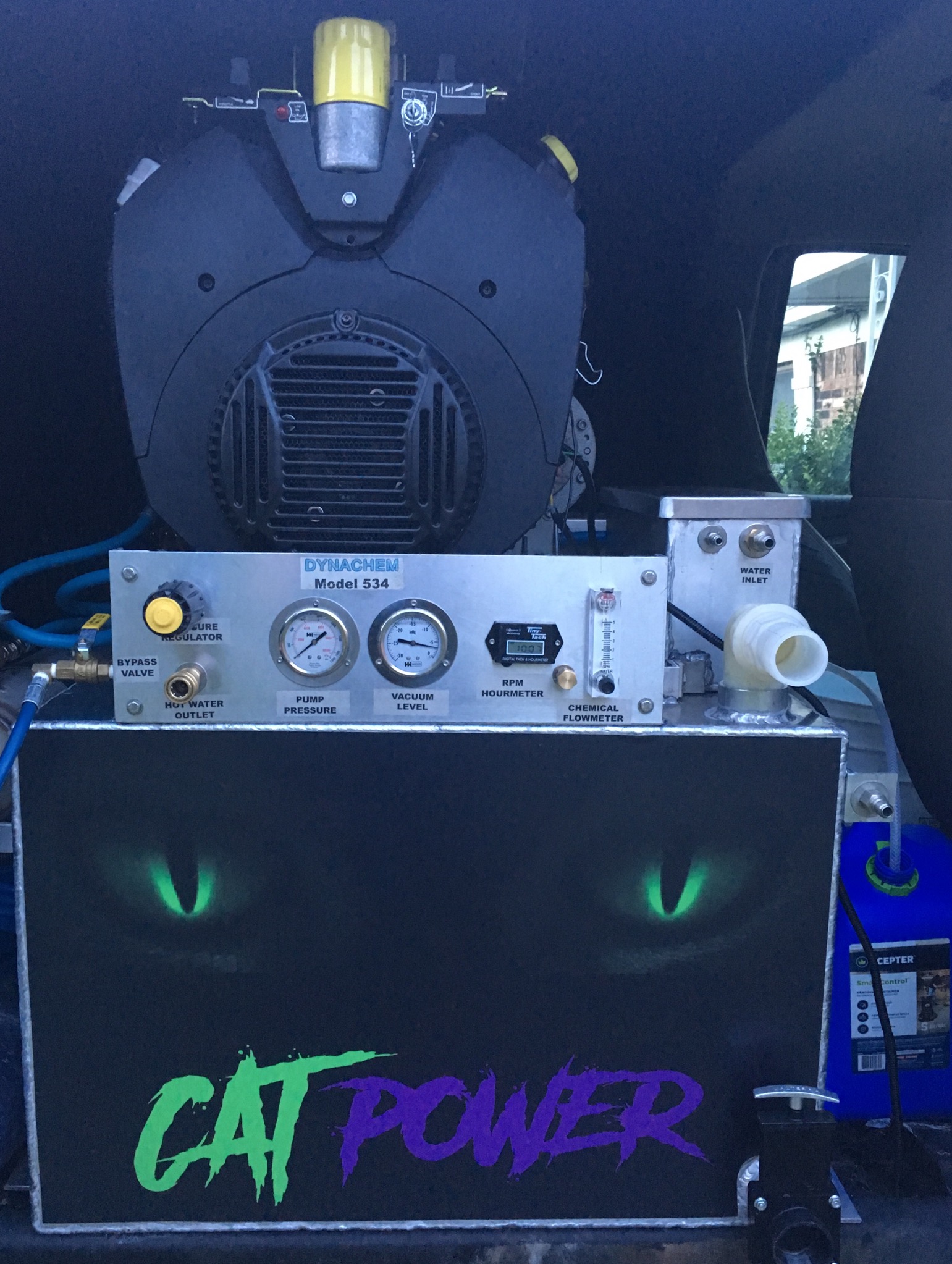

Got my new rig done!

These had all been great questions 🙄. But, is the oil filter upside down on top of the engine. How messy is that oil change? Or is there a feature that makes not look like a fondue fountain?

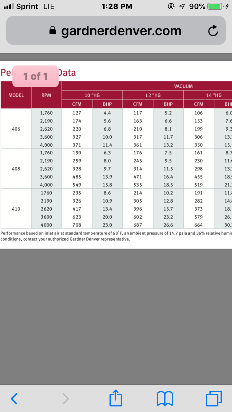

Bottom lines depending on rpm blower is spinning

Interesting ...
How does this compare to you guys with similar blowers from the big 3?
I have a CFI with a roots 36 and if I spin it all the way up to 3200 I only get 3 hg on the gauge. Curious how much resistance from the machine is normal/acceptable.

I believe the model number for that tri lobe is 410. It's the biggest one they have on the performance sheet for the Gardner Denver tri lobes. The 650 is probably just an advertising number for cfm.
Correct it’s a 4:10 blower also 650 is probably with a larger opening then the spec sheet

You also notice that as the inches climb, the CFM goes down. I don't think there is any advantage to increasing the lift beyond 13 or 14. Maybe if you're running 300 ft plus hose lengths or dual Wanding.

Actually its way less messy than the typical side mount. All the oil drains back down into the crankcase. So when you take it off its empty.

I love it. about to hit around 103 hrs. So far zero complaints. Great suction and heat is amazing. I already did the first recommended maintenece. Super easy. Love the oil filter location. All the oil drains down into the crankcase so no mess. oil drain hose is nice and long has a valve on the end. Just pull it out and take of a simple cap open the valve and put it in your drain bucket. New oil and filter greased the blower. Done! It's no looker but it just works.
