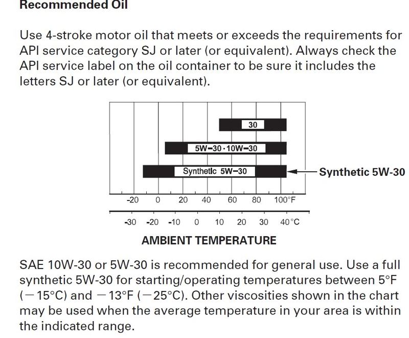

Joey, your TCS chief has a Honda GX690, right? The manual I downloaded from Honda for the GX690 seems to allow several different choices depending on ambient temp (typical for most small engines):
Your manual doesn't have this table? Curious.

My honda owners manual does have this............. So I have been using 10-w30 like it says... But like I said my TM manual says HD-30, because of the heat I suppose.

Oops, I must be dyslexic. I read your post exactly backwards. Carry on!
