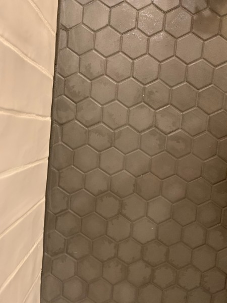

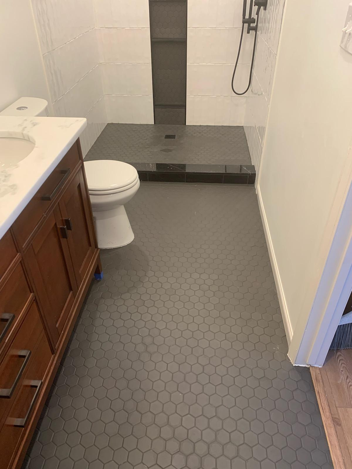

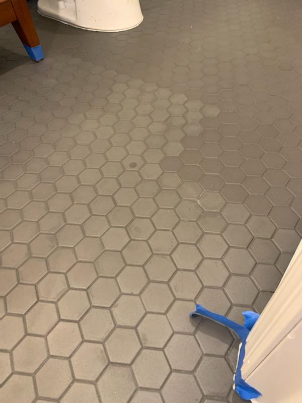

Interior designer picks an unglazed porcelain for a master bath floor and shower stall.
Homeowner decides she does not like the color of the grout so she applies a color seal.
During the removal of the excess color seal, a coating of sorts comes off the "unglazed" porcelain...
In the photo below, the dark irregular rings around each tile were created by just water when it dried. Up top you can see some remains of the coating.
The manufacture, designer and install all have been zero help.

and you sure that isn't epoxy grout haze/residue?
or a sealer they applied?
*I'd expect it to end darker.........and not be so even...but

Water stains it now that the glaze on her unglazed porcelain got removed by an acid.
let that sink in.
yep, this lady is a pharm rep and on her game.
let that sink in.
I'm having a hard time seeing the relevance of her being a pharm rep....
an acid like epoxy grout haze remover?
Does water stain it? Or does it just become trapped under whatever is left there?
She used Grout Haze remover, not Epoxy Grout Haze remover.
most every consumer tub and tile cleaner and maintainer is on the acid side.
well....I'm no expert......but before I ripped up that floor I'd do a proper haze/coating strip

so it'll be even more absorbent?
and F up her colorseal.
Surely it wouldn't F it up any more than tearing the tile out.
I also doubt it would be more absorbent.........I think there is more going on there.
Fred she's going to tear this out and put in a glazed ceramic.
