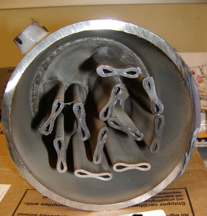

HMMMM What happened here?? Cut open Heat exchanger pics

I always thought pipes expand and bust when frozen. What caused these to collapse?

I get that Jim, but when water freezes it will expand. I would have expected that to be the case with a frozen exchanger.

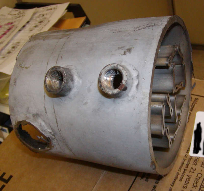

What happened was the water encompases the inner portion of the large outer diameter tube around the smaller tubes that the engine exhaust travels through. The unit froze, the water/ice expanded, crushed the inside tubing AND expanded the outer 1/4" thick SS outer tube by almost 1/2". This unit must have been soo cold that it was frozen solid.
When water freezes in a closed chamber, it expands and has to go somewhere.

The collapsed tubes look very uniform, I wouldn't expect that. Did a small leak cause the exchanger to fill, then when that froze it collapsed the tubes?

The bizarre thing is that the heat exchanger is the only item that broke as far as we know. :roll: I can only assume that hoses and brass parts are going to prematurely break from the stress. What a mess. :cry:

Was this just one overnight freeze, or more? I would expect it to take at least 2 or 3 freeze/thaw cycles to collapse the inner tubes that much.
