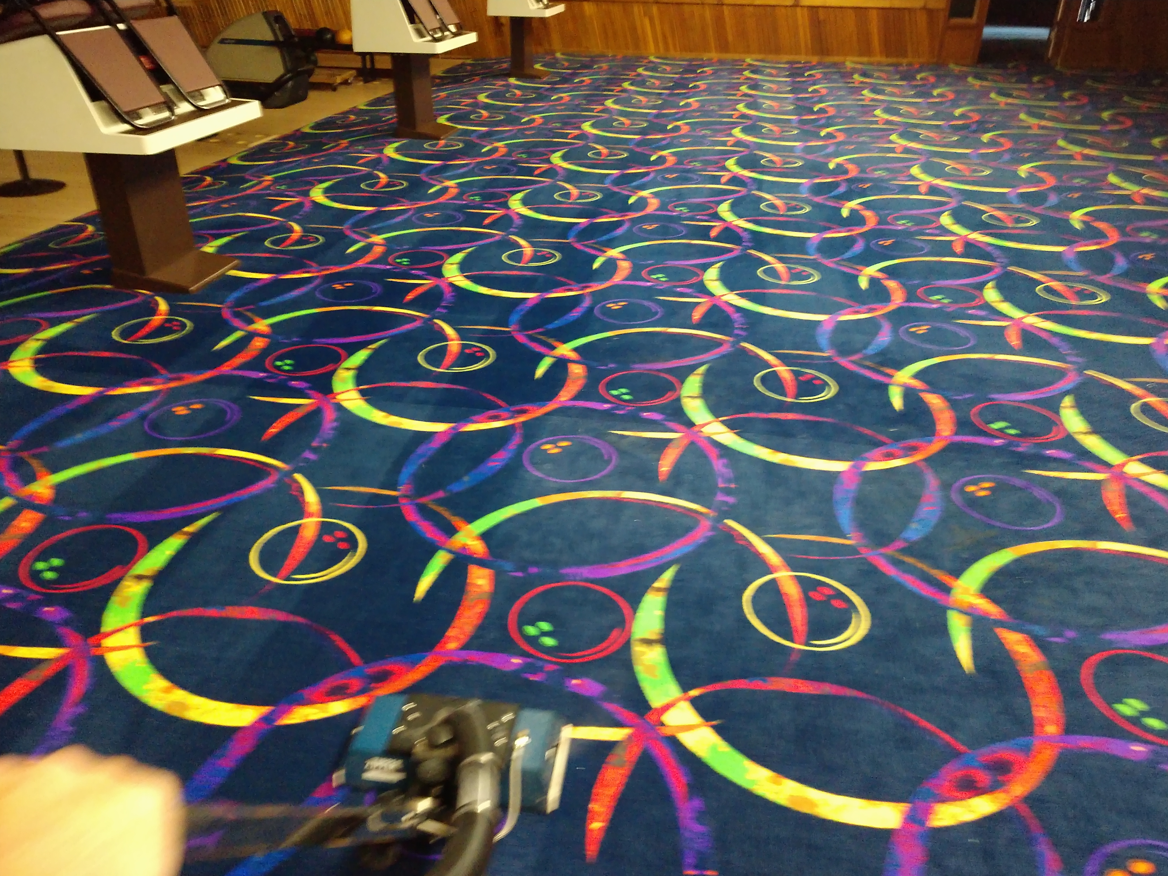

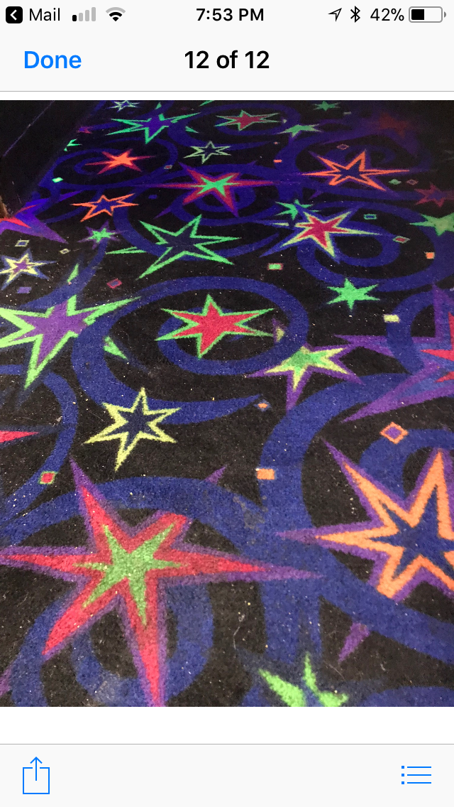

I really hoping someone has a good suggestion on how to clean glow in the dark carpet. I don’t know if the ‘print’ was painted on, or done chemically. I was thinking Cimex, but am afraid the combo of agitation and chems might ruin it. I was thinking of just using a water prespray, and clean rinse at cool temps. Any ideas?
And no, I have no more info than that.
I guess I could just try a method, and see what works best... 87043
