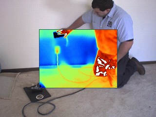

As far as thermals you don't have to start out with one but if you can afford it they will help in identifying what is when when you have multi-floor losses and other difficult to diagnose losses. Check ebay or ask Lockhart and see if he has one to sell, maybe you can spend the same money but get a upgrade in camera.

I agree having the right tools like an IR camera opens many doors and sells many jobs for you. It's not needed on smaller work but anything where water comes from above or multiple floors or commercial work it's really valuable.

Thermal imaging cameras pay for themselves between discovering additional water (money) plus covering your butt. Plus they are neat toys. (You know you want one so just buy it- they are so much cheaper now anyway.)
