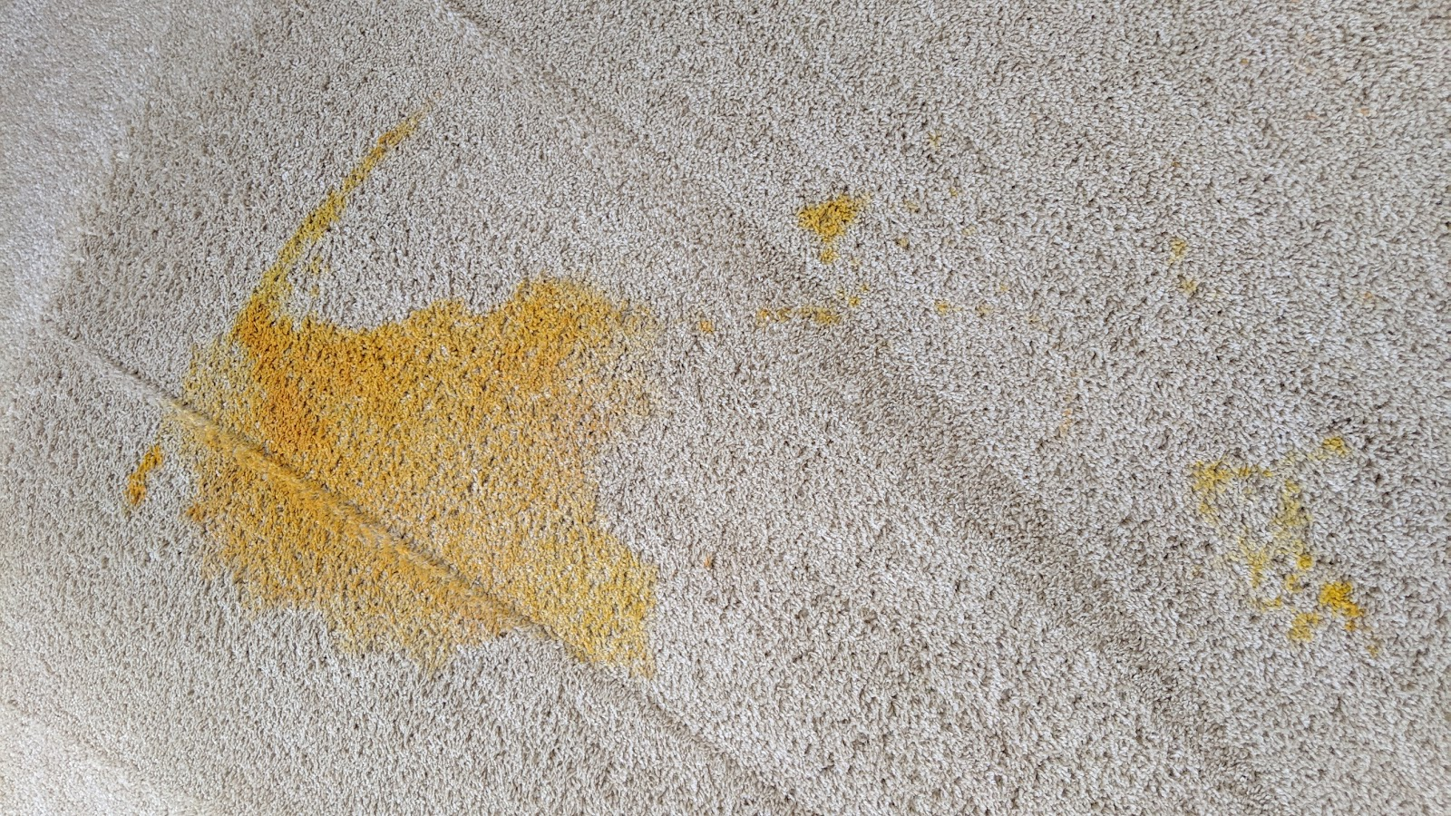

This is the stain untouched by me, her sister used some Folex on the lighter, smaller areas at 5 o'clock to no avail

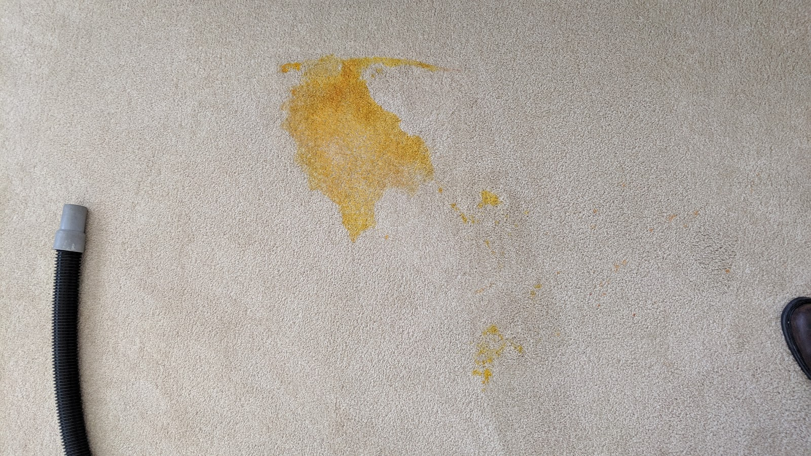

This is after just water rinsing to remove as much pee pee as possible
To be honest I'm not sure wtf the fiber is, it's one of those that gets very dark when wet and the wand really grabs. You'd think it was wool, but it has that oily feel and no wet hair odor..

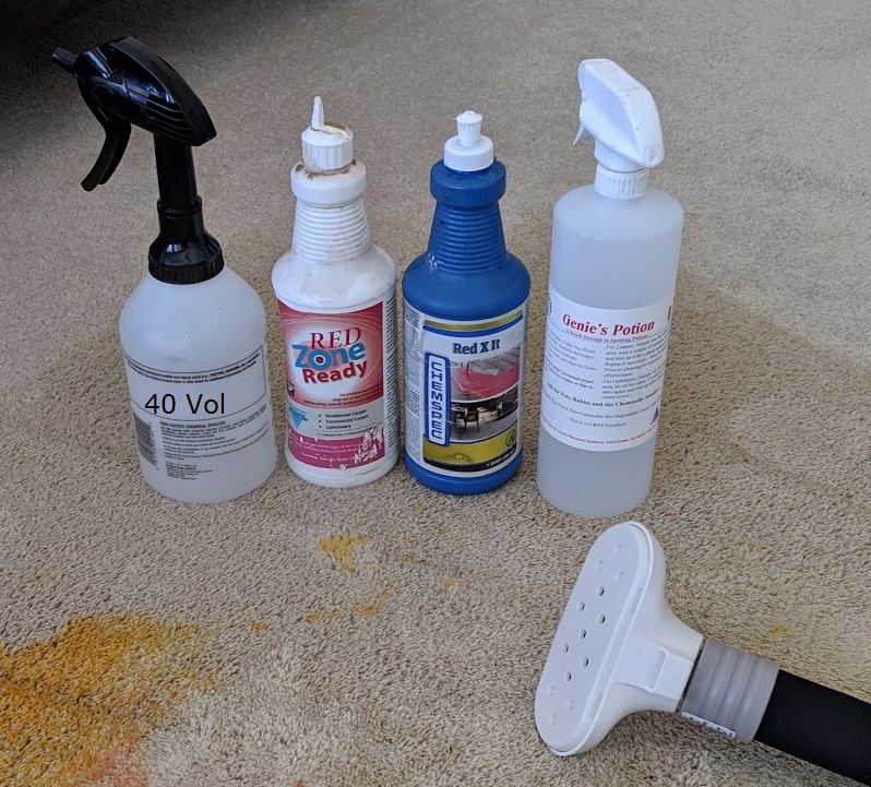

First I tried 40 vol and dwell time...
nada
Then I used some steam and 40...
nada
Rinsed and tried Genie Magic and heat
nada
Then Red Zone and dwell
nada
Red Zone and Heat was then tried but it was super slow and one quart would not have been enough..

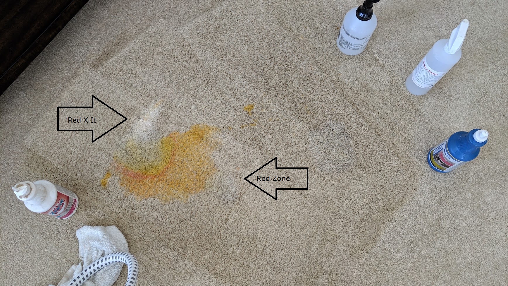

So I tried the RedX it, which says on the bottle to use heat and almost instantly the carpet turned snow white. :icon_neutral:
But to be fair, the carpet turned a pinkish hue around the Red Zone'd areas.

I told her up front color loss was a serious risk when using heat and "dumb" dye removers that don't know which dye is which, but we both agreed what do you have to lose.
She hates the color and will veto hubby for new carpet but I left them a repair guy's number.
