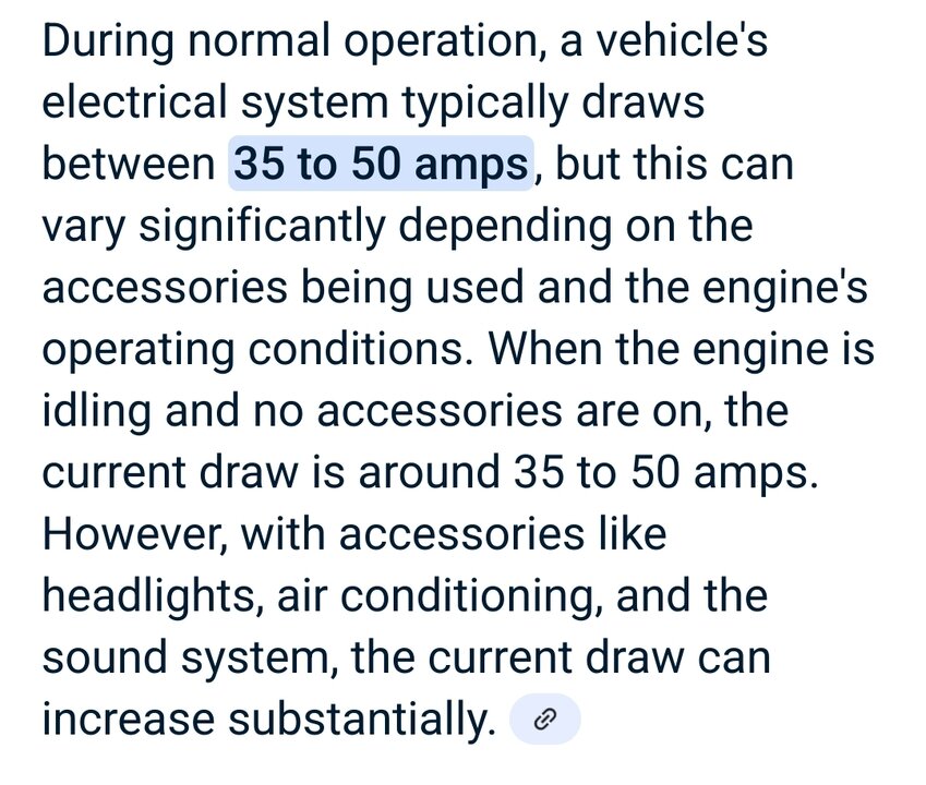

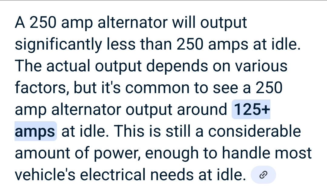

Do you mean it has a 250 amp alternator? Tell us what the actual amperage output at idle is. 250 amp alternators put out around 125 amps at idle, and your vehicle is consuming about 50 of those amps while running........
Why are you so hung up on a huge alternator??? You gunna power up the ho

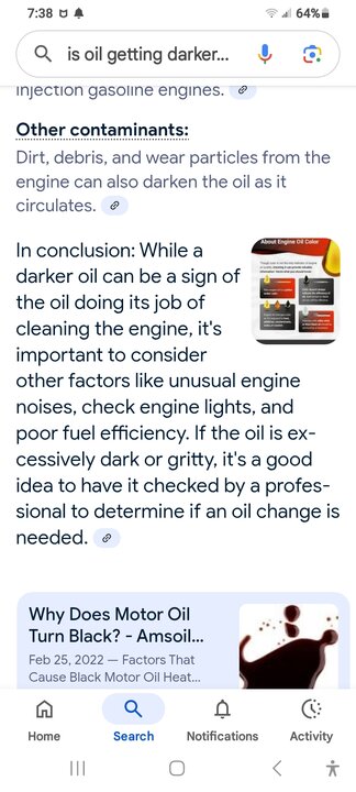

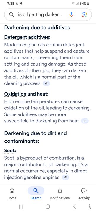

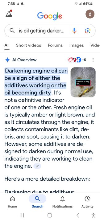

I'm always concerned when I see motor oil getting significantly darker. If it is high quality synthetic oil and you're only 3k in since the last oil change but the oil is quite dark compared to new... still fine to wait until 5k to change it?
Oil changes color partly as a chemical reaction to the detergents and additives working more than being dirty
Screenshot_20250806_193825_Google.jpg Screenshot_20250806_193834_Google.jpg Screenshot_20250806_193850_Google.jpg

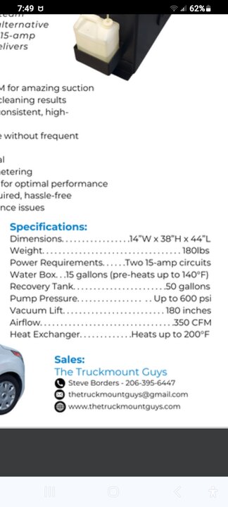

Regarding this Hydroclean electric tm? If he's not running a generator, or plugging into shore power from a home or business.. the power to run electric vacuums, pumps, and more has to come from somewhere.
I don't know anything about that machine except what the information sheet says and it says it requires 2-15a home circuits in addition to the van so im assuming that its a portable mounted in a van and possibly using some sort of a heat exchanger
