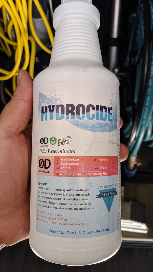

I got my 1st M@rine redo..
117,345
the Poly pile still stinks of urine...
I UV'd it and recommended replacement but time and budget didn't allow.
all the carpet is upstairs and as you know I'm not a believer in Water Clawing anyways so I soaked it down good with UE and an Oxy/Enzyme Pod and flushed it good but not good enough for the new family..
I blew it and didn't use a urine specific product so now I get to go back and redo it (for $300, due to my minty fresh breath)
I have some Hydrocide and Saigercide on hand..
@Nomad74 and @hogjowl how wouuld you two pisspros deal with it?

SSS carpet sanitizer...........add it to your prespray.
Or stand alone
Jimmy L
15,253
Jimmy L
It's a quat carpet cleaner use it either as a prespray/extraction rinse or bonnet clean with it. $15 a gallon.
2 oz per gallon.
It's my secret!
SHHHHHHH!
Don't tell anyone!
50,041
P-Sor prespray with 30 minute dwell
Rinse extract
Post spray with P-Sor and rake it in

either one of those 2 products should work if they make contact with the source.. you got more bottles than in your hand?
Andy
Feb 5, 2016
970
Doesn't Matter
Use the best prespray you have boost it extra with an oxy, let dwell. Think of it this way what creates the smell in urine? bacteria. What kills bacteria? peroxide. Rinse with an acid or neutral cleaner. spray your deodorizer when you are done.

if you dont have the "chems" prespray acid rinse heavy give some dwell and extract as you've already cleaned it

In theory, that would rinse urine salts from the pile but we're all more concerned about whats a bit deeper...
whatever you use has to make contact
its not so much rinsing urine out its pH adjustment of whats there so it doesnt smell
spray heavy and extract... your dry times will suck
14,641
Mikey, your ph wasn't low enough on that hydrocide. Do you have an acid rinse of a ph around 2-3? Just use that diluted at 4:1.

Add 2 cups of Hydrocide per gallon of V-40.
Soak each spot with a pump up, USING A UV LIGHT, to make sure you get the complete spot.
I also add 1 cup of deodorizer to each gallon.
Set up, clean as usual....
