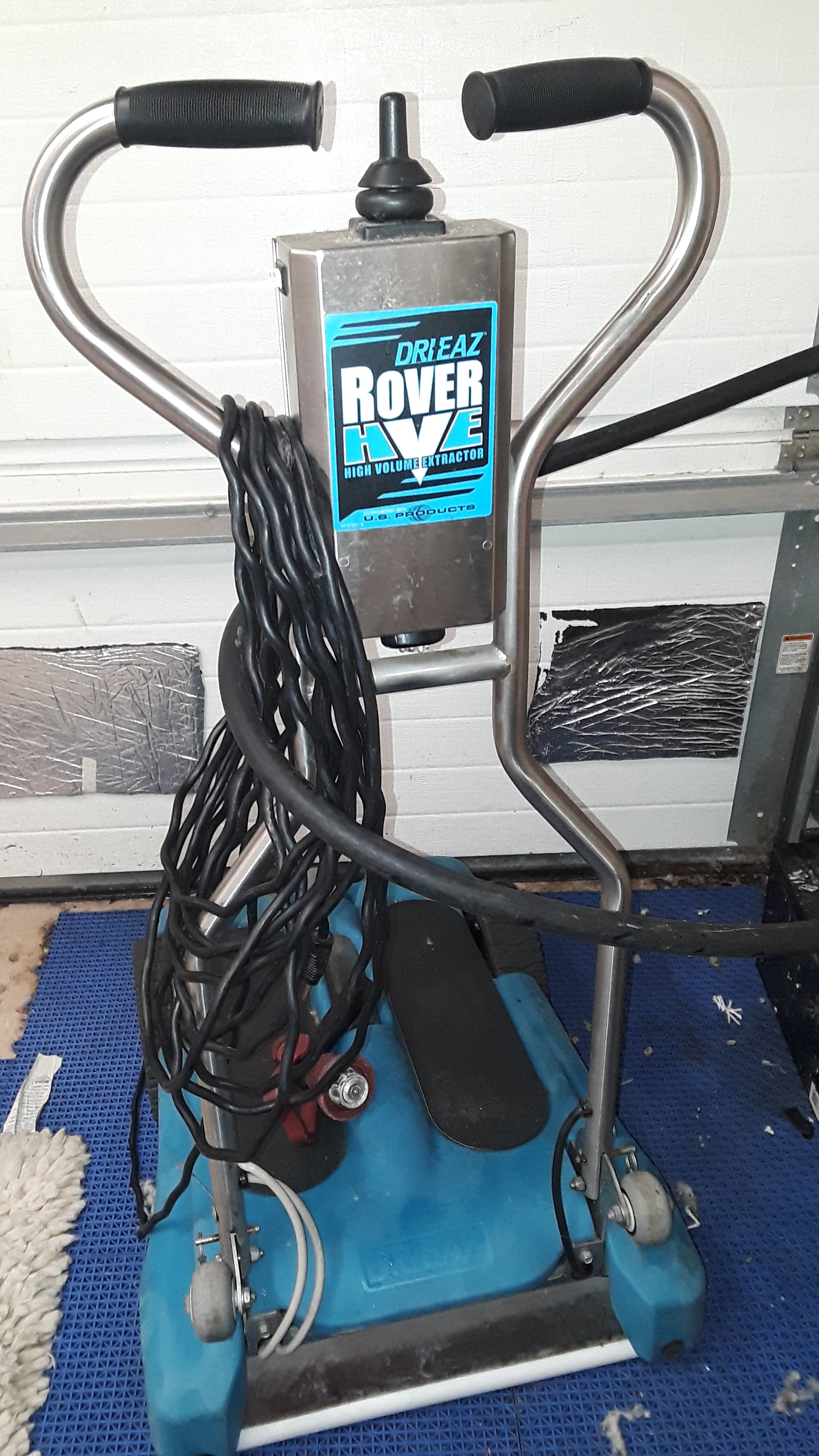

Lots of COLD water, a Cimex, An 1800 psi pressure washer, a garden hose and nozzle. An extractor of your choice-- since you don't like mine.
a dri Eze Rover. Pro'd choice HD odor kill or Centrium force U-Turn. I tend to use a citrus prespray for soil suspension

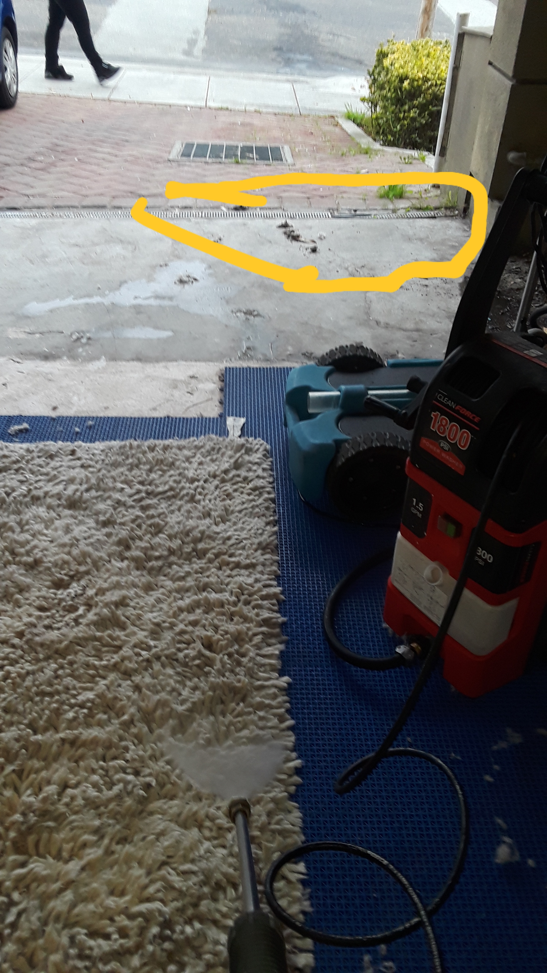

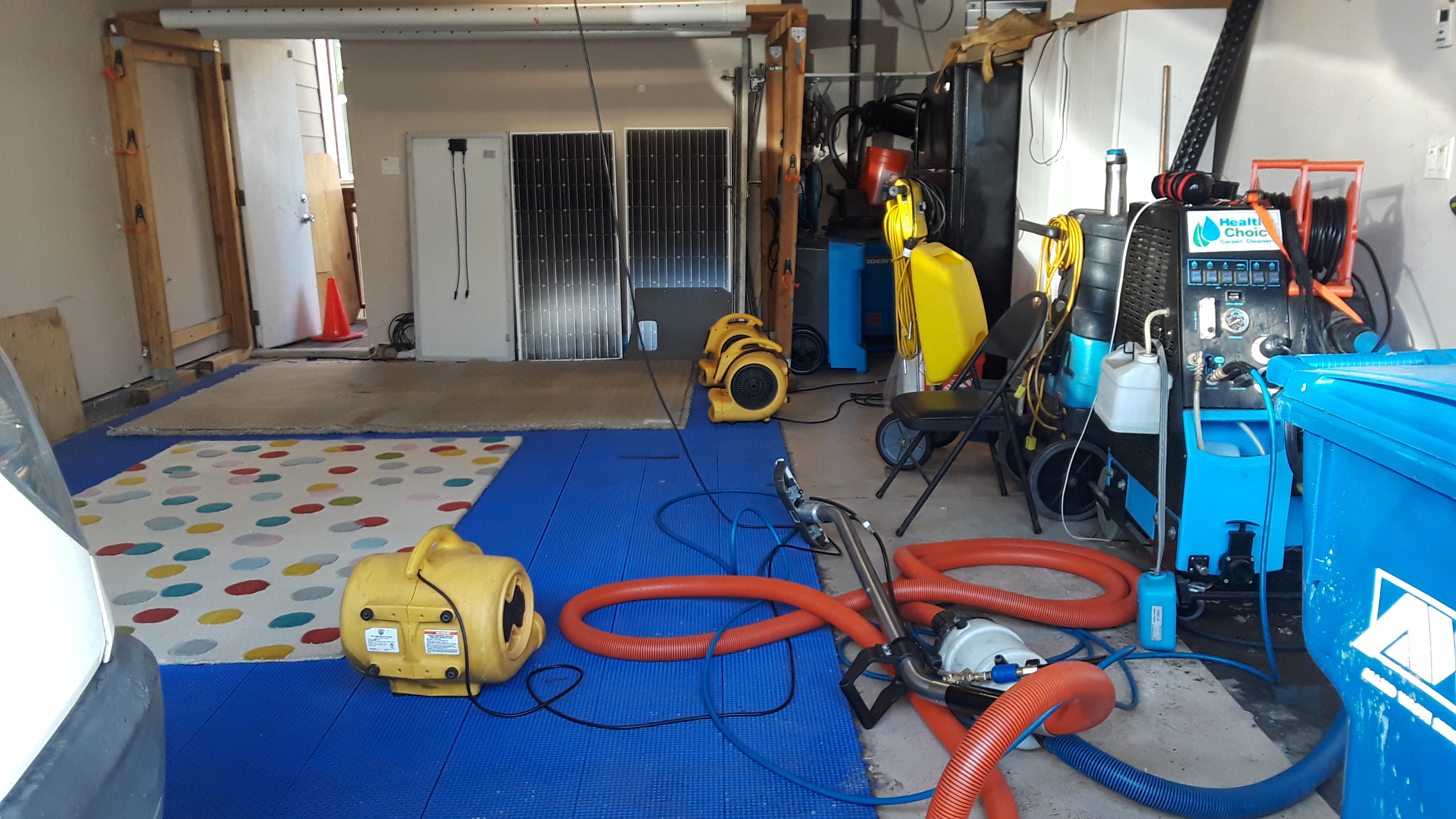

esplain how you are pressure washing in a room like that, please
The yellow highlights the floor drain. The floor is covered with drainage tiles so that the soil and water flows underneath. This uses less water and really is whole lot less headache then just the bare floor.
This helps dry the rugs. I just dont have the room or volume for a centrifuge.

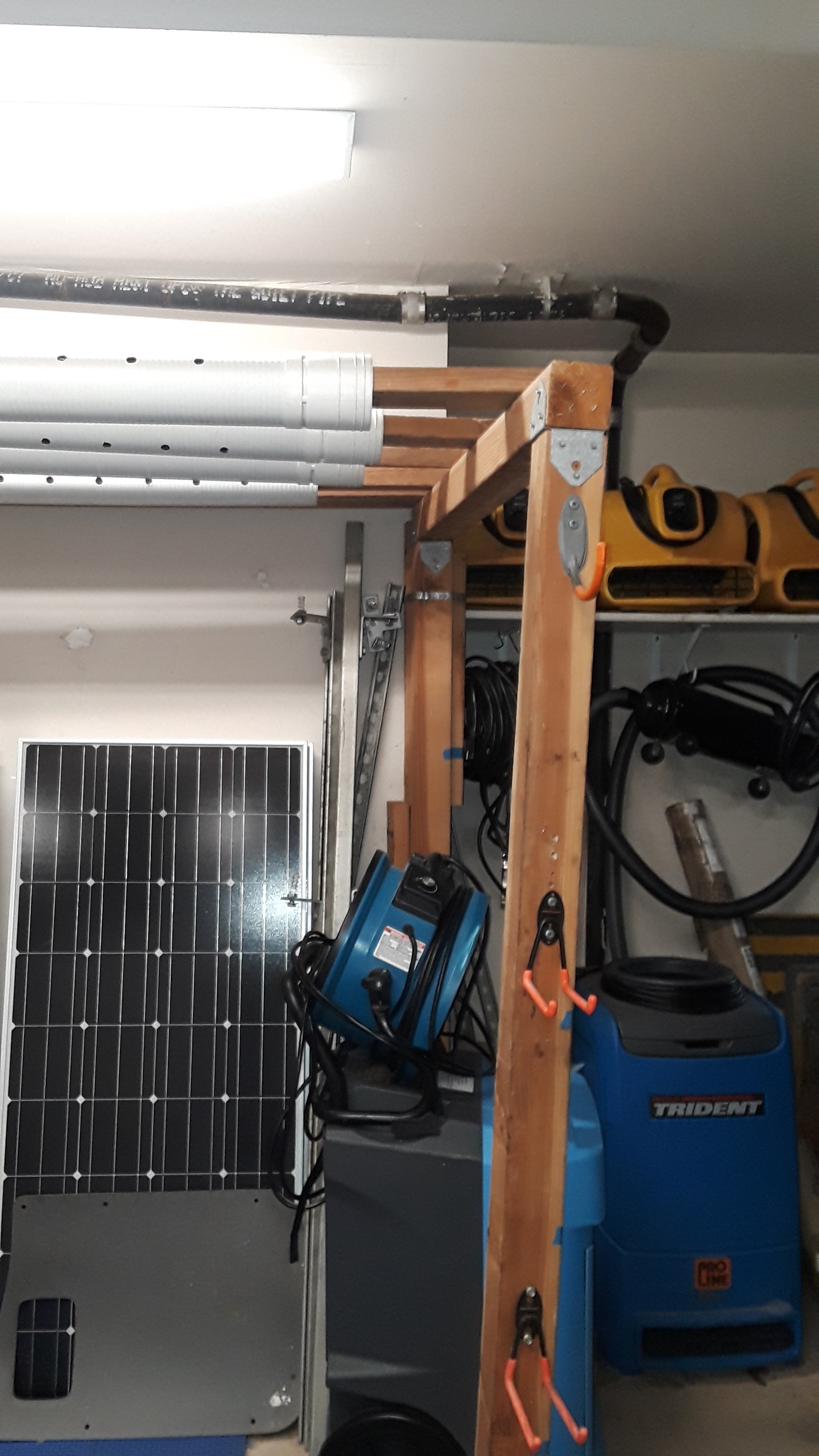

This is where i hang the knoted rugs to dry. Tufted rugs stay on the floor to dry-- so i clean those last.
Rugs are stored under my stairs

Actually its not connected to anything. I have to vac it out and it get pumped into sewer drian.

It can hold a good amount of water. a pressure washer is a very efficient use of water and actually uses very little water while blasting away the soil. Ill vac out the water while prespraying the next rug- so no real down time. The sewer drain is right next to the ETM.
Our country allows the waste water to be drained onto land to help fill ground water and water the plants-- maybe u can do the same. The big square grate simple drained into the ground.
