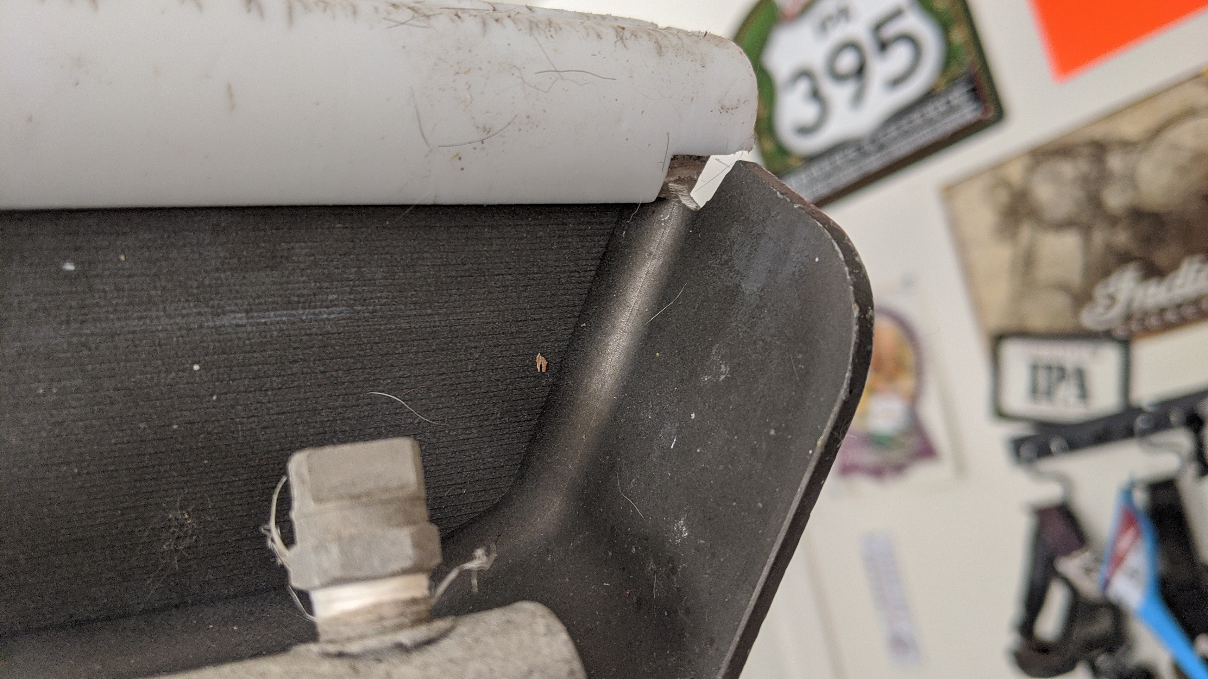

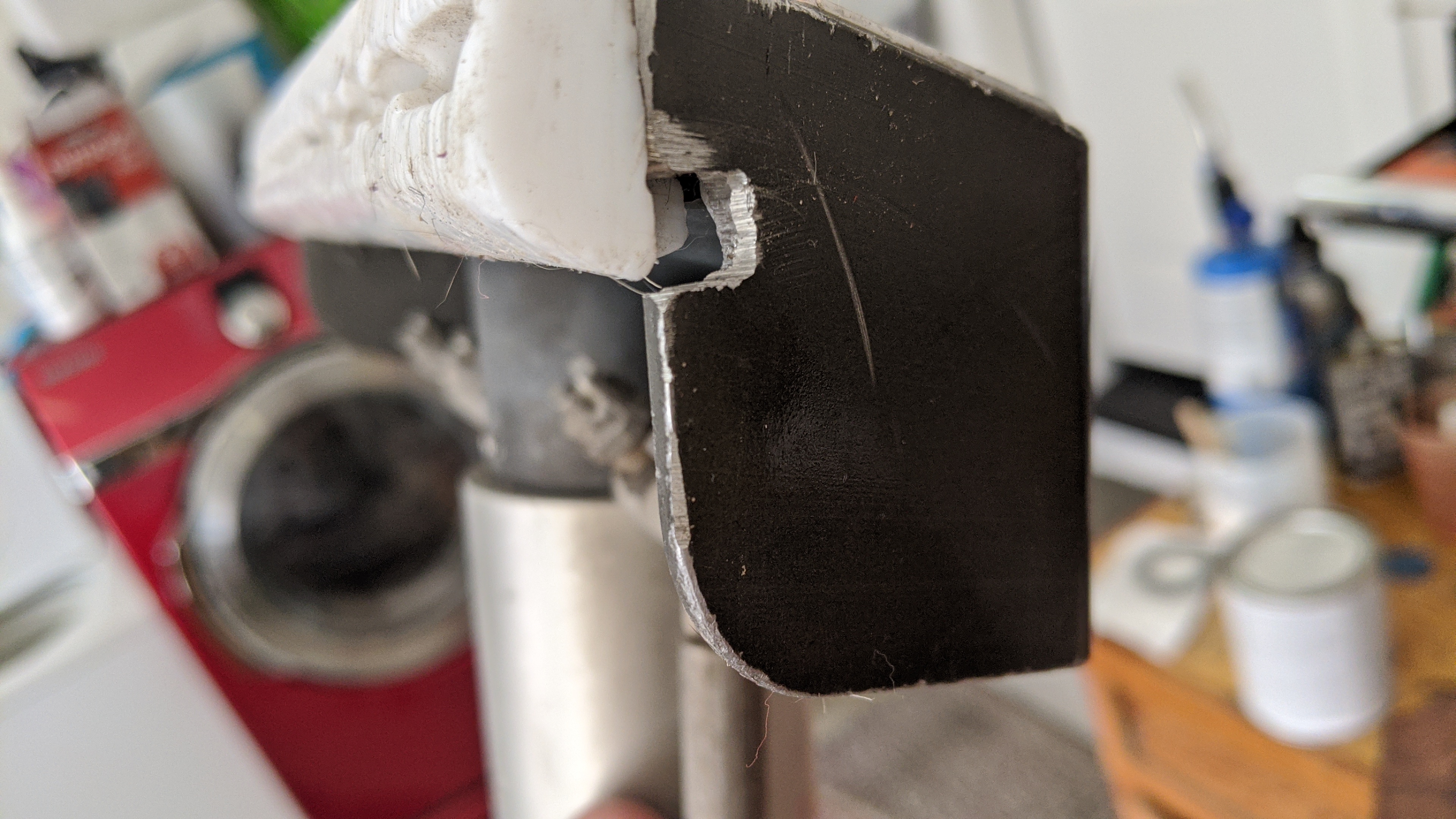

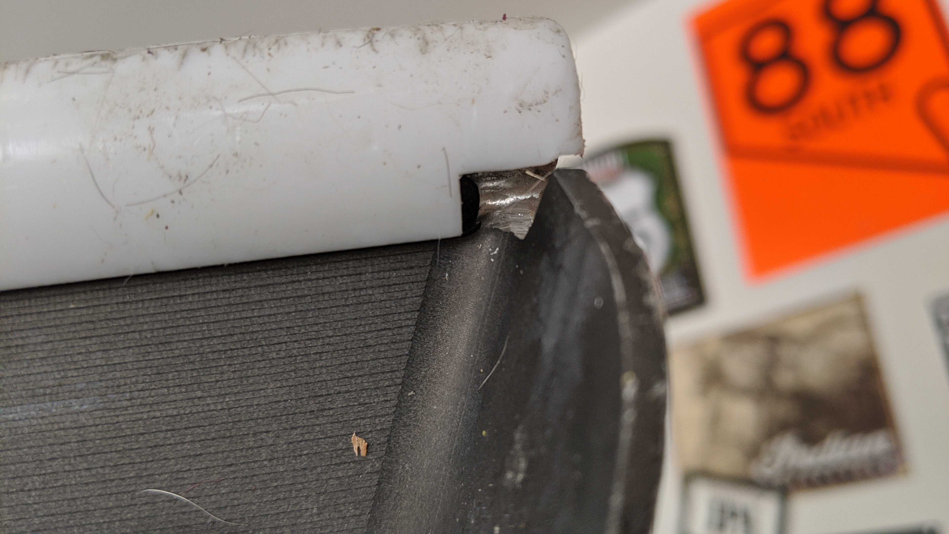

Beta testing begins.... IMG_20200429_145004.jpgIMG_20200429_145020.jpgIMG_20200429_145014.jpg

I notched my PMF 802 12 yrs ago.
You just grab the glide and pull toward notch. You can change or switch in seconds.
Green Glides are built like tanks. Easier to slide than pry.

I am creating a hard surface brush glide that will fit many wands. In order to do so I will start with 5 versions to test.
Each time you take off a glide by heating and prying you significantly reduce it's strength and ability to grab hold.
The notch OBVIOUSLY will make the whole process go smooth, easy and cause no damage to the glides, especially the carpet glide.
If the brush glide works as planned it will make the (select) carpet wand out perform any pos existing hard surface wand on the market.
You can either convert an old wand or notch you one and only to make seal outs quick and easy.
