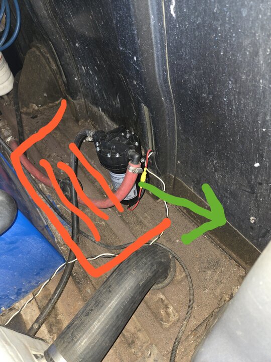

BUT! What if I slap that thing on the floor behind my waste tank? I'd only have to relocate the transfer pump closer to the drivers seat on the other side of the blower exhaust. Seems like this may work really easily. Then I'd have a massive volume of hot water and no need to deal with Pete. What do you think?

Thanks Dwain, but before we go that route... what do you think about me using the Blue Baron heat exchanger in the location I posted pictures of?

I was talking about the heat exchanger from Blue Baron. Maybe you didn't see it posted earlier but I am wondering if I should just go ahead and mount the Blue Baron heat exchanger in the location I described behind my waste tank, I posted pictures of it. Seems like it will be super easy to drop it in and run lines to it. Hadn't thought of it before this morning...

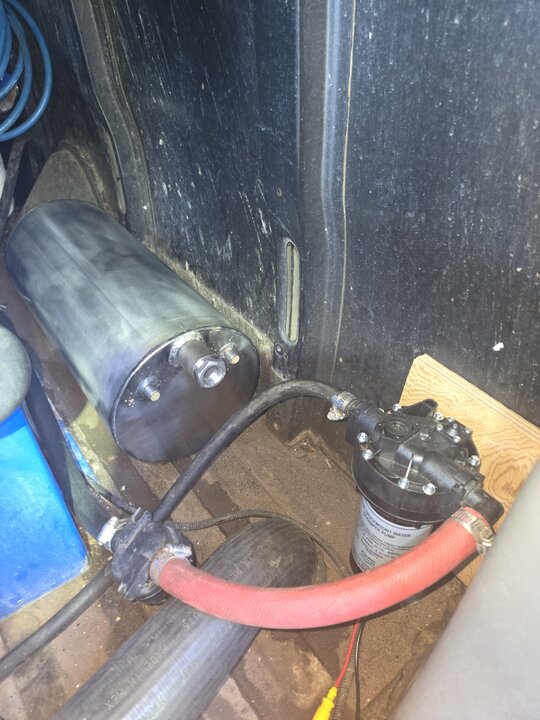

Well I think it fits. And I can plumb coolant lines to and from it easily. How does this look bud? I relocated the transfer pump and it works fine in its new location. I only rested the new HX in place for a pic as I still need to get fittings and insulation and mount it on a board so I can easily bolt it to the floor on the front side.

I really like the new HX and I'd prefer to keep it. I think it will provide serious heat over a tube style too. All things considered I think I am going to go for it with this thing. And as a bonus this will free up more space under the waterbox to organize lines and have room to work on things whenever I finally take the old HX out and plug the holes in the recovery tank. Family is visiting but i'll be doing a bunch of work on it soon.

It's behind the driver's seat. I had the seat out to move things and take a pic. Thank you Dwain. You've got a big heart thanks so much for offering to loan me the tube style HX. I am going to go for it with this one from Pete. In principle it seems like it will work fine. I'll install a bleeder valve on the high end and see if I can order a good Y fitting. I'll let you know how it turns out! 😁
