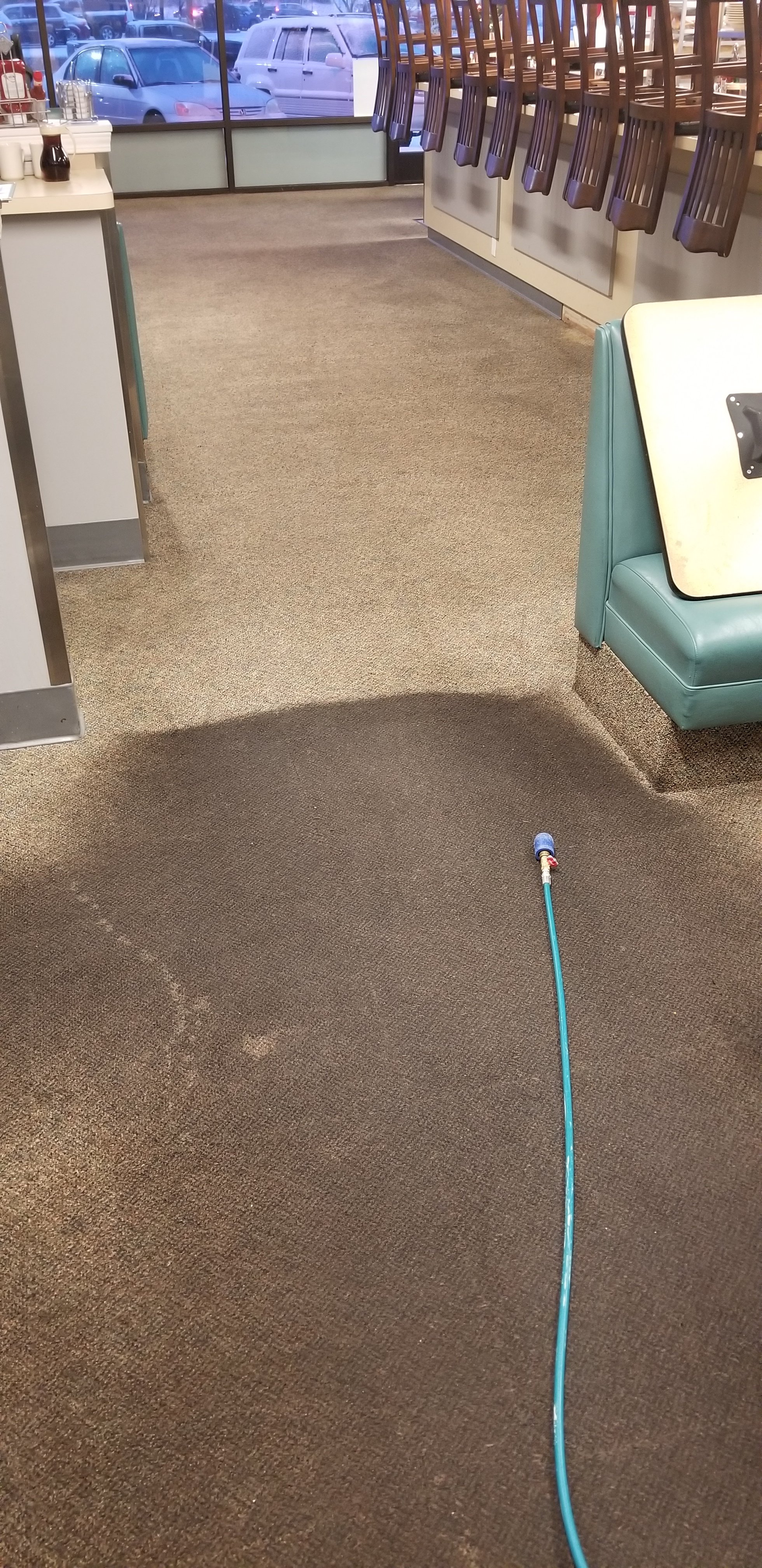

My worse shit pit restaurant is on for Tuesday afternoon.
You've seen the videos.
I've used the following methods in search of the quickest method..
175/Red Pad and wand rinse
Cimex pre scrub and wand rinse
Cimex and 175 post pad ...dont shoot me, it took the longest but stayed looking best longest as well..
175/Red and 13" Zipper rinse
175/Red and Wand rinse
360iBH and wand trim

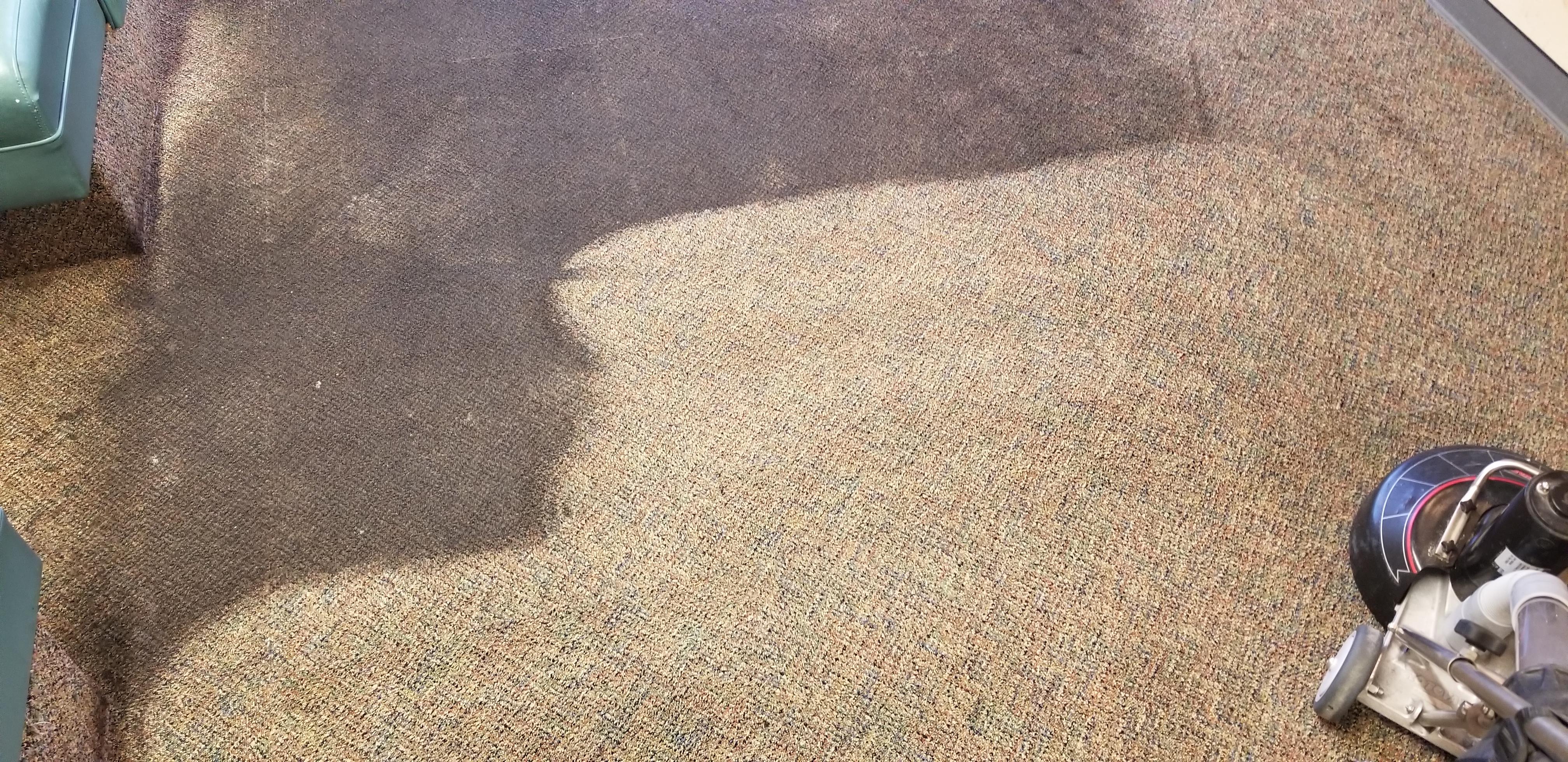

I'm just a new guy on the thread but the quickest way in my opinion would be to use your favorite grease eater prespray (I like Bio-Break or Flex w/Citrus solve) and use an emulsifier rinse. End Zone by Bridge Point is an emulsifier, acid rinse, and encapsulation all in one.
No need to scrub unless you have some kitchen entries that get major buildup.
If you run the 360i with brush and emulsifier rinse, then it should go pretty quick. Wand out the common areas.
Most guys forget about the emulsifier rinse for restaurants. Does wonders for time.
