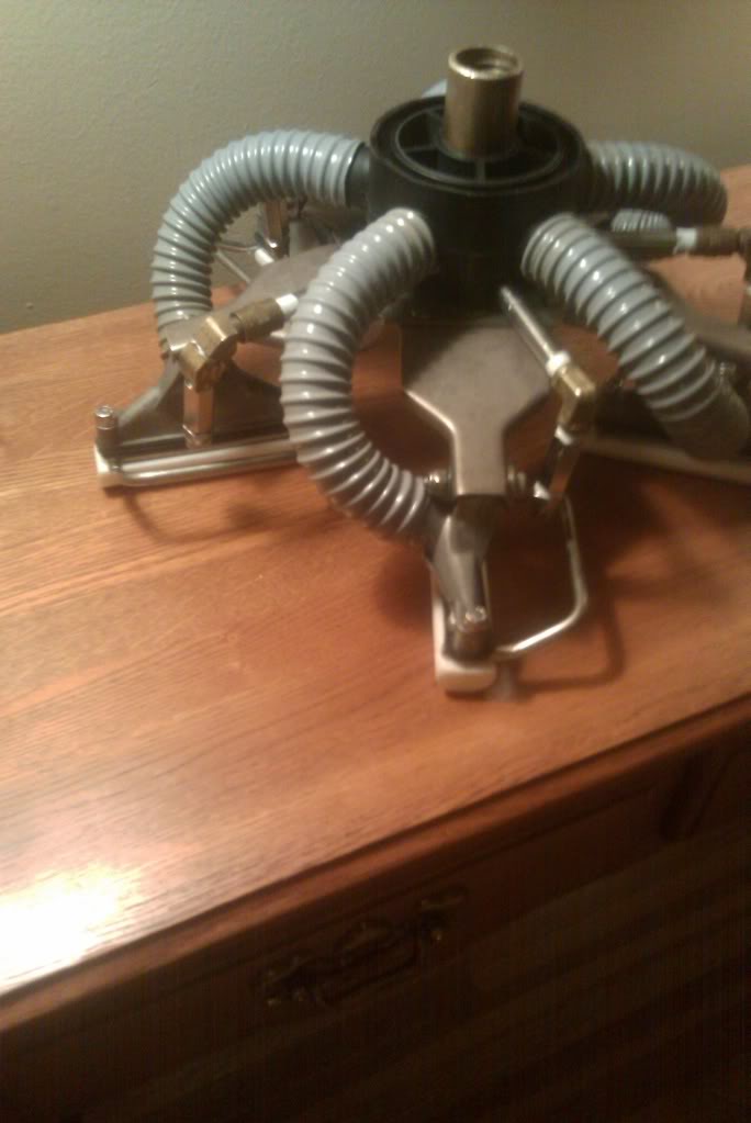

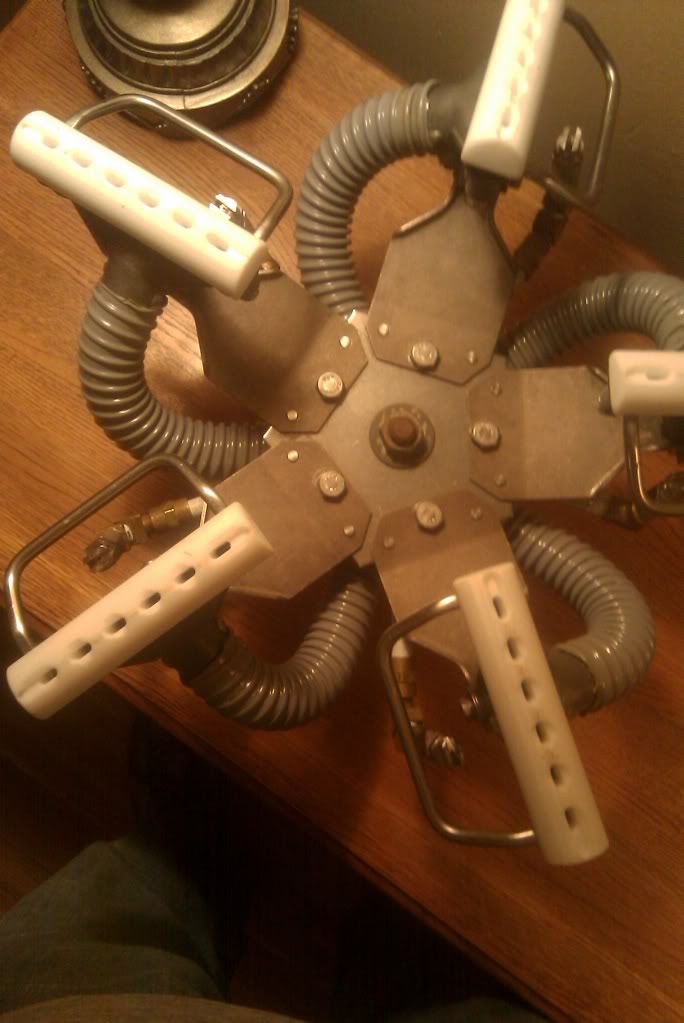

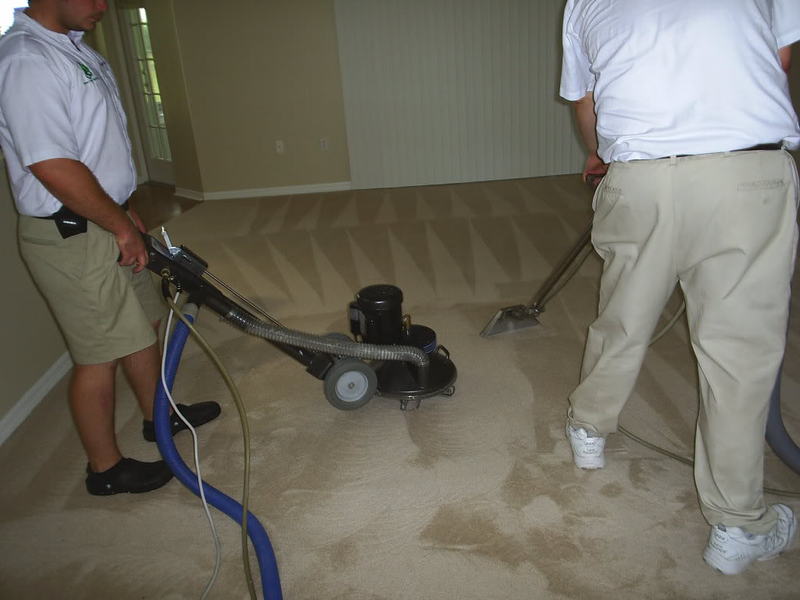

Jim Martin. Check out my modifications. Thanks for the help

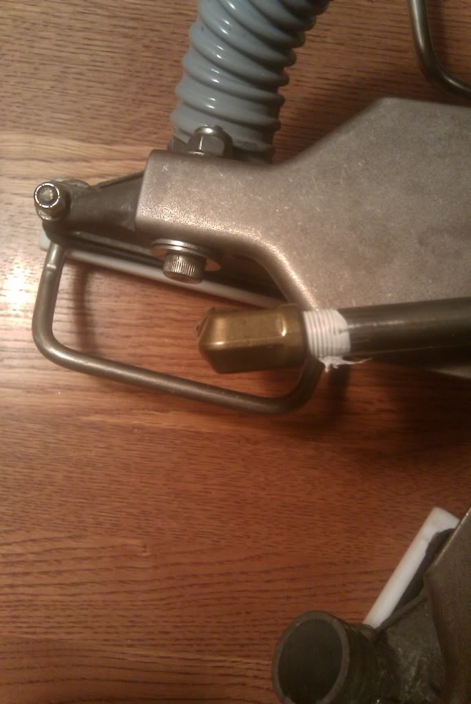

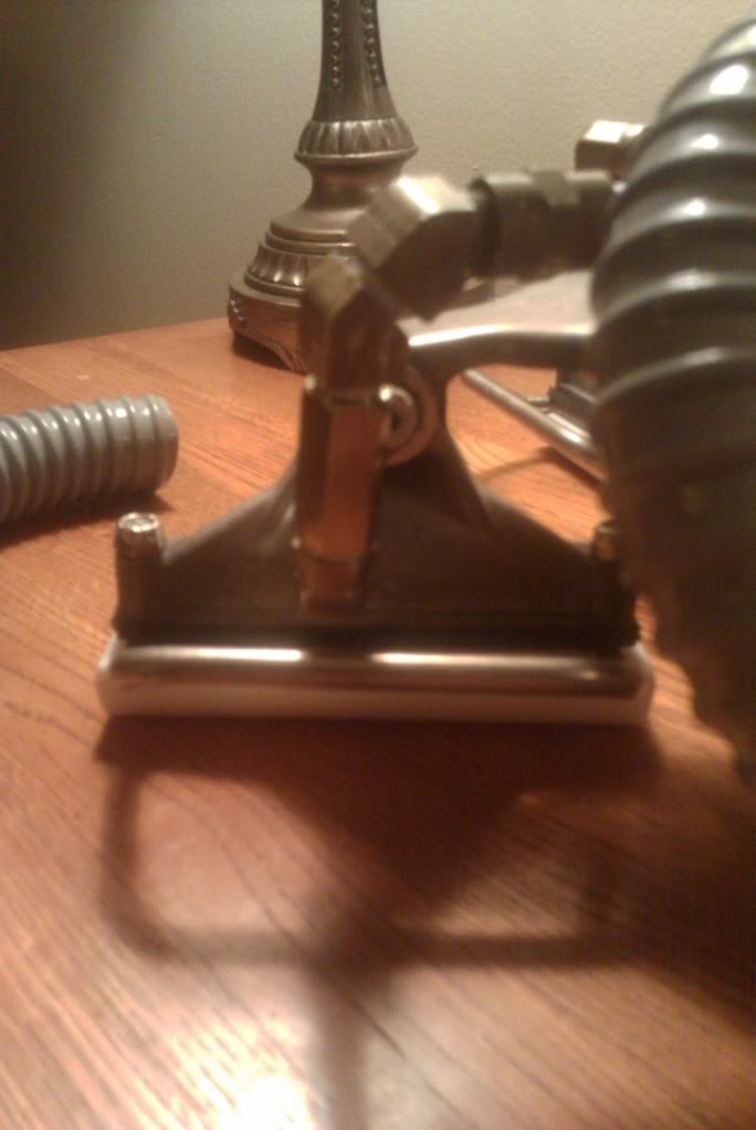

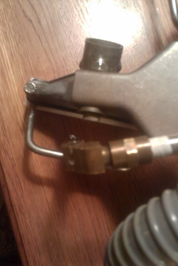

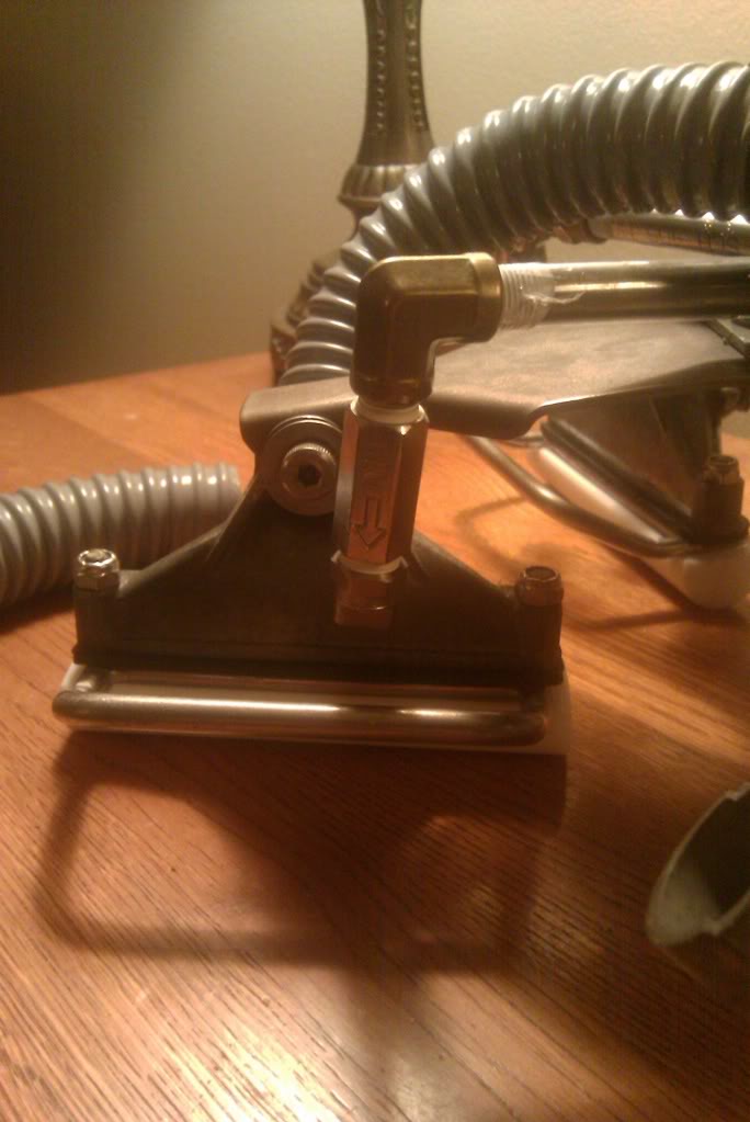

I noticed in your pictures you used 90 degree elbows. Your elbows looked a little larger than the ones I ordered. I noticed that the jet was more towards the inside of the glide. I could see that being a problem trying to get close to a wall etc. I took the connector that was between the 45's and made a 90 and used a connector off the 4 inch nipple. The jet sits more to the outer edge of the glide. Ideally I would like it in the center but I didn't have the parts. I used two 90 degree elbows so the jet would be closer to the inside of the glide and three set up closer to the outside of the glide. This should give more even coverage and clean faster imo. I am going to give it a whirl tomorrow. If you look in the photos you can see how the jet is lined up farther or past the nut with the two 45's and in more with the 90 degree elbow.

I see what you are try to do and it is a good idea but.....if you can put the jets in the center of the glides you are going to get better performance for your dry times...with the jets off set to the inside of the shoe/skid.....your jet fan pattern is going to shoot more toward the inside of the star and be a very uneven pattern.... you are either going to have to make some real good dry passes or you are going to have wet areas all over the carpet....the 80015 jets fan out just past each side of the glide .....the way mine is set up...I can get the carpets clean up to about a 1/4 inch off the wall with very little over spray...aside for the jet extenders... this set up is pretty much how it comes on the older style RX star...I can see your idea maybe working better with out the extenders on the jets so the fan pattern is spraying further out....but you are still going to have to pick up the over spray with more dry passes....
I would put them in the center and just tip them enough to spray a even pattern right at the front of the glide....
Try your idea and let me know...I could be off base with this...but by looking at it this is what I am seeing may happen...

Reall? You think it will overspray. I will try it and if it doesn't work what would you recommend to get it centered? Can I get a bigger elbow or a small extension? I really want it centered but couldn't figure out how to acheive that. If I went with the elbows I have now the spray would be contained more to the inside and any overspray in the inside would be picked up by one of the 5 vac slots. If it oversprays to the outside, then yes I would have to dry stroke which I don't want to do. I guess I will have to run it. Anyways it should clean A LOT better than it did with half slots and three cone jets.

the 1/8 inch pipe on mine is 4 inches long and the elbow you should be able to get at any hardware store....and it should put the jet damn near center...
