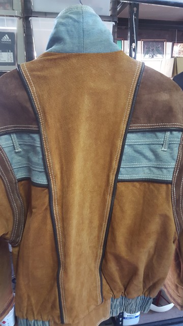

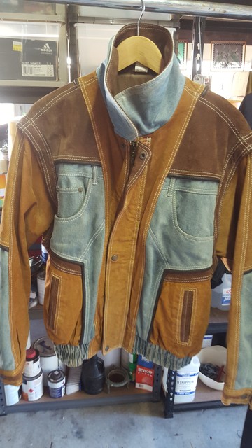

Thanks Jim, I should have taken before pics of this one.
Here's what I have done prior to posting the pics.:
Inside lining where most of the odor was, sprayed with Sprocidin, then steamed.
Denim, lightly sprayed with an encap; spotted, brushed, then steamed.
I did use a Nubuck/Suede cleaner, followed up when dry with a nourisher that also contains a UV inhibitor & water resistant compound.
Sprayed interior with a leather scent.
There is now (two days later), no foul body odor.
Suede is looking good, although ever slightly darker, which I explained to the owner prior to accepting it.
Denim also is looking good, apart from the elasticized waist band where there is a lot of wear & color loss.
Waiting for the owner to come & pick it up.

Well heck...you didn't need any help at all...nicely done.
Reactions: Shorty
12,769
So those are after photos, correct?
Very superheroish...I like it

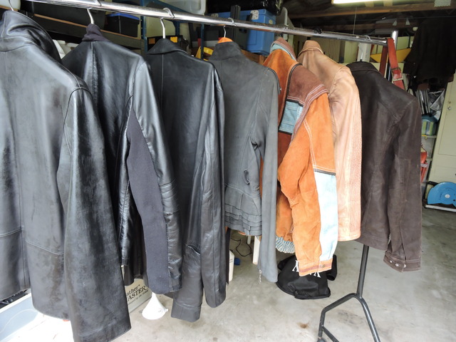

Here's some of this weeks work in between my normal routine.
Among them are unfinished with a tear.
Finished with fabric elasticized arms & front fabric panel.
Finished.
Suede with flounces.
Suede & Denim.
Finished with strange rubberized/elasticized panels & arms pieces.
Oil finish, or oil pull-up if you prefer.
Handbag. (NOT mine).
