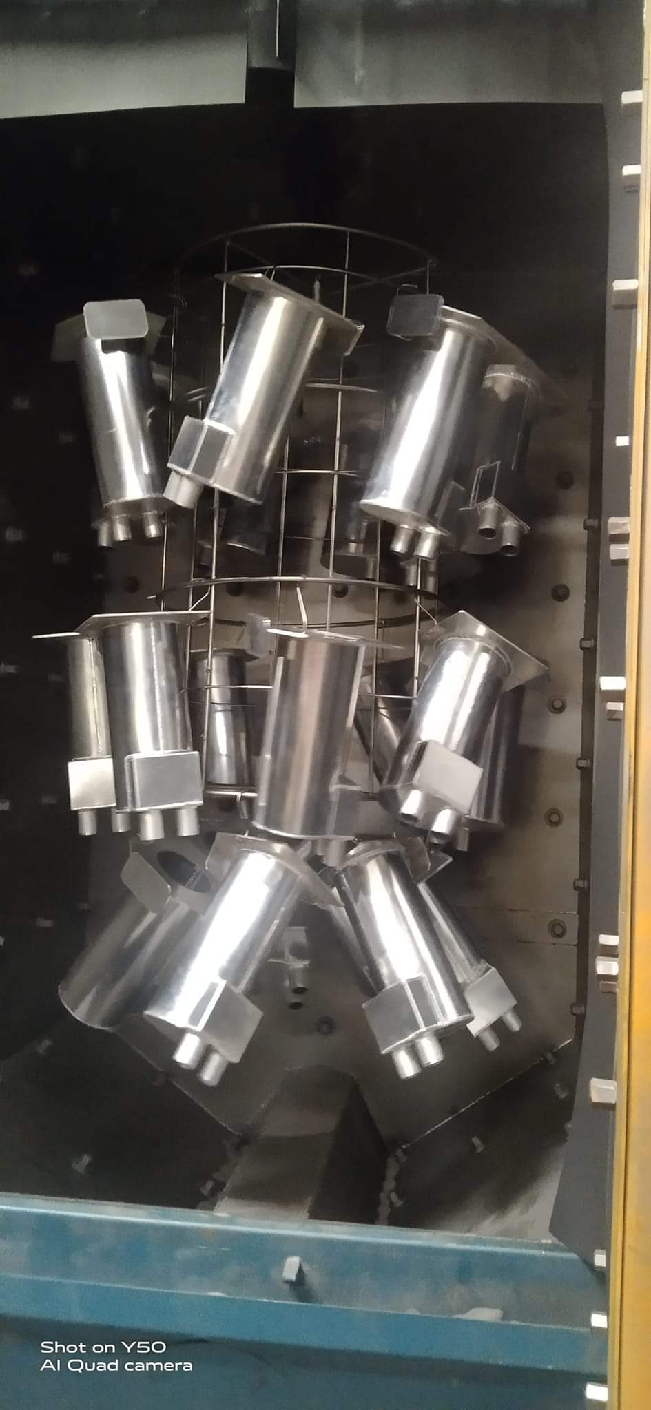

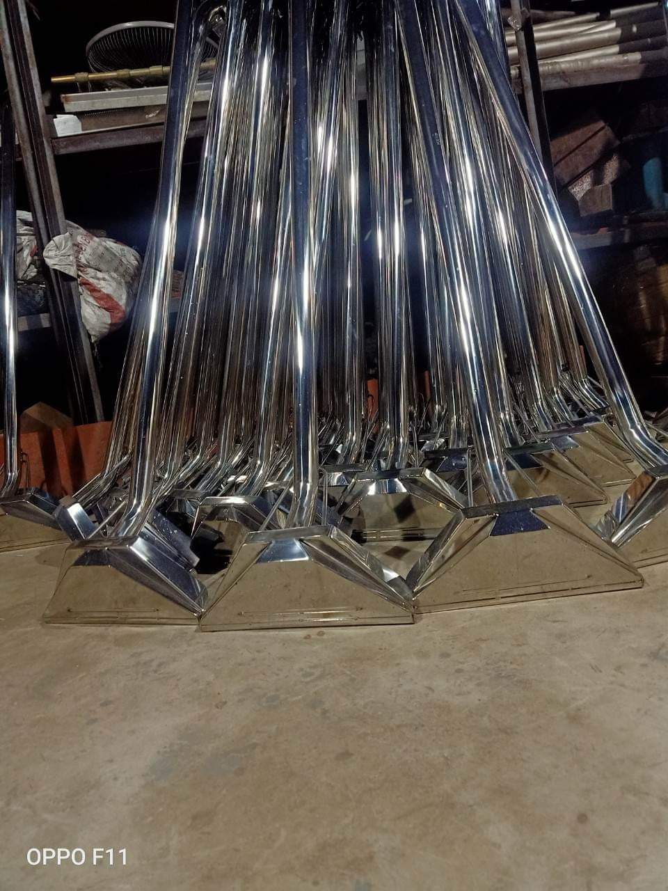

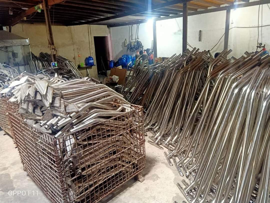

I got to move some inventory.. FB_IMG_1679704371092.jpgFB_IMG_1679704365428.jpgFB_IMG_1679704352115.jpgFB_IMG_1679704338936.jpg

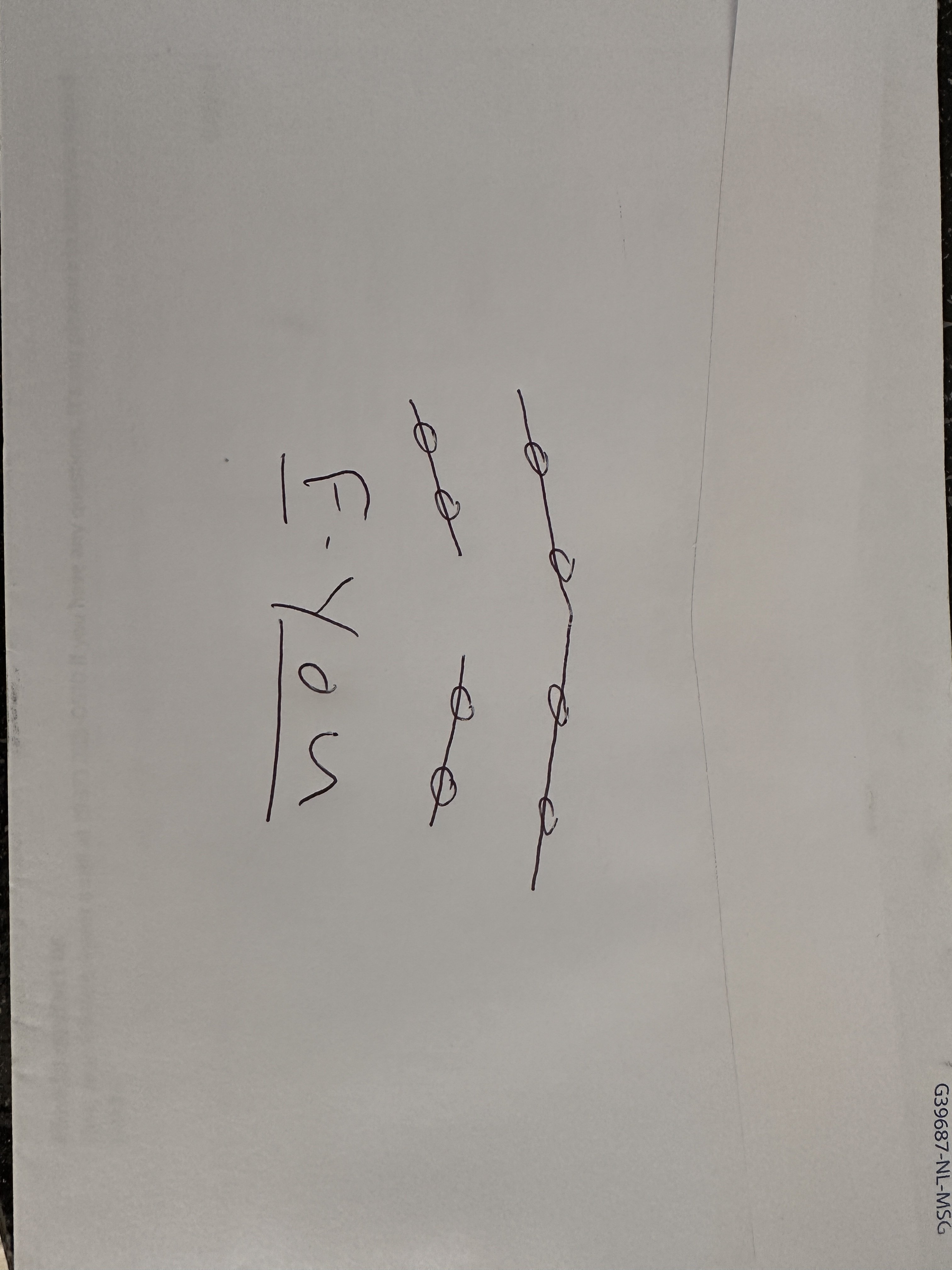

How about an offset 4 jet manifold, so the jets don’t have to be angled? Maybe a v-shaped manifold. With 2 manifolds, angle them a bit.
