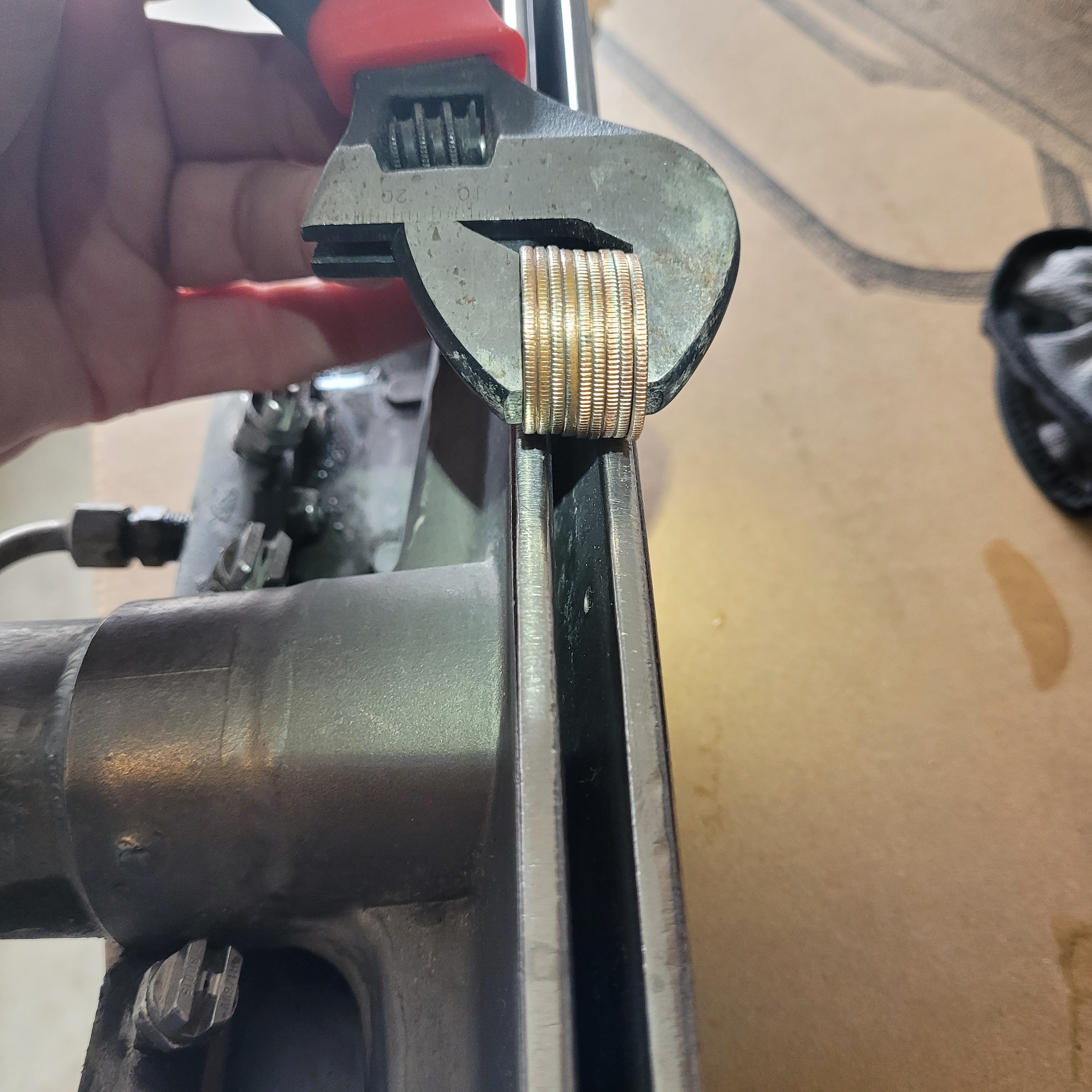

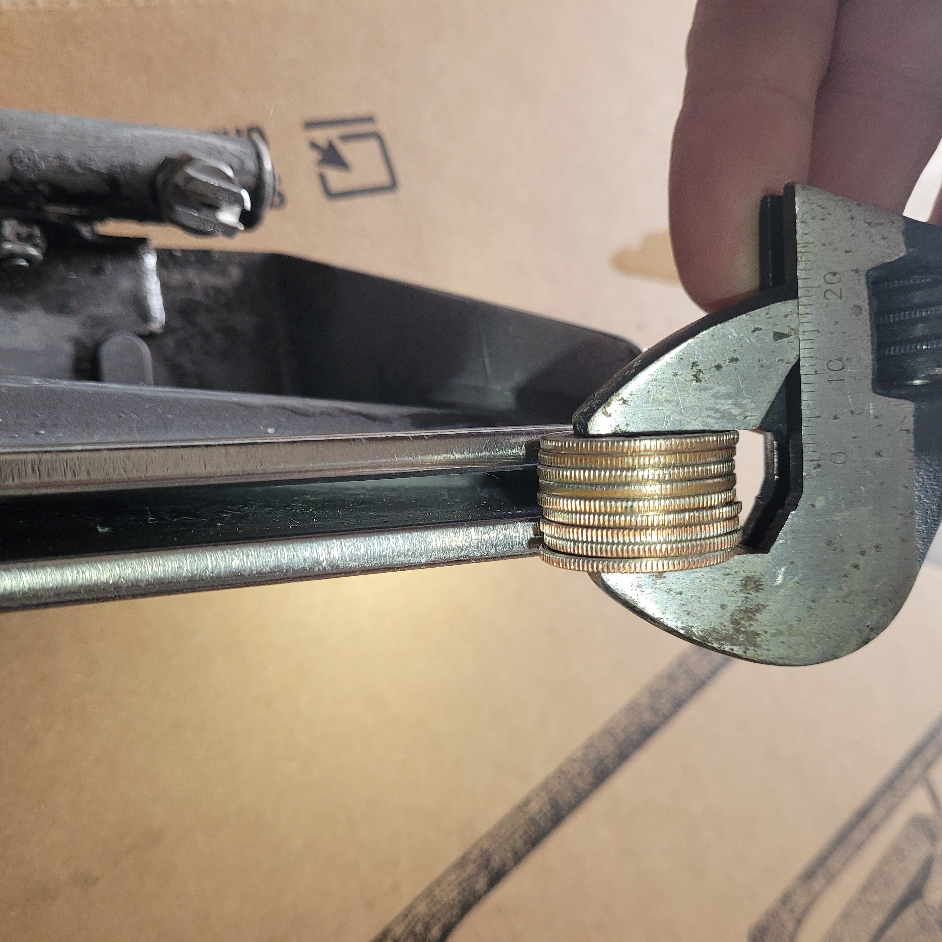

Most likely, it was a worn out round Glide.
To my knowledge, there has never been a flat option for the PCTI
I've saved this relic( the glide); I'll dig it out and snap a pick. I went on the Green glides website and checked your videos.
I figured that nine quarters measure precisely 15 mm. My slot( outside to outside ) measures 17.5 mm, except in the center, where the mouth is slightly wider, 17.7 mm.
I'm ready to order one regardless of the outcome.
Should I return to the website and order one for a 13.5-inch wand? Mine is a six-jet.
Thanks

If it actually wiggles you need the undersized option.
Because its a sand casted head the shaped of the lips vary tremendously, hence the slight gaps.
Sealing it will worsen your dry times, lets it leak, it aides in lift.
Sharpshooter Glide - https://greenglides.com/product/sharpshooter-13-glide/
