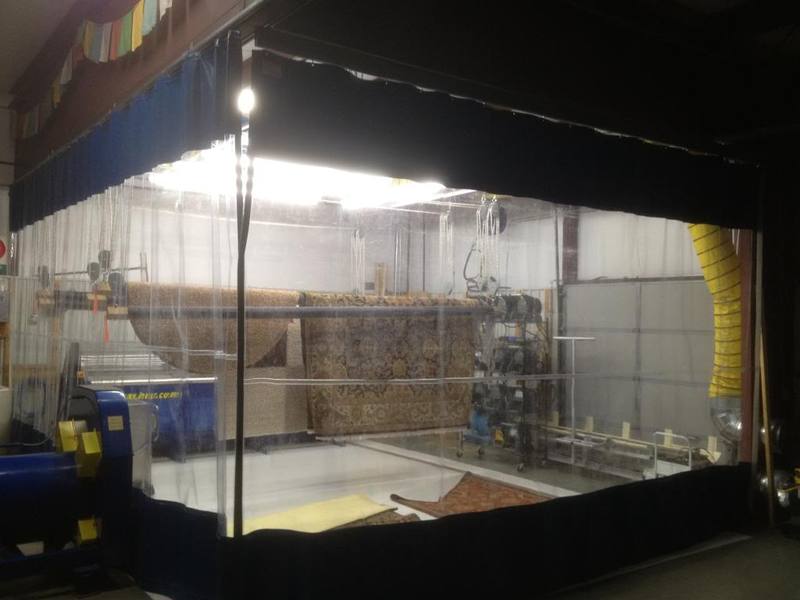

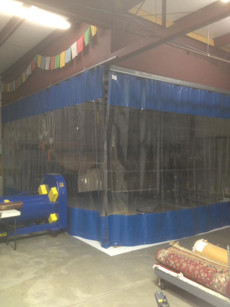

It's fascinating what some guys have come up with to make effective dry rooms for their rug hanging systems. Robert Pettyjohn's rug washing facility displays a great use of space and time. Lots of companies use free standing drying towers like we make, or others as seen here. Yet, instead of dehumidifying the whole shop, Mr. Pettyjohn's water damage drying experience led him to make containment curtains as featured in these pictures. He dries in hours with pumping heat in. High heat makes for a healthy rug too!

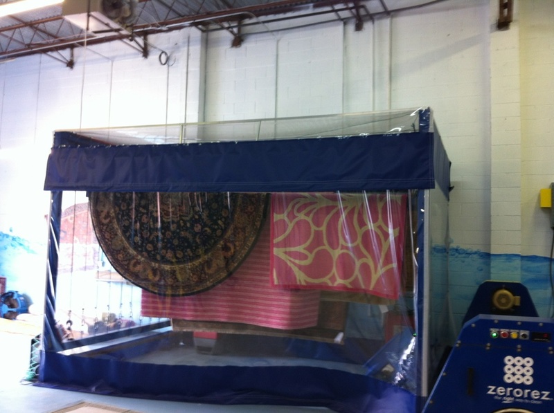

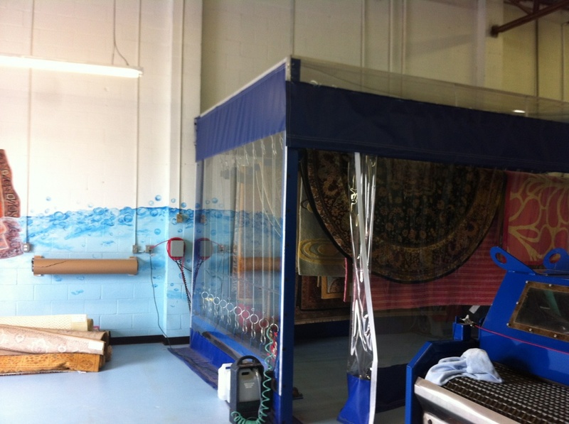

Here is the same concept from Zerorez in Atlanta:
I was actually thinking of the same idea using 20x100 6 mil plastic w/ heat drying and or LGR Dehu's, I can see the material they've found is more durable and heavier as well.
More info on the plastic material they are using and where to purchase it from?

At Rug Summit 6 we talked about this drying system. In my opinion a most profound explanatory statement was made by Charlie Cressy concerning the drying of textiles. The question was poised: When was the last time you took your clothes out of the washing machine and tried to dry them with fans and dehumidifiers? You don't! You put them in a clothes dryer and predictably dry them every time in 30-45 minutes. The principle is simple: Heat dry rugs and exhaust the wet air out. Its efficient and quick and predictable not matter what the outside weather condition proves to be. (Plastic curtains are found everywhere)
