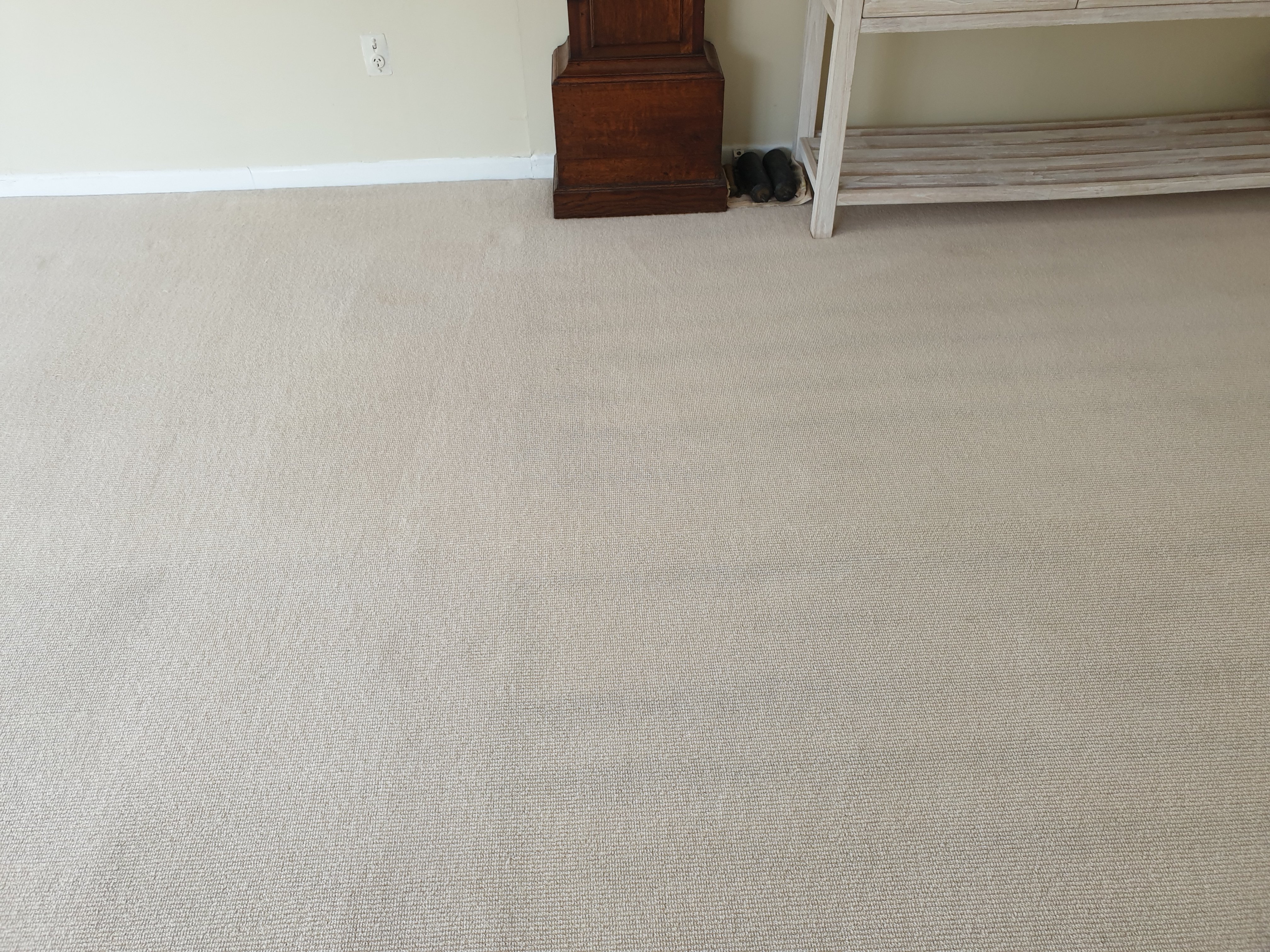

This is a regular custy, probably done it 5 or 6 times now
the front half of her lounge is an add on with particle board layed down under carpet (left side of pic) the original floor boards can be seen clearly on the right.. offwhite wool was a bad choice, always annoys me doing this place 😔

the 1st time cleaning my original pic place, mixed up extra strong boosted prespray, hand agitated the lines with microfibre rinsed and dry stroked it to death and it looked great.. but 8 months later da-da we're back! I think it annoys me more than the owner

Filtration lines will always come back unless you seal the gap under the wall. Sometimes more aggressive cleaning leaves more residue causing them to get worse.
