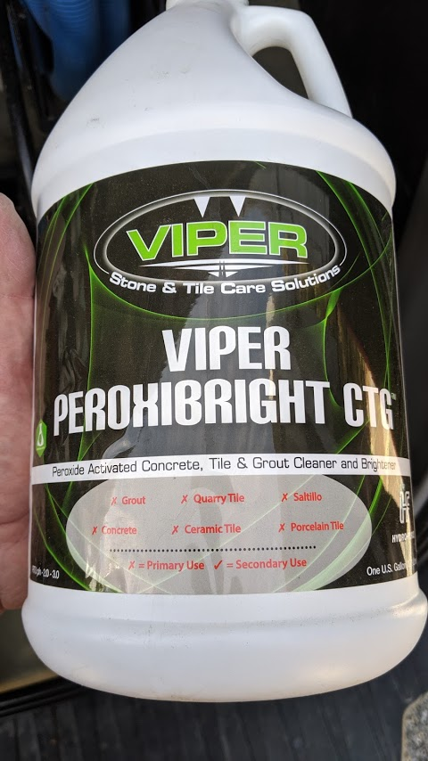

Ironically this stuff sprung a leak in MY garage yesterday morning, I forgot I even had it....
Perfect timing.
