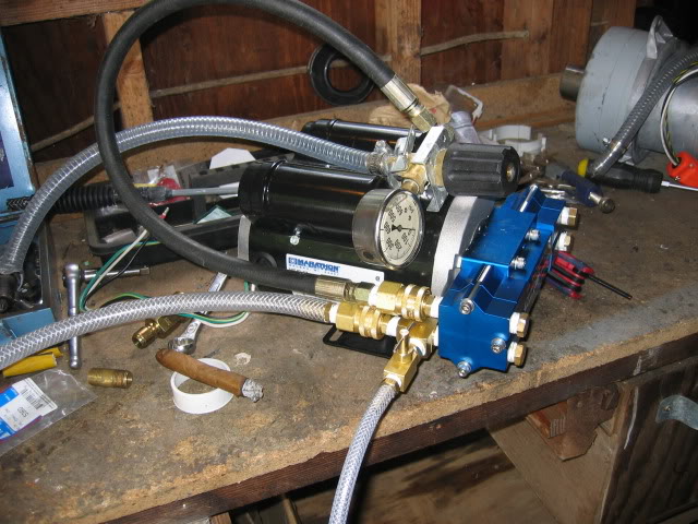

B
Bjorn
R
rotovacguy
Nate The Great said:
Odin said:
Looks freaking complicated! :lol:
That's what I was thinking, plus you're still passing the emulsifier, or whatever else you plan to add, through the pump. Running an inline avoids that, saves your pump.
B
Bjorn
ah bull shit a little dry slurry thorugh the pump is not going to hurt a darn thing
