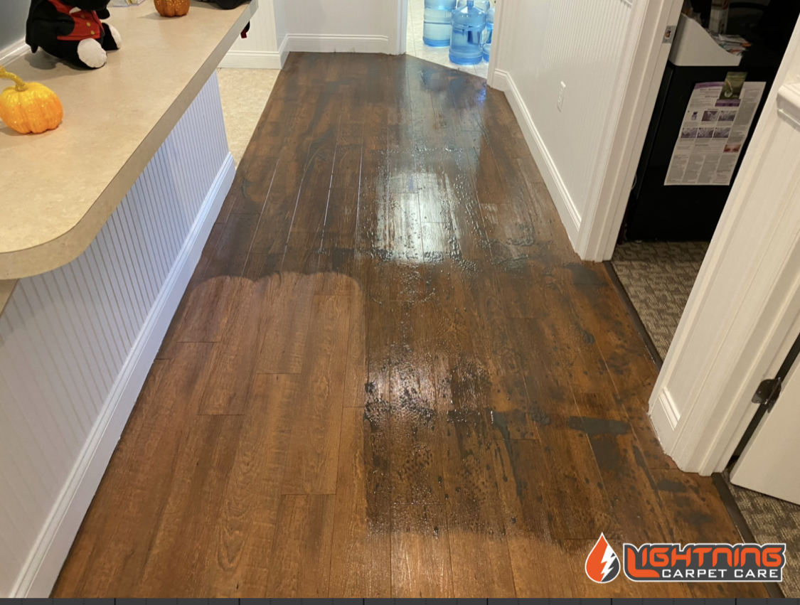

The cleaning took place in a dermatologist’s office. The flooring had 8+ years of dirt.
117,006
You said it's plank but are you sure it's not sheet??
If there's any gaps or shrinkage in the planks at all be very leery and care for running a turbo spinner at 700 plus PSI especially on the newer products that have bonded cushions underneath as they can swell if they get too much water
Try and run a 400 psi floor wand as often as possible

More than likely sheet planks. They did not have a spare. No gaps that I’ve noticed from the inspection. I tested, tested, and tested again. Before putting anything down.
I ran it at 225-250 psi to rinse it. I was going to use a wand. But it would have splattered all over the newly painted walls.
117,006
At 225 psi your turbo was not spinning but spray alone obviously worked...

I didn’t have a gecko wand. Although I should buy one.
14,475
..hold off.....
I'll be the first to buy whatever you come out with. Hurry up! I used my WP tile wand all day yesterday and I'm burned out trying to pivot it in places that really need a good tile wand

Last time I used a gecko, that thing made me feel like I had to replace my shoulder. The vacuum stuck to the floor and was a pain to pull.
