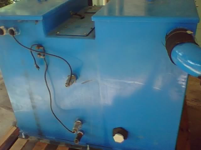

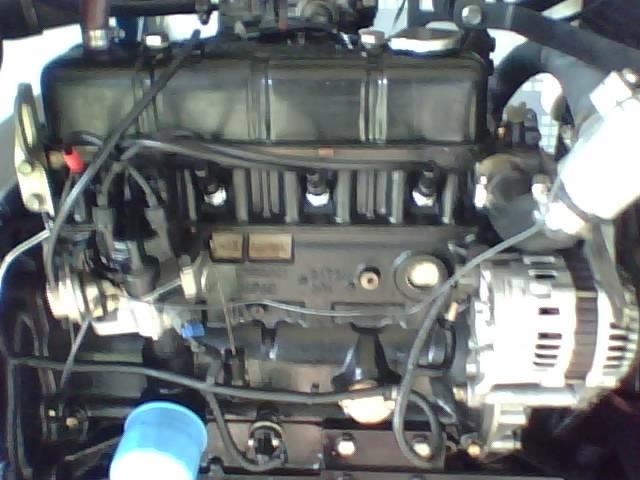

I just got our 805 back installed and running in a box.
I have some racks being made for drying equipment.
It's a 5th WDR truck, we don't really need it but it was in the garage just sitting there so I bought a used truck and had it installed.
It will primarily be used for big losses, or long hose runs, the ability to run three wands could come in handy.
Heat?
I just want it to suck.
I think we were getting around 200-220, it was screaming before that and they flew out a Prochem mechanic who worked with our distributor and they spent a day doing some retro changes on the machine to control the temp.
