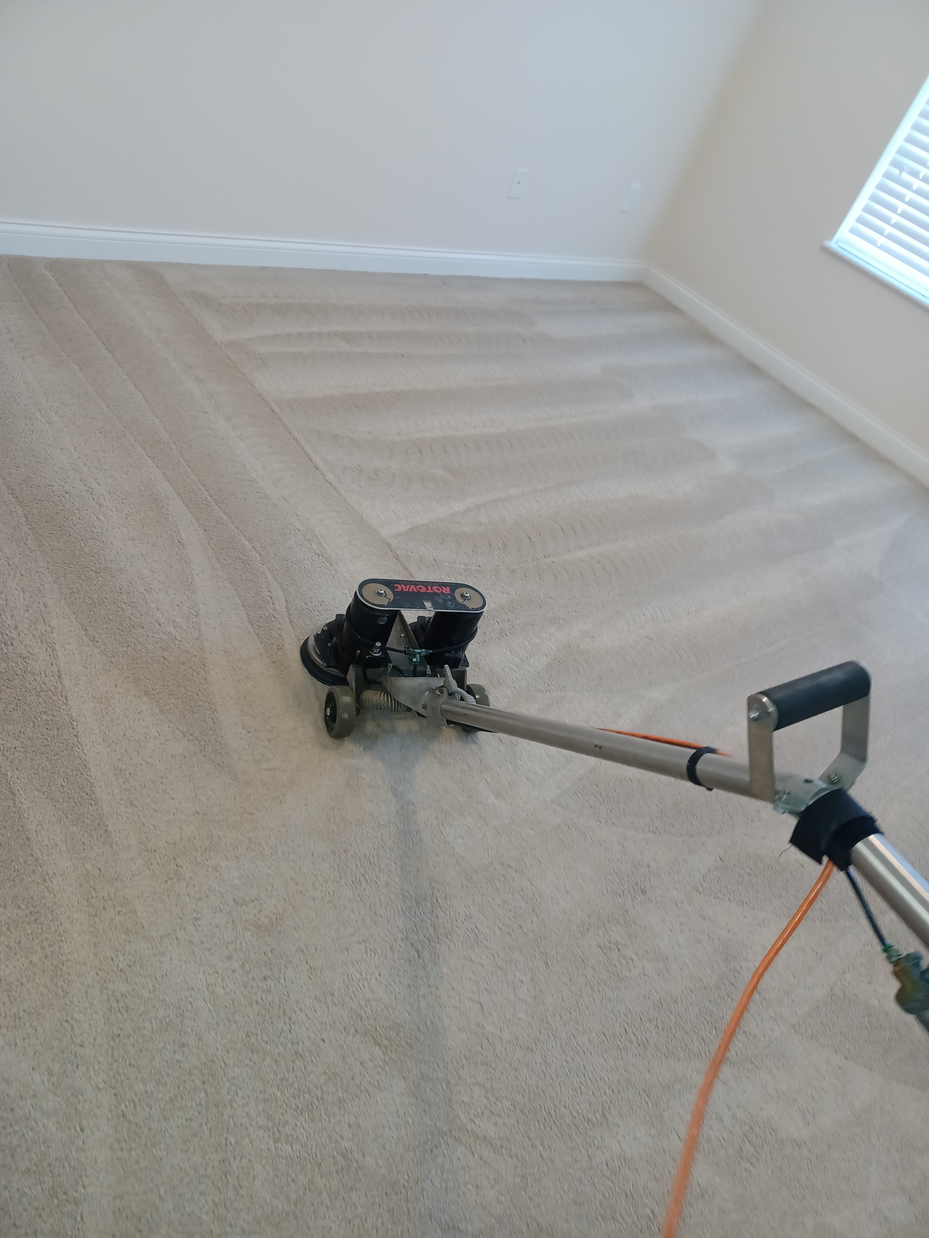

Vlm by definition means under 3 hour dry times.
This things pretty much guarantee 36 hours of suffering.
Noope!@@ I use less h2o. Who says you need to hold the trigger. Jeesh!!!!:stir:
Let the agitation do it's thing!
Low moisture on thick cut pile!!
Wheels turning?, light bulb moment?

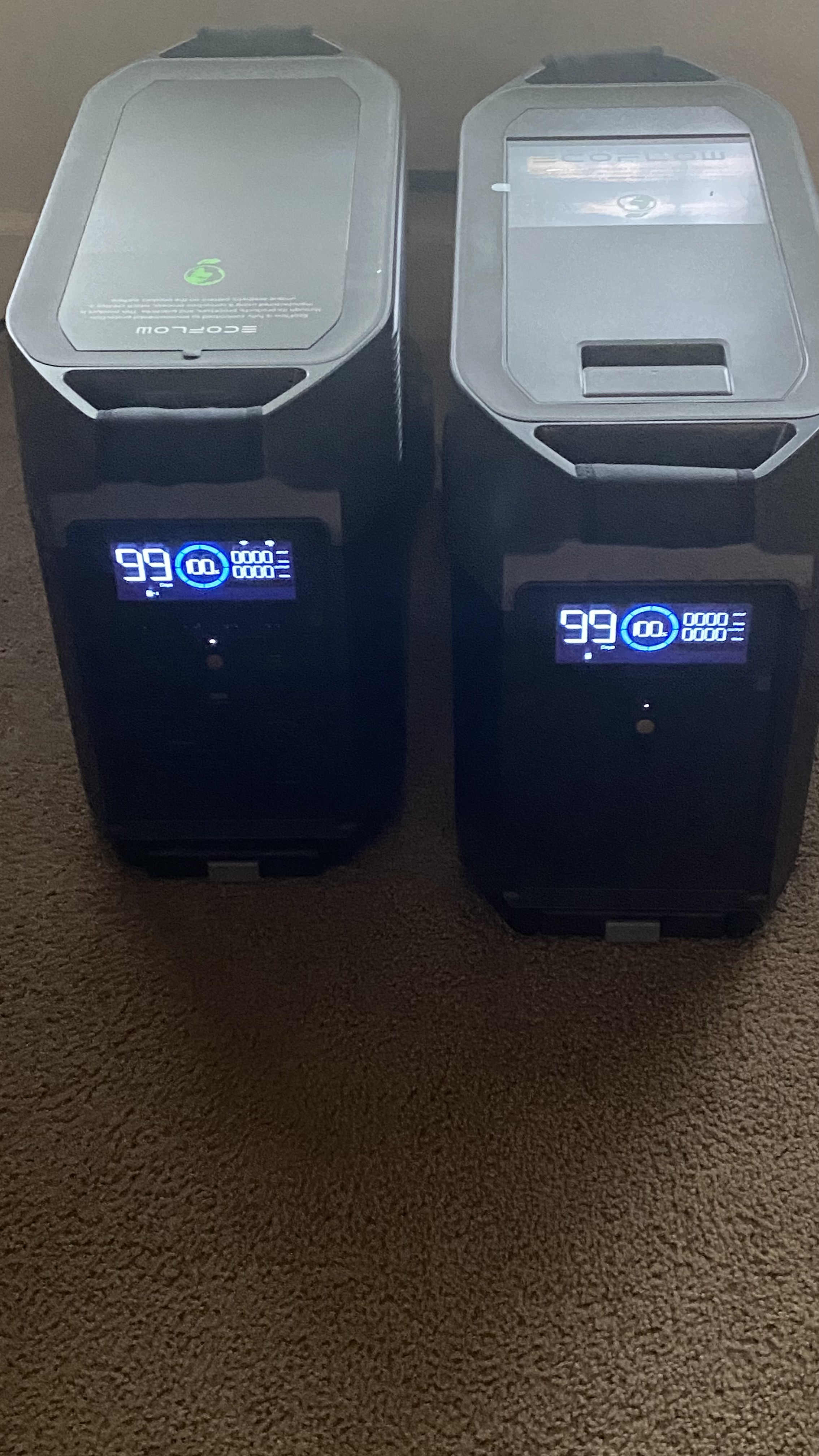

So, if you used one of these power units, how long could you run a Pad Machine on one charge? It could be a viable option in situations where power has been shut off.
I have something like 7.6kwh with that unit so probably all day if needed. Maybe more.
I might have this f'd up, but if you were using something like a Phoenix that draws 5.5 amps and 660 watts an hour. You would get approximately 37 minutes from a Yeti Goal Zero 400.

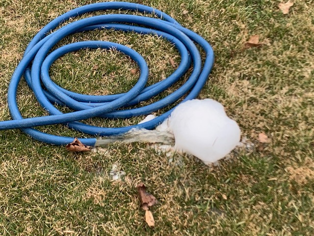

VLM removes soil as do all carpet cleaning methods. What I do need convincing on is what they leave behind.
The way I clean with HWE is very similar to washing your clothes. Wash cycle/Agitation/rinse cycle. Apply cleaning agent, CRB, rinse with water and groom. With the CRB doing most of the work, I can reduce the amount of cleaning agent and water pressure.
So when I clean for a repeat customer. At any point, I can remove the hose cuff off my wand and I will see just water inside the hose, extremely little or no white (cleaning agent).
Today I cleaned for a past customer that I used to clean annually. Last year she tried a VLM cleaner. She said it looked good at first but then kinda *dulled out*. When I started cleaning I noticed a slight reduction of suction, so I take off my cuff and see lots of white (cleaning agent) so much so in fact that from that point on I just presprayed water because there was enough cleaning agent in the carpet from the VLM that I just needed to activate it.
Pictures say a thousand words. Again, all I presprayed was plain, softened water.
