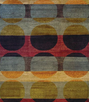

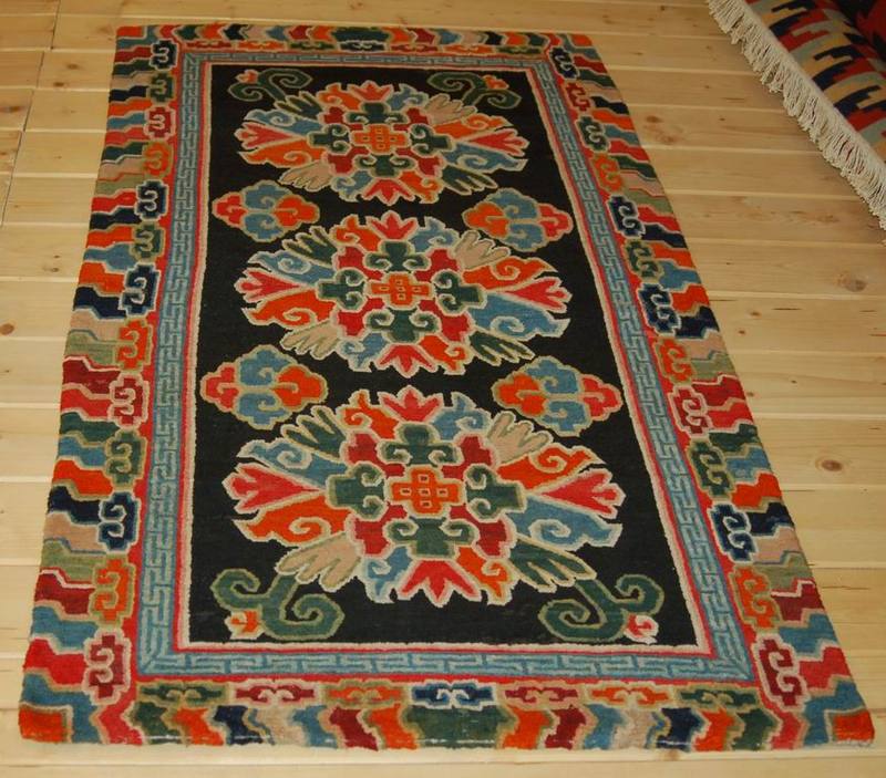

This job is done, most soils come off and the grease spots as well, costumer is happy with the results.
thanks guys again
Is that an alarm clock?
